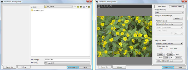

5.1. One Scene Development
This is a method for designating a way to save development processing and development results for selected single scenes.
When you click the ./img/ico_genzou.jpg icon on the "Development" sub-control or the toolbar, the "Save as" dialog is displayed.
You can specify the filename to save the developed image, and specify settings for saving.
You can switch between "Save file" and "Settings" pages in the "1 scene development" dialog.
When the "Save file" tab is selected, you can designate the file folder, file name and type of file for saving the development results.
When the "Settings" tab is selected, you can make settings for 1 scene development while looking at the preview display of the development results.
After confirming instructions for saving files and development settings, click on the "Develop" button and begin processing.
(1) Saved files Switch to the page for designating files to be saved.
You can designate the file folder, file name and type of file for saving the development results.
(2) Settings Switch to the page for making settings for 1 scene development.
You can make settings for 1 scene development while looking at the preview display of the development results.
(3) Development Confirm set development instructions and begin real time development processing.
The status of processing is displayed on a progress bar until development processing is complete.
5.1.1. Saving Files
This page is for designating files to be saved.
Select a location (= folder) for saving files and designate a file name for the file to be saved.
Select the type of file, either a JPEG image (*.jpg) or TIFF image (*.tif). Please make detailed settings related to JPEG / TIFF images on the "Settings" page.
5.1.2. Settings
This page is for making settings for 1 scene development while looking at the preview display of saved results.
Settings here include many that have an influence on the developed image itself and on the quality of the image. Confirm appropriate development instructions while checking the effects and influence on the preview display.
5.1.2.1. Basic Settings
(1) Image Size to Save
Set the pixel size of the image to be saved. There are two ways to make designations, as follows.
a) Designate random pixel size
When executing 1-scene development, you can specify the image size to save. In other words, you can save an enlarged or reduced image with this feature.
You can select an image size from the history, which includes the original image size (100%), the previous size, and the size that has been used for this scene and also for other scenes.
It is convenient to select it from the history if you want to save it with the same size as the previous image. However, the list shows only the size which is matched to the aspect ratio of the target scene.
Click the initialize button to return to default values.

5.1.2.3. Preview
Before saving an image, you can check it with the preview, which reflects the effect of the "unsharp mask" and "JPGE compression".
When you adjust the setting value for the "unsharp mask" or the JPEG image, the preview is automatically refreshed.
It takes a time to complete the development of the entire preview image.
But when part of the image is displayed, only the part is developed, shortening the time for development.
You can change an operation mode or a display magnification from the context menu, which is displayed by right-clicking on the preview image.
