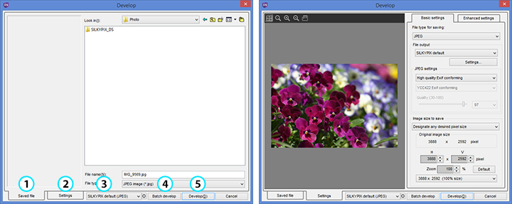

5.1. Develop This is a method for designating a way to save development processing and development results for selected single image. It processes following set instructions. You can select from two formats, a format for processing in real time and a format for registering jobs and processing in a batch. You can also register jobs for batch develop from "Develop" dialog, but compared to designating development with the "Batch develop" function, you can make more detailed settings and confirm development results in advance in the preview display. When you click the icon on the "Development settings" sub-control or the toolbar, the "Save as" dialog is displayed.You can specify the filename to save the developed image, and specify settings for saving. You can switch between "Saved file" and "Settings" pages in the "Develop" dialog. When the "Saved file" tab is selected, you can designate the file folder, file name and file type for saving the development results. When the "Settings" tab is selected, you can make settings for develop while looking at the preview display of the development results. After confirming instructions for saving files and development settings, click on the "Develop" or "Batch develop" button and begin processing. ![]()
5.1.1. Saved File This page is for designating files to be saved. 5.1.2. Settings Select a location (= folder) for saving files and designate a file name for the file to be saved. Select the type of file, either a JPEG image (*.jpg) or TIFF image (*.tif). Please make detailed settings related to JPEG / TIFF images on the "Settings" page. If there are file names marked for a job registered for batch development in a location (= folder) for saving files, those file names are displayed as marked file names. When a file name marked here is designated, jobs registered for batch development are cancelled, and if that file already exists, it will be overwritten. This page is for making settings for develop while looking at the preview display of saved results. Settings here include many that have an influence on the developed image itself and on the quality of the image. Confirm appropriate development instructions while checking the effects and influence on the preview display. 5.1.2.1. Develop Taste You can select tastes prepared in advance from "Develop" tastes. It is advisable to register settings you often use as tastes. 5.1.2.2. Basic settings
Set the pixel size of the image to be saved. There are two ways to make designations, as follows.
When executing develop, you can specify the image size to save. In other words, you can save an enlarged or reduced image with this feature. You can select an image size from the history, which includes the original image size (100%), the previous size, and the size that has been used for this image and also for other images. It is convenient to select it from the history if you want to save it with the same size as the previous image. However, the list shows only the size which is matched to the aspect ratio of the target image. Click the initialize button to return to default values.
5.1.2.4. Preview Before saving an image, you can check it with the preview, which reflects the effect of the "unsharp mask" and "JPGE compression". When you adjust the setting value for the "unsharp mask" or the JPEG image, the preview is automatically refreshed. It takes a time to complete the development of the entire preview image. But when part of the image is displayed, only the part is developed, shortening the time for development. You can change a tool mode or a display magnification from the context menu, which is displayed by right-clicking on the preview image. 5.2. Batch develop "Batch develop" is a function that develops multiple images together.A single process of developing and saving to a file a single image is called a "Job." When this job is registered in batch develop, batch development processes the registered jobs in the background. "Batch develop" develops in the background, so if jobs are registered, you do not have to wait for the processing to be completed, but rather you can immediately go to the next operation. If multiple images are being processed, "Jobs" for the number of images are prepared and these jobs are registered to batch development. They are processed in order. The following four methods are for performing batch develop.
