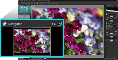

You can display the histogram of any channel of RGB. In addition, by clicking a graph, you can see each brightness statistic of the RGB.Lv is the value given to brightness (0-255) shown on the horizontal axis. "R", "G" and "B" are the statistical values for RGB in percentage (%) units. If the histogram of the image is evenly distributed for each RGB value (Lv value), the value for each statistical value 0-255 will be 1/256 = 0.39%. For normal photographs, most of the area will be in the range of 0.00-2.00, but brightness distribution may be consolidated in a photograph whose subject is almost a single color, such as completely dark photographs and macro shots of flowers. 6.3. Navigator The "Navigator" is a guide display for places displayed on the preview screen for the dedicated thumbnail.You can change the position of the display by dragging the guide on the "Navigator" in tool modes other than Fitted display, such as Zoom tool, Loupe tool or Palm tool. In addition, you can expand or shrink the preview with mouse wheel operations on the "Navigator". The Navigator is not displayed when in thumbnail mode because this is effective only when in the preview window is displayed. 6.4. Shortcut Keys and Function Keys Shortcut keys and Function keys that you can use in SILKYPIX® Developer Studio 7 are shown below.
