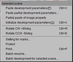

The menu command [Parameter(P)]-[Paste development parameter(P)] displays the "Paste part of the development parameters" dialog. The menu command [Parameter(P)]-[Paste development parameter(P)] displays the "Paste part of the development parameters" dialog. You can select the parameter category to paste on this dialog, and clicking [Execute] pastes the selected part of the parameters to the target scenes.

Next, display the "Partial paste for image property" dialog with [Parameter (P)] [Partial paste for image property] from the menu.

The menu command [Parameter(P)]-[Paste development parameter(P)] displays the "Paste parts of the development parameter" dialog.
You can select the parameter category to paste on this dialog, and clicking [Execute] pastes selected the part of the parameters to the target scenes.
