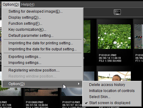

9.1. Setting for Developed Image
 The menu command [Option(O)]-[Setting for developed image(E)] displays the "Setting for developed image" dialog.

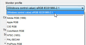

9.2.1.1. Monitor Profile
 If "color management" is enabled, you can specify a monitor profile by the following two ways.
Monitor profiles listed in the dropdown list are RGB-XYG format RGB-Lab format profiles within the profiles registered in the OS.
The most desirable method is to prepare a monitor profile especially for the monitor, upon calibrating the monitor with special software. Using a monitor profile prepared appropriately with this method is the limit of feasible color management on this monitor.
Even if you do not have special software for creating a monitor profile, a monitor profile for the monitor may be available, depending on the monitor's manufacturer. Please check the manufacturer's home page.
Please refer to "10.4.5.4. Color management on monitor displays" for details.

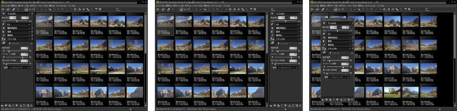

9.2.2. Display format in parameter controls
 You can specify the location of the "parameter control" that is main GUI control. You can set it left side (default) or right side in the main window, or change it to a floating windows.

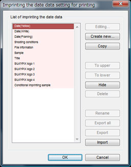

| (1) | List of imprinting the date data |
A list of registered "Imprinting the date data" will be displayed.
There are two kinds of "Imprinting the date data." These two are maker data prepared by our company and user data created by you.
Maker data
This is displayed with a red background. These cannot be deleted or exported. If edited, they will be registered separately as user data.
User data
| (2) | Editing | Edit selected data. |
| (3) | Delete | Delete selected data. |
| (4) | Create new | Create new data. |
| (5) | Copy | Create a copy of selected data. |
| (6) | To upper | Move display position of selected data up one. |
| (7) | To lower | Move display position of selected data down one. |
| (8) | Disable / Enable | Remove selected data. Maker data cannot be deleted, but this setting will cause data to no longer be displayed in the list. |
| (9) | Export all | Export all user data and save to a file. |
| (10) | Export | Export selected user data and save to a file. |
| (11) | Import | Import user data saved to a file. |

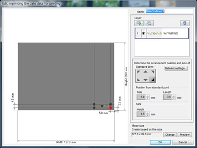

9.6.1. Edit imprinting the date data
 Data items for imprinting the date can be edited with the edit imprinting the date data function.
| Data name |
| Characters for imprinting |
| Image for imprinting |
| Standard size of data |
As for imprinting the date, the camera creates data that makes settings for a standard size. It automatically adjusts the position and size to the size of the image that is output when printed and saved based on the position and size of the standard size, and imprints the characters and images.
| (1) | Edited image display area |
Designate a name for the imprinting the date data. This name is displayed when selecting imprinting the date.
9.6.1.1. Layer settings
Copy selected layer.
Delete selected layer.
9.6.1.2. Character settings
You can edit a layer by selecting a layer from here. Edit others with detailed settings.
| (2) | Position from standard point |
Set character size. The width of characters is automatically determined by characters for imprinting.
The composition mode for imprinting the date when printing and developing can be designated.
When composition mode automatically adjusts the size, if the standard size of imprinting the date is changed to match the size of the image, the height will change at the same ratio. By doing so, whatever the size of the image, it can imprint the height at the same ratio as the standard size.
If a fixed size is being used in the composition mode, imprinting will be performed at the set size.
[List of control characters]
| %L | Focal length |
| %F | F number |
| %T | Shutter speed |
| %I | ISO speed |
| %l | Lens |
| %c | Model |
| %Y | Date/time of photograph year (2 digits) |
| %y | Date/time of photograph year (4 digits) |
| %M | Date/time of photograph month |
| %D | Date/time of photograph day |
| %h | Date/time of photograph hour |
| %m | Date/time of photograph minute |
| %s | Date/time of photograph seconds |
| %n | Filename |
| %C | Comment |
| %t | Title |
| %% | 'Description method for e%' |
| %{ | Description method for e{' |
| %} | Description method for e}' |
| %r | Description method for Enter |
| %?x{string} | Conditional imprinting Designate characters such as L, F or T after e%' control characters in the ex' following e?". Designate characters for display if conditions are met in "characters."
Conditional imprinting is a function that takes into consideration conditions of the "characters" displayed as characters for imprinting, displays only if they meet set conditions, and if they do not meet the conditions, does not display them.
For example, the focal distance is described as the control character "%L," but by applying this eL' to ex' for conditional imprinting and setting eL' "%?L{character}", if the focal distance is recorded or edited, this will become the condition for displaying the "characters." If defined as "%?L{The focal distance is %L}", and the focal distance has been recorded or edited as "50mm," "The focal distance is 50mm" will be displayed.Nothing will be displayed if there is no focal distance data. |
9.6.1.3. Image settings
Read an image. You can read JPEG and TIFF images.
9.6.1.4. Base size
You can change settings for the base size of imprinting the date data and preview displays of the edited image display area.
Set position and size to the standard size of characters and images for imprinting with imprinting the date.
Set this standard size.
The composition mode for imprinting the date when printing and developing can be designated, but if a fixed size is being used in the composition mode, imprinting will be performed at the set size. When composition mode automatically adjusts the size, the ratio of image and character size will remain the same as the base size and the size will change to fit the paper and output size.
For example, you can check how much the size has been automatically adjusted for set imprinting the date data at L size.

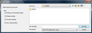

9.7.1. Export
To export settings, select [Option (O)] [Export settings] from the menu. This will cause the "Export settings" dialog to appear.
| (2) | Settings to be exported |
Select the settings you want to save. Whether only one of four settings or all four settings, they will be recorded and saved in a single "sps file."
Settings in the designated file are exported when you click the [Save] button.

9.8. Option Feature
9.8.1. Delete Access History
This function deletes an access history to files/folders.
9.8.2. Initializing Location of Control
9.8.3. Select Skin
This function allows you to change the background skin of this software. It displays the "Select skin" dialog, and you can select a skin on the dialog.
This new skin is only visible after restarting SILKYPIX® Developer Studio Pro. To display with the new skin, please close this software once and re-execute it.
9.8.4. Start screen is displayed
The start screen is displayed when you start SILKYPIX® Developer Studio Pro. You can set this screen to display or not.

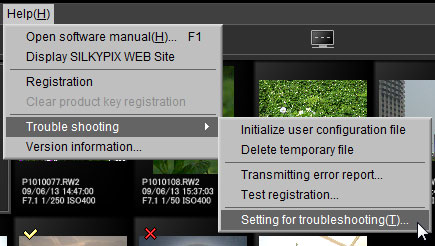

9.9.1. Initialize user configuration file
Initialize SILKYPIX user configuration files by selecting [Help (h)] [Trouble shooting] [Initialize user configuration files] from the menu.
When you perform this process, you return to the original conditions for all settings such as function settings, display settings, development save settings and trouble shooting settings, as well as file history, folder history, window locations, etc.
After performing this operation, the program will shut down, so please restart it. It will start with settings in their initialized conditions.
9.9.2. Transmitting error report
If SILKYPIX detects an irregularity, error information may be recorded.
This function collects error information remaining at times of irregularities and sends an error report to our company's server.
Please do not use this function without instructions from our company's support desk.
If problems arise on your PC such as a forced shut down due to a SILKYPIX application error, contact our company's support desk.
In such a case, our company's support desk may ask that you provide information so that they can analyze your problem.
We will send a "Sender ID" if we request you to send an error report. You cannot send an error report to our company without entering this "Sender ID."
When you select [Help (h)] [Trouble shooting] [Send error report] from the menu, the "Send error report" dialog will be displayed.
After entering the "Sender ID" our company's support desk sent to you, click on the [Send] button. The error report will be automatically sent to our company's server.
Another method has been prepared for cases when you cannot send the error report from your PC. You can save the error report to a file and send it to our company as an attached file in an e-mail.
Enter the "Sender ID" our company's support desk sent you, and when you click on the [Save] button a "Save asc" dialog will appear for saving the file.
When you set a file name for recording here and click on the [Save (S)] button, a SILKYPIX error report will be saved in the designated file.
Our company's support desk will give additional instructions on how to send this file to our company.
9.9.3. Test registration
When you select [Help (h)] [Trouble shooting] [Product key registration test] from the menu, the "Product key registration test" dialog will be displayed.
Click on the [Test] button to begin the test.
If "Online registration of product key is possible" is displayed, you can perform online registration of your product key from your PC under current conditions.
If "Online registration of product key is not available" is displayed, you cannot perform online registration of your product key from your PC under current conditions.
If it is determined that you cannot perform online registration of your product key, enter the product key in the "Product key registration" dialog and register offline by clicking on the "Offline registration" button.
Please see "1.2.2.2. Product key offline registration" for details on offline registration.
