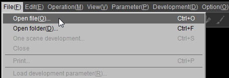

Select [File (F)] – [Open file (O)] from the menu or click on the  icon in the tool bar to display the [Open file] dialog.
You can designate one or more image files for processing from the [Open file] dialog.
When selecting multiple image files for processing, do so while holding down either the [SHIFT] key or [CTRL] key.
When the [CTRL] key is pushed, the "Open (O)" button changes into an "Add and open (O)" button. If adding, please click on the "Add and open (O)" button in this status.
If you click [Open(O)] button without clicking [CTRL] key, the RAW data files is closed automatically which have been already loaded for processing. And the RAW data files selected in this time is loaded instead of them.

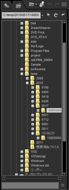

2.2. Opening Folder
2.2.1. Selecting from dialogs
 Open Folder function allows you to select and load the RAW data files from the specified folder. All image files for processing in the designated folder will be processed. This will be designated as new processing, and image files for processing up to that point will be automatically closed.

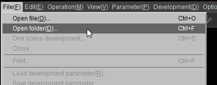

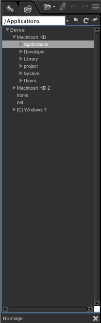

Select [File (F)] – [Open folder (D)] from the menu or click on the  icon in the tool bar to switch the Parameter Control display to the Folder tree screen.
 Select folder dialog of Windows |
 Select folder dialog of Macintosh |
| (A) | Folder name edit box |
| The path for the selected folder is displayed. You can also edit these characters and designate a folder to open. |
| (B) | Button to select from folders that had previously been selected (Folder history) |
| Designate a folder from the folder history. Please see 2.2.2. Selecting from folder history for details. |
| (C ) | Button for designating subfolders |
| You can set whether subfolders will also be searched when reading. See 2.2.1.1. Designating subfolders for details. |
| (D) | Button for renewing folder display |
| This renews the folder tree display to the latest status. You can introduce mdeia and reflect newly created folders on the display. |
| (E ) | Folder tree |
| Folder tree is displayed. Select a folder by clicking on a folder. The selected folder is for new processing. Image files that had been processing to that time will be automatically closed. Also at that time, the selected folder will become the focus and the folder name will be circled. If you hold down the [Ctrl] key and left click on a folder not on the focus, you can add that folder. If you hold down the [Shift] key and left click on a folder not on the focus, you can select multiple folders that were left clicked while holding down the [Shift] from the folder of focus. Additional folders cannot be designated subfolders. Only designated folders are referred. The background of the folder name for the folder with files currently being read is white. |
