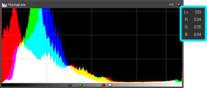

6.2. Histogram
The menu command [View(V)]-[Histogram(H)] displays the "Histogram" sub-control.
Histogram displays a brightness distribution on a picture.
You can check which part of the picture has what level of brightness. The horizontal axis shows brightness (0-255), and the higher the value (right side), the greater the brightness.
The vertical axis shows the number of pixels that corresponds to relevant brightness level. R,G, and B are displayed in each color on a graph, and the place where these overlap it is displayed as an additive color mixture.
6.2.1. Display of Histogram
The arrow displayed on the gray scale at the bottom has the following meaning.
(1) Contrast center
(2) RGB marker
This displays RGB value at the point where the mouse cursor is on. The value corresponds to the brightness position on a graph.
It is very effective to check where a color of a point on a screen is distributed on a histogram.
In addition, by clicking a graph, you can see each brightness statistic of the RGB.
Lv is the value given to brightness (0 ~ 255) shown on the horizontal axis. "R," "G" and "B" are the statistical values for RGB in percentage (%) units.
If the histogram of the image is evenly distributed for each RGB value (Lv value), the value for each statistical value 0 ~ 255 will be 1/256 = 0.39%.
For normal photographs, most of the area will be in the range of 0.00 ~ 2.00, but brightness distribution may be consolidated in a photograph whose subject is almost a single color, such as completely dark photographs and macro shots of flowers.
