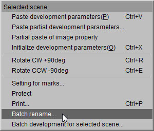

8.4.2. Batch rename
When some scenes are selected in the thumbnail mode or the combination mode, the menu [File(F)]-[Batch Rename] displays the "Batch rename" dialog.
You can also display the "Batch rename" dialog by selecting [Batch rename] in the context menu. By inputting the base name that you want to use in this dialog, you can rename the files that have the same base name and exist in the same folder collectively.

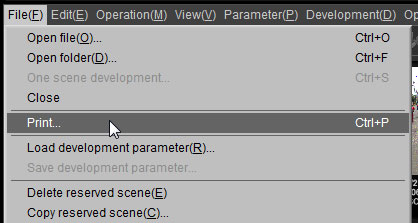

8.5. Printing
This function prints selected scenes on a printer.
This function has two printing formats, one is "Normal printing" that prints one scene on one sheet, the other is "Contact sheet" that prints multiple scenes on one sheet.
The menu command [File(F)]-[Print(P)] displays the "Print" dialog.
