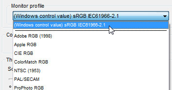

9.2.1.1. Monitor Profile
 If "color management" is enabled, you can specify a monitor profile by the following two ways.
The most desirable method is to prepare a monitor profile especially for the monitor, upon calibrating the monitor with special software. Using a monitor profile prepared appropriately with this method is the limit of feasible color management on this monitor.
Even if you do not have special software for creating a monitor profile, a monitor profile for the monitor may be available, depending on the monitor's manufacturer. Please check the manufacturer's home page.
Please refer to "10.4.5.4. Color management on monitor displays" for details.
| * | If colors differ when compared to other software, the cause may be that one of the software's color management has not been enabled, or the monitor profile being used is different. |

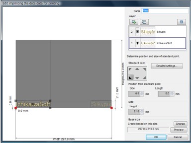

9.6.1. Edit imprinting the date data
 Data items for imprinting the date can be edited with the edit imprinting the date data function.
| Data name |
| Characters for imprinting |
| Image for imprinting |
| Standard size of data |
As for imprinting the date, the camera creates data that makes settings for a standard size. It automatically adjusts the position and size to the size of the image that is output when printed and saved based on the position and size of the standard size, and imprints the characters and images.
| (1) | Edited image display area |
Designate a name for the imprinting the date data. This name is displayed when selecting imprinting the date.

9.6.1.3. Image settings
| (2) | Position from standard point |
The composition mode for imprinting the date when printing and developing can be designated.
When composition mode automatically adjusts the size, if the standard size of imprinting the date is changed to match the size of the image, the height will change at the same ratio. By doing so, whatever the size of the image, it can imprint the height at the same ratio as the standard size.
If a fixed size is being used in the composition mode, imprinting will be performed at the set size.
Read an image. You can read JPEG and TIFF images.
9.6.1.4. Base size
You can change settings for the base size of imprinting the date data and preview displays of the edited image display area.
Set position and size to the standard size of characters and images for imprinting with imprinting the date.
Set this standard size.
The composition mode for imprinting the date when printing and developing can be designated, but if a fixed size is being used in the composition mode, imprinting will be performed at the set size. When composition mode automatically adjusts the size, the ratio of image and character size will remain the same as the base size and the size will change to fit the paper and output size.
For example, you can check how much the size has been automatically adjusted for set imprinting the date data at L size.

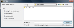

9.7. Importing and exporting settings
| Setting for developed image |
| Display setting |
| Function setting |
| Key customization |
Setting data that is exported is recorded in "SILKYPIX setting file (*.sps)".
9.7.1. Export
To export settings, select [Option (O)] – [Export settings] from the menu. This will cause the "Export settings" dialog to appear.
| (2) | Settings to be exported |
Select the settings you want to save. Whether only one of four settings or all four settings, they will be recorded and saved in a single "sps file."
Settings in the designated file are exported when you click the [Save] button.
