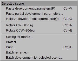

By the menu command [Parameter(P)]-[Paste development parameter(P)] or the short cut key [CTRL]+V, you can paste the entire development parameter from the paste buffer to the selected scenes.

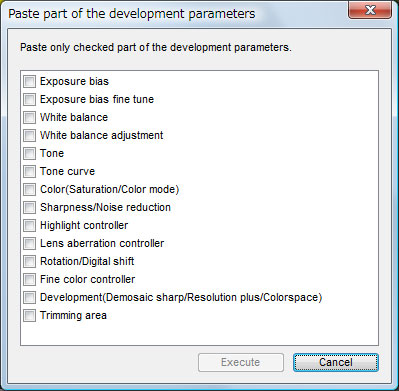

7.1.2. Paste Partial Development Parameter
Use when pasting partial development parameters and parameters that are not development parameters (trimming area) that are recorded in the paste buffer.
The menu command [Parameter(P)]-[Paste development parameter(P)] displays the "Paste part of the development parameters" dialog. The menu command [Parameter(P)]-[Paste development parameter(P)] displays the "Paste part of the development parameters" dialog. You can select the parameter category to paste on this dialog, and clicking [Execute] pastes the selected part of the parameters to the target scenes.

(2) | Paste Development Parameters |
This function sets the development parameter that is in the paste buffer by "Copy Development Parameter" function, to all selected scenes.
(3) | Paste Partial Development Parameters |
This function allows you to paste the part of the development parameter to all selected scenes.
The menu command [Parameter(P)]-[Paste development parameter(P)] displays the "Paste parts of the development parameter" dialog.
You can select the parameter category to paste on this dialog, and clicking [Execute] pastes selected the part of the parameters to the target scenes.
