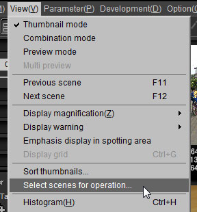

Displaying scenes for processing is done in two types of display windows. The first is a "Thumbnail window" that displays a list of scenes for processing. The other is a "Preview window" for large display of only one selected scene. The "Preview window" offers functions that divide the window in two for comparing two scenes or comparing results from adjusting different development parameters of the same scene. Three display modes are available in SILKYPIX® Developer Studio Pro through the combination of these two kinds of windows.
The thumbnail display mode is a display mode in which the "Thumbnail window" is located in the main window and the preview window is not displayed.
The preview display mode is a display mode in which the "Preview window" is located in the main window and the thumbnail window is not displayed.
The "combination mode" is a mixed mode of the "thumbnail mode" and "preview mode", displaying Thumbnails and single view at the same time. You can select a format that displays both in the main window or a format that displays the "Thumbnail window" outside of the main window as a separate floating window. 3.1. Switching Display Modes Switching to "Thumbnail Display Mode," "Preview Display Mode" and "Combination Display Mode" can be performed at any time with [Display (V)] in the menu or with the tool bar icon. If you double click a selected scene in "Thumbnail Display Mode," it will switch to "Preview Display Mode." 3.2. Preview window The "Preview Window" is a window for displaying preview images of selected scenes. By opening a preview image of a selected scene, you can view the entire image or enlarge just one part to check it. 3.2.1. Multi preview There is a multi preview function in the "Preview Window" in which you can split the screen horizontally and show two images. There are two multi preview modes. Three examples of ways to utilize them will be introduced here. Please make full use of their applications.

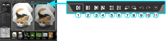

Of the two displays, make the left display your main preview, and use the right display as a reference preview. The selected scene for adjusting development parameters will always be displayed in the main preview. There are several ways you can choose scenes to be displayed in the reference preview, but whichever way you choose, the reference preview display is for comparison uses and you cannot edit development parameters there.
Use this to choose the best scene taken from multiple images.
Selected scenes for adjusting development parameters are displayed on both displays. 3.2.1.1. Operation Methods You can set options such as display position and magnification for the two screens, so you can view one overall image of the scene and use the other screen to display partial magnification. You can also display two important parts of the photograph and decide how to adjust parameters. Switch to multi previews by clicking on the 3.2.1.2. Selecting Reference Preview Scenes icon in the tool bar.The status of the multi preview display is shown at the top of the screen in the icon bar as seen in this figure. You can change modes and preview displays with these icons. ![]()
You can display a scene different from the main preview scene in the reference preview or different development parameters for the same scene as the main preview. Select a history to be displayed from among the development parameters editing history to show different development parameters.
Use the and icons on the icon bar to go to displays of the previous or next scene.
The icon is displayed to the lower right of the scene when the mouse is moved over the scene to be switched on the thumbnail window.You can display the designated scene in the reference preview by clicking on this icon. You can also display the designated scene in the reference preview by clicking on the scene while holding down the [ALT] key.
You can go to the previous scene with [ALT + Leftarrow] and the next scene with [ALT + Rightarrow].
If you are displaying the same scene in the main preview and the reference preview, you can switch the reference preview displays to an arbitrary position in the editing history.
Use the and icons on the icon bar to switch editing history positions.
If is displayed on the right side of an item in the editing history, that history will be reflected in the current reference preview.Move the mouse over the history you want to show in order to change the history displayed in the reference preview. By doing so, when the mouse is over the scene, will be displayed and you can click on this icon.3.2.2. Changing operation modes and display position / magnification The preview display comes with functions for changing display position and magnification for checking parts of the image, as well as functions for making adjustments to development parameters with the mouse in the preview display. The aims of mouse operations in the preview display are switched in "Operation mode." In "Operation mode," there are two types of tools, one type that changes display position and magnification and another type that makes adjustments to development parameters. Be sure to select one of the following operation modes for changing display position and magnification: "Fit display," "Zoom tools," "Loupe tools [Enlarge +]," "Loupe tools [Reduce -]" and "Palm tools." "Fit display" is a mode that fits the entire image in the display. The other four tools can be used to change display position and magnification through their own methods. There are seven kinds of tools for changing development parameters, including "Exposure bias tools," "Gray balance tools," "Skin color designation tools," "Rotation tools," "Magnified color aberration correction tools," "Spotting tools" and "Set trimming area." You can select one of these, or select none of them. These tools are used together with operation modes that change display position and magnification. 3.2.2.1. Changing preview display position and magnification There are several ways to change preview display position and magnification. 3.2.2.2. Change display position / magnification with the mouse Methods other than changes through mouse operations on the preview display will be explained here.

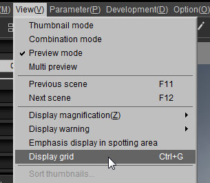

Click on the preview display mode icon on the tool bar, and a menu will be displayed for changing operation modes and display magnification in the preview display. Also, items for changing display magnification are enumerated in a submenu opened from [Display (V)] [Display magnification (V)] from the menu and in a context menu displayed by right clicking on the preview window. Display magnification can be changed from these menus.

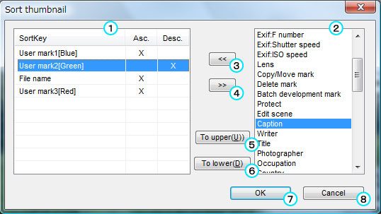

You can specify the order of the sorting key on this list. The sorting key is applied in turn from top of the list. "Ascending order" displays in order from small values to larger values, but if marked, set scenes are displayed first and scenes not set displayed after those. "Descending order" is displayed in reverse order to "Ascending order." And you can specify whether ascending order or descending order to each sorting key.
A list of keys that can be added as sorting keys is itemized. When selecting one key on the list and clicking the (3) button, you can add the key to the bottom of the list of (1).
When clicking this button, the sort key selected on the (2) list will be added to the bottom of the list of (1).
When clicking this button, the sort key selected on the (1) list will be removed.
When clicking this button, the sort key selected on the (1) list will be moved upper of the list..

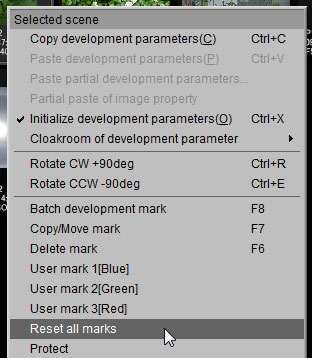

When clicking this button, the sort key selected on the (1) list will be moved lower of the list.. 3.4. Operations for selected scenes 3.4.1. Reservations / Marks You can make reservations /marks for operating and managing scenes. By right clicking on a thumbnail or preview image, a pop-up menu will appear, from which you can select reservations / marks and cancel set reservations / marks.
To cancel a reservation / mark set on a scene, right click on a thumbnail of a marked scene to display a context menu.Select "Delete all reservations / marks" to delete all set marks and operations. To cancel individual set marks, select the mark and reservation for deletion from the context menu. A maximum of five kinds of marks can be set to a single image.The following combinations can be set.
