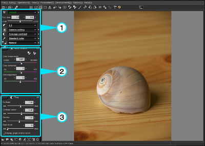

Use the "Parameter control" to adjust development parameters. By default, the "Parameter control" appears at the left side of the screen. You can move its position to the right side with [Display Setting].Furthermore, you can change it to a floating window with the [Display setting]. On the "Parameter control", there are the following 3 sections; (1) "Main control section" consists of some dropdown lists to select a taste (=preset value) and the "Exposure bias" slider control. (2) "Tab page" is an area for the sub-controls, which are selected on the "Parameter control". (3) "Control box" is an area for other sub-controls, which are used to adjust an image in even more detail by setting specified values. The "sub-control", located on "Tab page" or "Control box", is a control for selecting a value in each category of the development parameters. The sub-control can be displayed also as a floating window. You can specify the setting of "Parameter control" by [Display setting], which appeares on the menu command [View(V)]-[Display setting]. And you can specify the setting by a right-click upon the title area. As a basic workflow, first set the level of the Exposure bias with "Slider control", then select each "taste" for white balance, tone, color, and sharpness/noise reduction. 4.1. "Parameter Control" and "Sub-control" Parameter control has 3 sections. On the "Main control section" that is the top section, there are the following controls;
The dropdown list is the GUI for selecting a taste (=preset value) that is prepared in advance by ISL (Ichikawa Soft Laboratory) or a user. The "taste" is a value consisting of development parameters. For more details about the "taste", please refer to '4.1.1 Taste'. When you select a taste from the dropdown list, the related sub-controls automatically appear on the "Tab page". However, according to customer's preference, the sub-controls can be located on the "Control box" or a floating window. 4.1.1. Taste Taste is a preset value , like a collection of development parameters. You can easily define a "taste" value for frequently-used development parameters.
Model development parameters are recorded in advance in SILKYPIX as maker tastes. You can use these to easily make adjustments to development parameters. Open the dropdown list and select a "Taste" to apply. By doing so, the development parameter registered in tastes will be reflected. There are both "Overall tastes" to replace all development parameters and "Partial tastes" for a set of part of the development parameters found in tastes. Applying "Partial tastes" is an action equivalent to "Partial paste of development parameters."
Register development parameters which are used often can be saved as user tastes, making them easier to recall. There are two ways to register to tastes, "All category tastes" for all development parameters, and other tastes registered as category units in development parameters. Please refer to "4.1.1.3. Registering tastes" concerning how to register. 4.1.1.1. All category tastes The dropdown list of "All category tastes" located to the side of the icon at the very top of the main control section in parameter controls will be explained here.Tastes that can be selected here are all category tastes intended as "All categories" of development parameters. There are two kinds of tastes, "Overall tastes" and "Partial tastes" in "All category tastes." [Explanation of Display]
If "Overall tastes" is selected, all categories of development parameters will be replaced.
If "Partial tastes" is selected, only a part of the categories of development parameters will be replaced.
When you open the dropdown list, you can see and select the tastes on the list. [Display of the selected taste]There are two kinds of tastes, one is "maker taste" prepared by ISL and the other is "user taste" defined by user. And you can find "Default" and "Manual" on the list, which are not "tastes". They have the following meanings;
When the dropdown list is closed, the name of the current taste is displayed. When one of registered tastes is selected, the name of the selected taste is displayed. The name of a partial taste is not displayed. Instead, "Default" or "Manual" is displayed.

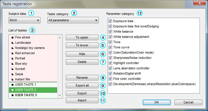

4.1.1.3. Adding Taste You can add / register a development parameter applied to a currently selected scene as a taste. 4.1.1.4. Customizing Taste There are two ways to add / register a taste. Select [Taste category] from [Parameter (P)] [Register taste] on the menu, or click on the icon located on the right side of the dropdown list.The "Taste registration" dialog will be displayed. The "Taste registration" dialog format is the same as the "Edit taste" dialog. Please see the next section, "4.1.1.4. Editing tastes" concerning operation methods for this dialog. "Tastes" added through the "Taste registration" dialog will be displayed in dialogs as selected, so set an appropriate name for the taste and click on the [OK] button to confirm. Items set in the "Taste registration" dialog
By default, names are set sequentially, such as "User taste 1." Change to an appropriate name to make it easy to distinguish from other tastes.
If "Taste category" is added as a taste other than "All categories," it is not necessary to edit because "Applicable development parameter category" is fixed to one category. If the "Taste category" is "All categories," you can enable any category in "Applicable development parameter category." Enabled categories are set as taste masks. You can edit registered tastes. You can customize by changing taste names and the order they are displayed to make it easier to select tastes. You can also save / restore tastes and move then to other PCs through export and import functions "Taste registration" is performed from [Parameter (P)] [Taste registration] on the menu. ![]()
A mark at the left of a taste title: The taste represents all development parameters if you select taste category "All parameters". The taste only part of the parameters if you select taste category "All parameters".Maker taste These are displayed with a red background. They cannot be deleted, exported or moved. User tasteThese are displayed with a green background.
When you add a new taste, the "Customize taste" dialog is also displayed and you can customize a name of a new taste and other settings as well as the taste customizing. 4.1.1.5. Applying Tastes to Multiple Scenes You can apply a taste to multiple scenes at the same time. In the "thumbnail mode" or "combination mode", when you select multiple scenes at the same time, the icon on the right side of the dropdown list changes to .When you click this icon, the taste list opens. Select one taste to apply and click "OK", then the selected taste will be applied to all selected scenes.

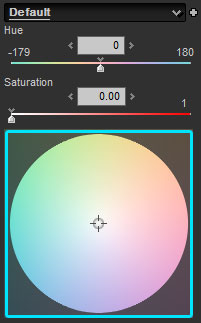

This graphic control is based on the accurate colorspace. You can set the white balance visually by clicking a mouse directly. [Mouse wheel operation] You can change "saturation" parameter with the mouse wheel on the white balance target. And with [SHIFT] key, you can change "hue" parameter.

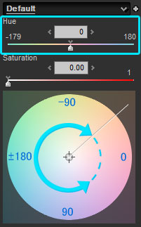

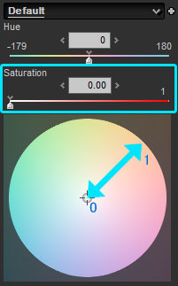

It shows the angle from the right hand side of the white balance target in clockwise. Move the slider to change the angle in detail. You can specify the setting value indicates:
It shows the radius from the center of the white balance target. Move the slider to change the radius in detail. The range is 0.00 to 1.00 (0.00 is the center of the white balance target, 1.00 is the maximum radius). We will now introduce you some setting samples to show how to get the colors you want. ![]()

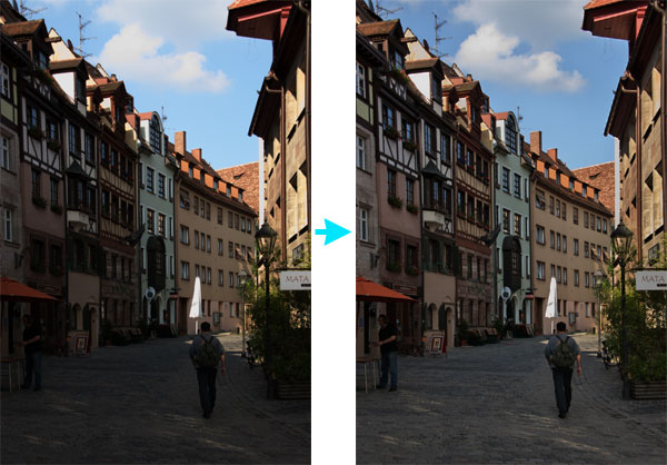

4.5. Tone Adjustment Tone adjustment parameter adjusts the contrast, high or low. Use the "Tone curve" for making minute adjustments. 4.5.1. Adjusting Tone with Taste Select a taste from the dropdown list of "Tone". Tones in incremental steps from Low to Strongest are included as maker tastes. "Average" is the SILKYPIX default setting. "Average" is a higher contrast than that obtained using sRGB and Adobe RGB standard tone curves, and is set to improve the overall appearance of an image. Setting to "Standard" will give similar contrast levels to sRGB and Adobe RGB standard tone curves. 4.5.2. Fine-Tuning Tone Tone adjustment can also be made to "Contrast", "Contrast center, and "Gamma."
Contrast means the difference between bright area and dark area.When increasing the contrast, the bright area becomes brighter and the dark area becomes darker, i.e. high contrast. On the contrary, when decreasing the contrast, difference between the bright area and dark area becomes smaller, i.e. low contrast.
This is the reference to judge the brightness when adjusting the contrast. Upper levers from the contrast center are considered bright, and lower levels are considered dark. In other words, this reference decides the point where the brightness level is not changed when adjusting the contrast.When setting the contrast center smaller, the tone of an image becomes lighter. This is because the contrast is increased based on the dark area, and causes the dark area to become smaller and the bright area larger. For example, by strengthening the contrast, "Bright areas" become brighter and "Dark areas" become darker, but "Mid contrast" is the midpoint between "Bright areas" and "Dark areas," and there will be no influence on contrast. When setting the contrast center larger, the tone of the image becomes darker. While, setting the contrast center smaller, the tone of the image becomes brighter with the mid contrast level expanding. Therefore, if a target object is dark, set the contrast center smaller, and if it is bright, set the contrast center larger to obtain an ideal tone. [Utilizing Histogram] Mid contrast is displayed with the mark at the bottom of the histogram. The brightness of R, G, B where the mouse cursor is pointed to on the preview display is also displayed here.When you use this function to adjust while looking at brightness distribution on parts you want to use contrast, you can find the optimal value relatively easily.
Gamma is a brightness adjustment. As the gamma increases, the overall brightness becomes higher, and vice versa.You may think it is the same as exposure bias operation, however, they are not the same thing. With the exposure bias, the brightness is adjusted without changing the ratio of bright range and dark range . However, with gamma, the ratio is changed. When increasing the gamma value, the bright range is compressed, and the dark range is expanded. When decreasing the gamma value, the dark range is compressed and the bright range is expanded. Therefore, in this software, this operation is considered as a tone-change-operation and classified as 'Tone Adjustment' since it changes tone.
Black level controls create clarity of the dark areas.You can specify the level of black with this function. When increasing this parameter, the color black becomes deeper black. This function works effectively when a picture is taken against the sun and the image becomes unimpressive, or when a landscape image becomes washed out, or when a landscape image becomes obscured or influenced by haze.

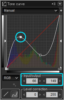

By placing a check next to "Display graph in tone curve," you can display the status of adjustments here in a graph in the "Tone curve" sub-control. By adjusting the "Tone" parameter when displayed as a graph in the tone curve, you can visually confirm the parameter status in the graph. Displaying the "Tone" graph can also be useful when making further minute adjustments on the "Tone curve." 4.5.3. Tone Curve The "Tone curve" is a tool for making minute adjustments to tone expression and for converting brightness for effect. The menu command [View(V)]-[Tone curve(T)] displays the "Tone curve" sub-control. You can also display it using the sub-control icon "Tone curve" button. You can set the curve (= Tone curve) that converts brightness on this sub-control. The horizontal axis means input (brightness of source picture) and the vertical axis means output (brightness results of a picture after adjustment). You can control lightness in a picture by operating this curve. * By dragging window's frame of the "Tone curve" sub-control, you can adjust a size of the dialog. In addition, by dragging it while pressing the Shift key, you can adjust the size while fixing the aspect ratio of it. 4.5.3.1. Selecting a Taste Several tastes that have good effects are included as Maker Tastes in tastes. There are also special items such as "Initialization" and "Initialize All" within the tastes of the tone curve. "Initialization" initializes only the tone curve of the selected channel (all RGB, R, G or B), while "Initialize All" initializes all four tone curves. 4.5.3.2. Editing Points The curve is drawn as passing through a point, and you can operate the curve by moving the point. Selected point information is displayed on the "Input / Output" control. You can move the point by editing the value in this control or by dragging the point on the tone curve.

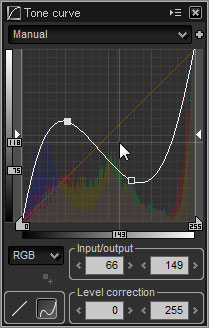

Click the mouse on a graph to place a point at the position. You can also click to switch to a mode that will add a point to the tone curve and add a point from the preview display.
Select a point for operations. The selected point is displayed with .You can switch selections by clicking the point with the mouse.
Move the point by dragging the selected point on the graph or by changing the coordinate value of the point displayed in the "Input / Output" control.
Move and right-click the mouse on the target point to delete. In addition, you can delete the current point by pressing the 4.5.3.3. Control explanation
The process is reflected in order of tone curve settings for each R, G, and B first and then tone curve setting for RGB.
[How to use "Add point" function] Click "Add point" button to add the target tone point on the tone curve.

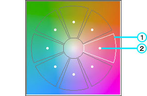

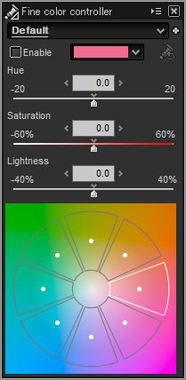

4.10. Fine Color Control The fine color controller is a powerful color adjusting function that can freely handle colors. Select [Display (V)] [Fine color controller] from the menu to display the "Fine color controller" sub-control. It can also be displayed from the fine color controller icon in the sub-control icons at the bottom of parameter controls. The fine color controller divides colors into 8 hues and provides a function for adjusting colors in each of the hues. The color circle hue display shown on the control is arranged so that white is in center of the chroma chart, with color positions starting at the 3:00 position on a clock and going clockwise in the following order.
Color placement is arranged on this color circle such that the further from the center of the color circle, the higher the chroma, and they are placed at average color intervals as much as possible to meet human perception. Hues are the Munsell value of the hue at roughly the center of the hue block, and color names are mainly given following names found in JIS standards (JIS Z 8102).
There are two main ways to adjust parameters on the fine color controller. These are a method of operating a mouse on the color circle and a method of setting parameter values using a slider control. Please use these together for effective parameter adjustments. 4.10.1. Adjustments using the color circle As seen in the diagram of the color circle shown above, the color circle is divided into 8 hue blocks, and there are operation points in each of these blocks. (1) shows a block, and (2) shows an operation point. A hue for operation is selected by clicking any of the 8 blocks. Borderlines of the blocks of hues for operation are displayed in bold. Operation points in each block can be moved by dragging the mouse or with the mouse wheel. With either of these methods, movements along the circumference are interlocked with "Hue," and distance from the center of the color circle is interlocked with "Chroma." Adjusting the "Brightness" parameter can be done with the mouse wheel, but it will not be shown on the color circle. Parameters adjusted through mouse operations are reflected on the slider control, so both the color circle display and the slider control display are synchronized. [Mouse wheel operation] You can operate the "saturation" slider with the mouse wheel on color circle GUI. [SHIFT] key + mouse wheel is for the "hue" slider and [CTRL] key + mouse wheel is for the "lightness" slider. 4.10.2. [Adjusting with the sliders] Adjustments to each parameter value on standard controls, compared to the method of adjusting the color circle with the mouse, will be explained here. 4.10.3. Methods and Notes on Utilizing Fine Color Controller
The Fine Color Controller is a color transformation tool that displays emphasized colors or, conversely, moderates them, and changes colors. It is advantageous to perform adjustments on the image as the last process because color engineering is a type of image processing that destroys the balance of colors. We hope that you will experiment and use freely, but one matter that requires attention is that it is advantageous to adjust white balance, exposure and color mode before adjusting the fine color controller. White balance and exposure are basic adjustments and giving priority to these adjustments does not mean that you are limiting fine color controller, but if you perform fine color controller adjustments first, you may not be able to adjust the white balance and exposure as you would like. The color mode is an item you should try adjusting before using the fine color controller if you want to emphasize the subject. It would not be an exaggeration to say that the color mode is a kind of fine color controller taste. First choose a color mode that seems to be desirable before independently adjusting the fine color control. [Example of adjustment] One example would be a photograph of a person as the main subject taken close up against a background of a blue sky and red flowers.

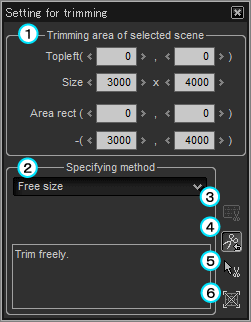

4.13. Trimming Use when making a creation by trimming a part of the image in a photograph. Trimming area settings can be performed by switching "Operation mode" in the preview display to "Set trimming area." The "Operation mode" of the "Set trimming area" can be used only if the "Preview window" is displayed from either "Preview display mode" or "Combination display mode." Switching to "Operation mode" can be performed by selecting [Operation mode (M)] [Set trimming area] from the menu, or by clicking on the icon in the tool bar, or by pushing [CTRL] + [T].When "Operation mode" changes to "Set trimming area," the "Set trimming area" sub-control will be displayed along with handles for controlling the frame lines that show the trimming area on the preview image. ![]() When a trimming area is set, a trimming mark will be displayed on the thumbnail. When setting trimming areas, first determine a format for setting the trimming area with "Area setting format." You can freely set the trimming area into a rectangle, and can perform trimming in accordance with the purpose of the output by fixing the aspect ratio. There are three way to set the trimming area: Adjusting the handles displayed in the "Preview display" with your mouse; Adjusting parameters in the "Set trimming area" sub-control; and designating with the "Trimming tools." The trimming area has to be set for each scene, but the "Area setting format" is common to each scene as a software setting. 4.13.1. How to Operate Handle in Trimming Area Trimming areas can be set by using the mouse to operate handles displayed on the preview image. 4.13.2. How to Operate "Setting for trimming" Dialog
Click the 4.13.4. Expansion of Trimming icon to switch to trimming tools mode.Trimming tools are tools that set trimming areas by dragging the mouse on the preview image. Set a rectangle from the start point of the drag to the end point as the trimming area, following the "Area setting format." The rectangle from the start point of the drag to the end point will be the trimming area when "Free size" is selected as the "Area setting format." When other settings are selected, the aspect ratio of the trimming area is fixed. The rectangle trimming area is automatically calculated and displayed from the location of the mouse while dragging. With RAW data, information on an area a little larger than the area for development processing may be recorded as a photograph through default development processing. This area is called the expansion area. Also, whiteout areas caused by "Distortion" from "Rotation / Digital shift" and "Lens aberration controller" are included in the expansion area. When "Expansion of trimming" is on, the trimming area, including this expansion area, can be set. The size of expansion areas varies according to the type of digital camera. Also, black areas from no exposure and invalid images such as electronic noise may be recorded, depending on the type of camera. Blank areas that occur as a result of edited parameters are processed in gray. 4.14. Spotting tool Spotting tools are tools for erasing spots that appear in photographs. Its main purpose if to erase things such as when dust on the digital camera's image sensor appears in photographs or spots that appear in images read by a film scanner. To use spotting tools, either select [Operation Mode (M)] [Spotting Tools] from the menu or switch to "Spotting Tools" mode from on the tool bar when in the preview display.A "Spotting Tool" sub-control will be displayed when you switch to "Spotting Tool" mode. Also, a navigation display will appear for the "Spotting Tool" display area on the preview display. 4.14.1. How to Erase Spots Two methods to erase dust are included in "Spotting Tools": "Auto Erase" mode and "Copy" mode. "Auto Erase" mode automatically erases spots by clicking on the area with spots. "Copy" mode hides spots by copying designated areas on top of spots. You can also remove corrections to spots in the "Eraser" mode. You can combine these two methods. If you are not able to completely erase in "Auto Erase" mode or if you can see traces of the erasures, you can make additional corrections in the "Copy" mode. You can also make more natural finishes by using the "Eraser." 4.14.2. Operation Methods Each of the three operation modes, "Auto Erase," "Copy" and "Eraser," are performed by left clicking the mouse over the "Spotting Tool" sub-control's preview display, and in the area inside the circle cursor in each mode. 4.14.3. Notes You can switch between operation modes and adjust the size of the circle cursor while removing spots. [Operating Mode]

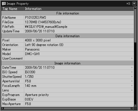

4.15.1. File information File information for the selected image file is displayed. Editing is not available for items in this category. Information related to the file format is displayed in "Character Information." Refer to this information when a selected image is not shown in the preview display, because information may be displayed if it is a format not supported by SILKYPIX ® or if the file is corrupted. 4.15.2. Data information "Edit Date and Time" displays the date and time of the latest edit by SILKYPIX. This is the edit date and time development parameter that SILKYPIX automatically records. It is not displayed for scenes that have not had development parameters edited or for initial development parameters. This is mainly information recorded in Exif information for RAW data and JPEG / TIFF images. Information related to the image and secondary information on the image is displayed here. 4.15.3. Image information "Comments" are items that can be edited. This is mainly information recorded in Exif information for RAW data and JPEG / TIFF images. Photographic information such as camera settings at the time the photograph was taken is displayed here. "Photograph Date and Time," "ISO Film Speed," "Shutter Speed," "Diaphragm Stop," "Focal Distance" and "Name of Lens Used" can be edited. You can freely edit items such as corrections to incorrect dates and times set on the camera or when photographic information is not correctly recorded such as when you use a manual lens. When recording to a developed JPEG / TIFF image, the "Name of Lens Used" is recorded in a standard format to XMP, while other information is recorded as Exif information. 4.15.4. IPTC Information is edited based on IPTC (International Press Telecommunications Council). If IPTC information is recorded to RAW data or JPEG / TIFF images under IPTC standards and/or XMP standards, it is displayed as initial values. If recorded to developed JPEG / TIFF images, it is recorded under a format based on both IPTC and XMP standards. 4.15.5. Editing Items Some image property items can be edited. Edited contents are reflected in additional information when saved to developed JPEG / TIFF images. Utilize this for corrections to image property recorded in RAW data, for adding unrecorded information or if not recorded as additional information when saving developed JPEG / TIFF images. Items that can be edited have one of the following icons displayed on the right side of "Information." Items that do not show an icon cannot be edited.
To edit an item that can be edited, place the mouse over the item and click on displayed on the left side, or double click on the "Information" cell. An edit item dialog will appear.4.15.6. Edit Item Dialog The contents of the edit item dialog edit item dialog may slightly differ depending on the image property item, but the following are common operations. 4.15.7. Datetime
Set optional item contents. The setting format may slightly differ depending on the type of item. Enter characters in the text box for characters. There are also some items for which you can choose values from a dropdown list. "Datetime" is a special case, so please refer to "4.15.7. Datetime."
If there are items that can be set with optional values, you can choose item contents from the edit history up set to that time. Use this if you set the same information repeatedly, such as IPTC information items and the name of your lens.
Return to unedited status.
