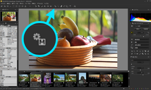

When you click the
icon on the “Development settings” sub-control or the toolbar, the “Save as” dialog is displayed.
You can specify the filename to save the developed image, and specify settings for saving.

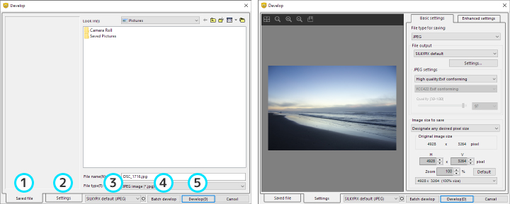

You can switch between “Saved file” and “Settings” pages in the “Develop” dialog.
When the “Saved file” tab is selected, you can designate the file folder, file name and file type for saving the development results.
When the “Settings” tab is selected, you can make settings for develop while looking at the preview display of the development results.
After confirming instructions for saving files and development settings, click on the “Develop” or “Batch develop” button and begin processing.
Saved file
This switches to the page for designating details of saved files.
You can designate the file folder, file name and type of file for saving the development results.Settings
Switch to the page for making settings for develop.
You can make settings for develop while looking at the preview display of the development results.Develop tastes
The status of “Develop” tastes will be displayed.
Registered tastes will be displayed when you open the list.
You can switch to develop settings from these tastes.Batch develop
Confirm set development instructions and register development processing to batch development as a job.
Registered jobs are processed as batch development. When job registration is complete, develop is closed, whether or not development processing has been completed and you can go to the next operation.Develop
Confirm set development instructions and begin real time development processing.
The status of processing is displayed on a progress bar until development processing is complete.
5.1.1. Saved File
This page is for designating files to be saved.
Select a location (= folder) for saving files and designate a file name for the file to be saved.
Select the type of file, either a JPEG image (*.jpg) or TIFF image (*.tif).
Please make detailed settings related to JPEG / TIFF images on the “Settings” page.
If there are file names marked for a job registered for batch development in a location (= folder) for saving files, those file names are displayed as marked file names.
When a file name marked here is designated, jobs registered for batch development are cancelled, and if that file already exists, it will be overwritten.
5.1.2. Settings
This page is for making settings for develop while looking at the preview display of saved results.
Settings here include many that have an influence on the developed image itself and on the quality of the image.
Confirm appropriate development instructions while checking the effects and influence on the preview display.

5.3. Settings for development and saving
Setting items common in both “Develop” and “Batch develop” are explained here.
5.3.1. Basic Settings
Basic settings differ slightly between “Develop” and “Batch develop”, but items that can be set in the same way will be explained.
5.3.1.1. File type for saving
From the drop down list, you can select JPEG or TIFF file. When you want to set this in detail, use the “File output settings” dialog as described below.
5.3.1.2. File output settings
By registering a setting status from “File output settings” that you often use as a taste, you can easily switch settings by selecting that taste.
You can also set JPEG and TIFF saving formats here.
There are many detailed setting items in “File output settings”.
Click on the “Setting details” button and open the “File output settings” dialog to make settings for all items.
Please see “9.1. File output settings” for details.
You can make detailed settings for both “JPEG” and “TIFF” by selecting “Type of saved file” here.
Items that can be set here are the same as the items that can be set with “Setting details”. Please see “9.1.2. Setting of File Type” for details.
5.3.1.3. Image size to save
You can specify the size in pixels of each developed image when you want to save an enlarged image or reduced image.
The methods for designating pixel size for resizing differ slightly between “Develop” and “Batch develop”.
You can record and save at an appropriate pixel size that meets the purposes of the image.
5.3.1.3.1. Fit to designated size
You can designate a size for the image to be saved and make settings so that you save it resized to the pixel size you designated.
Select “Fit to designated size” in “Image size to save”.
It will be saved at a pixel size within the restricted size that was designated.
This setting method can be set for both “Develop” and “Batch develop”.
When creating the picture for a slide show that are displayed on a particular display, you can specify a display size. For example, when you want to display images on a VGA display, you can specify the display size of 640x480.
By this setting, the developed image files are saved with the size of 640x480. Therefore, you do not need to adjust the image size at the slide show.
- [Adjust orientation of the above rectangle to the target aspect ratio]
When you check this setting, the specified size is automatically adjusted to match the orientation with the aspect ratio of the target image.
For example, when specifying 640x480 as size, the result size will be inscribed to 640x480 for the lateral image and it will be inscribed to 480x640 for the longitudinal image.
