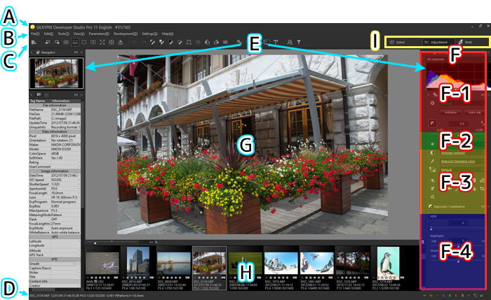

Main window
Various functions can be executed by clicking on icons in the toolbar. Icons also have the function of displaying status.(D) Status bar
Parameters controls comprises four parts.(F-1) Main control
The main functions are for selecting tastes prepared for each category of development parameters and for calling up sub-controls for adjusting parameters in detail.
Adjust exposure bias here.(F-2) Sub-control icon
This switches between displaying and not displaying sub-controls displayed as floating windows.(F-3) Tab page
Sub-controls for detailed adjustments in each category of the development parameters are displayed here.
The sub-controls displayed here can be changed through operations on the Main Control.(F-4) Control box
We recommend that you arrange sub-controls that you use frequently here. Please see “4.2. Sub-control” concerning sub-controls.
(G) Preview window
This window can be located outside of the main window and displayed as a floating window.(I) Section switching button
This button switches the contents of the main window according to the purpose of work.
Please see “0.2. Section” for information about section.
Floating window

0.1.4. Information Box
Each Information Box is divided into an upper and lower part. The “Navigator” and “Histogram” can be located in the upper part of the box.
In addition, the “Folder”, “Parameters controls” and “Image properties” can be located in the lower part of the box.

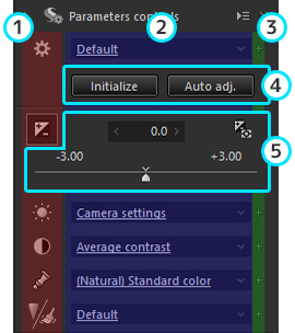

0.1.5. Parameters Controls
You can locate multiple controls within the box, or combine each control and locate them on a tab page or in a control box.
You can change the location of a control are performed from the Context Menu, displayed when you click on the upper right of the controls.
Icons for selecting category
Select sub-controls category displayed on tab page.Dropdown list for selecting taste
Initialize development parameters and automatically adjust images.Control for adjusting exposure bias
Adjust “exposure bias” and “exposure bias fine tune” parameters in the “Exposure / Luminance” category within development parameters. Select automatic exposure bias here.
Sub-controls for adjusting development parameters are displayed on the tab page by default, or as a floating window, with each category prepared separately. (*1)
Sub-controls can be located in the control box.

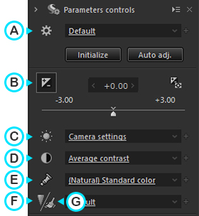

0.1.6.1. Category Selection Icons
Located in the Main Control part, the following sub-controls are displayed upon selecting the Category Selection Icon.
Furthermore, these sub-controls are located on the tab page by default.
If the development parameter on the sub-control has been modified, Icons will be colored like those to the right.
(A) Tastes/Parameters
Switch to “Tastes/Parameters” sub-control.
Tastes selected here are tastes for all categories of development parameters. There are two types of tastes, overall tastes and partial tastes.(B) Exposure / Luminance
Switch to “Exposure / Luminance” sub-control.
This category exists only in overall tastes, and there are no partial tastes.(C) White balance
Switch to “White balance” sub-control.
Tastes selected here are partial tastes in the “White balance” category.(D) Tone
Switch to “Tone” sub-control.
Tastes selected here are partial tastes in the “Tone” category.(E) Color
Switch to “Color” sub-control.
Tastes selected here are partial tastes in the “Color” category.(F) Sharpening
Switch to “Sharpening” sub-control.
Tastes selected here are partial tastes in the “Sharpening / Noise reduction” category.
“Sharpening” and “Noise reduction” exist as separate sub-controls, but they share the same development parameter.(G) Noise reduction
Switch to “Noise reduction” sub-control.

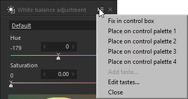

0.1.7. How to Locate Controls
A
icon is displayed to the upper right of most controls, such as Parameters controls and Sub-controls.
A context menu is displayed when you click on this menu, and you can change the location of controls from this menu.

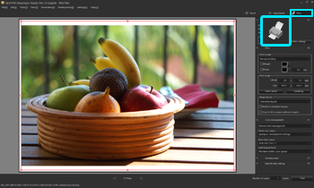

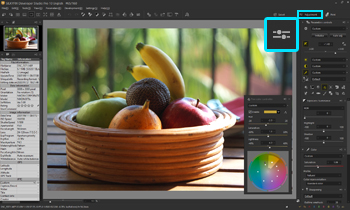

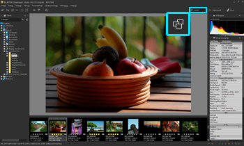

0.2. Section
The contents of the entire main window of the software can be switched to three modes depending on the purpose of work.
In this software, each mode is called a section.
The first time you start the software program, the select section is selected.

0.2.1. Select
The Select section is used to select photos that need adjustment from a large number of images.
Switch to the Select section by clicking the Select button on the toolbar or choosing [View]-[Select] from the menu.
In the Select section, you can use the functions related to image selection, such as file operations, marks and rating operations, and filtering images for processing, but you cannot use the functions related to image adjustment.
For more information on the Select section, see “2.1. Select”.
0.2.2. Adjustment
The Adjustment section is used to make adjustments to the image.
In the Adjustment section, you can also export the adjustment results to a file.
Switch to the Adjustment section by clicking the Adjustment button on the toolbar or choosing [View]-[Adjustment] from the menu.
Most operations related to adjusting and exporting images are based on operations in the Adjustments section.
0.2.3. Print
The Print section is used to print the selected images.
You can set the print settings while checking the print image on the main window.
Switch to the Print section by clicking the Print button on the toolbar.
Alternatively, select [File(F)]-[Print(P)] or [View(V)]-[Print] from the menu.
See “8.5. Printing” for details on the functions and operations of the Print section.
