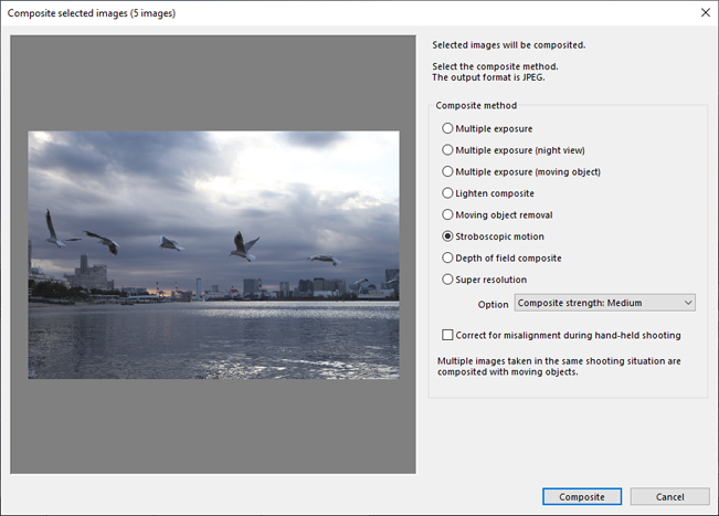

In addition, there is a “Composite selected images” function that composite images of multiple selections and saves them as a single DNG or TIFF images file.

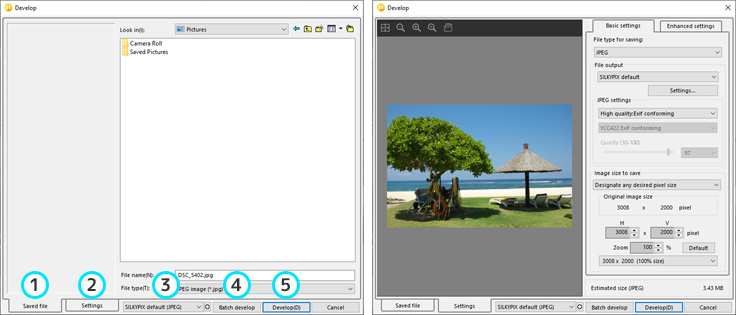

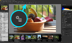

When you click the
icon on the “Development settings” sub-control or the toolbar, the “Save as” dialog is displayed.
You can specify the filename to save the developed image, and specify settings for saving.
You can switch between “Saved file” and “Settings” pages in the “Develop” dialog.
When the “Saved file” tab is selected, you can designate the file folder, file name and file type for saving the development results.
When the “Settings” tab is selected, you can make settings for develop while looking at the preview display of the development results.
After confirming instructions for saving files and development settings, click on the “Develop” or “Batch develop” button and begin processing.
Saved file
This switches to the page for designating details of saved files.
You can designate the file folder, file name and type of file for saving the development results.Settings
Switch to the page for making settings for develop.
You can make settings for develop while looking at the preview display of the development results.Develop tastes
The status of “Develop” tastes will be displayed.
Registered tastes will be displayed when you open the list.
You can switch to develop settings from these tastes.Batch develop
Confirm set development instructions and register development processing to batch development as a job.
Registered jobs are processed as batch development. When job registration is complete, develop is closed, whether or not development processing has been completed and you can go to the next operation.Develop
Confirm set development instructions and begin real time development processing.
The status of processing is displayed on a progress bar until development processing is complete.
5.1.1. Saved File
This page is for designating files to be saved.
Select a location (= folder) for saving files and designate a file name for the file to be saved.
You can only select a JPEG image (*.jpg) as the type of file.
Please make detailed settings related to JPEG images on the “Settings” page.
If there are file names marked for a job registered for batch development in a location (= folder) for saving files, those file names are displayed as marked file names.
When a file name marked here is designated, jobs registered for batch development are cancelled, and if that file already exists, it will be overwritten.
5.1.2. Settings
This page is for making settings for develop while looking at the preview display of saved results.
Settings here include many that have an influence on the developed image itself and on the quality of the image.
Confirm appropriate development instructions while checking the effects and influence on the preview display.

5.4. Composite selected images
“Composite selected images” is a function to composite selected images and save them as JPEG-format files.
“Composite selected images” dialog appears by clicking the
icon on the toolbar or by right-clicking the selected image on the thumbnail and selecting “Composite selected images” from the context menu that appears.
* This function is available only when multiple images are selected.
By selecting Composite method and clicking [Composite], you can composite the selected images.
As a condition for compositing, the pixel sizes of the output area of the selected image must all be the same.
If the cropping area is set, it is determined by the size of the pixels after cropping.
5.4.1. Composite method
Select Composite method as desired from the following modes:
Multiple exposure
Composited images are handled equally and result in an image similar to a multiple exposure shot taken with a camera.
If you composite two or more shots of the same scene, you can achieve much more sophistication and high dynamic range photography than normal Noise reduction.Multiple exposure (night view)
Images are composited with a focus on noise reduction, saturation, and black level for night views.
This mode allows you to create a long-exposure, beautiful night scene from multiple photos taken with hand-held shooting.
You can control the synthesis of dark areas with the optional Black level correction.
The stronger Black level correction, the less dark areas are raised or dust appears, but the lighter areas are darkened.- Option
- Black level correction: None
- Black level correction: Weak
- Black level correction: Medium (default)
- Black level correction: Strong
- Option
Multiple exposure (moving object)
Only the moving object in the representative image is left in the image to be composed, and the other parts are composed in the same way as in a normal multiple exposure.
By using this mode, moving objects will not be misaligned in the composite, and the other parts of the image will have the same noise reduction effect as with multiple exposures.Lighten composite
Selected images are compared and composited giving priority to the brighter parts of each image.
For example, if you composited an image of fireworks, you can make a photograph of large fireworks.Moving object removal
Multiple images taken in the same shooting situation are composited without moving objects.
For example, if you combine images of intersections where many people are walking, you can create a photograph of intersections where no one is walking.
You can control the removal intensity with Moving object removal options.
The stronger the removal intensity, the easier it is to remove the moving object, but the more unnatural dust is likely to appear.- Option
- Moving object removal: Weak
- Moving object removal: Medium (default)
- Option
Stroboscopic motion
Multiple images taken in the same shooting situation are composited with moving objects.
You can create a sequence photograph that expresses motion by continuously emitting strobes in the dark.
You can control the strength of the composite with “Composite strength” options.
The stronger the intensity, the more clearly the moving object is composite, but dust will be more likely to appear.- Option
- Composite strength: Weak
- Composite strength: Medium (default)
- Option
Depth of field composite
An image that is in focus over a wide area can be created by compositing images with different focus points from near to far.Super resolution
By expanding the pixel size of the selected image by a factor of 1.5 or 2, and then composing the image while aligning it, high-resolution images that cannot be obtained by simply overlaying multiple images can be output.
You can specify the output magnification of the composite result in the “Output magnification” option.
Normally, the larger the output magnification, the higher the resolution, but even at 1.5x, sufficient resolution can be obtained.- Option
- Output magnification: 1.5
- Output magnification: 2.0 (default)
- Option
* In this compositing method, “Correct for misalignment during hand-held shooting” is always enabled.
* This method can be used only when the pixel size of the selected images is smaller than 9000 pixels.
5.4.1.1. Correct for misalignment during hand-held shooting
When this checkbox is selected, alignment process is performed for images in which the position of the subject has shifted during hand-held shooting.
This function is based on the representative image and transforms other selected images to match the representative image as much as possible.
Depending on the image, the correction may not be performed successfully.
When correction cannot be performed, “Failed to correct misalignment. Images will be composited without performing alignment.” is displayed below the preview display, and compositing without correction is performed regardless of whether the checkbox is selected.
