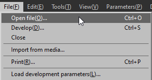

When you select [File (F)]-[Open File (O)] from the Menu, the “Open file” dialog will appear.
You can designate one or more image files for processing from the “Open file” dialog.
When selecting multiple image files for processing, do so while holding down either the [Shift] key or [Ctrl] key.
When the [Ctrl] key is pushed, the “Open (O)” button changes into an “Append (O)” button.
If adding, please click on the “Add and open (O)” button in this status.
If you click [Open (O)] button without clicking [Ctrl] key, the JPEG files is closed automatically which have been already loaded for processing.
And the JPEG files selected in this time is loaded instead of them.

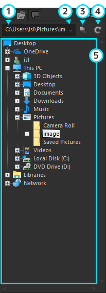

When you select [View (V)]-[Folder] from the Menu or click on the
icon, the “Folder” sub-control will be displayed in the Information Box.
Folder name edit box
The path for the selected folder is displayed. You can also edit these characters and designate a folder to open.“Select recent accessed folder” button
Designate a folder from the folder history. Please see “2.3.2. Selecting from folder history” for details.“Select subfolder” button
You can set whether subfolders will also be searched when reading. See “2.3.1.1. Load from Sub-folder” for details.“Update” button
This renews the folder display to the latest status. You can introduce media and reflect newly created folders on the display.Folders
Folders are displayed.
Select a folder by clicking on a folder. The selected folder is for new processing. Image files that had been processing to that time will be automatically closed. Also at that time, the selected folder will become the focus and the folder name will be circled.
If you hold down the [Ctrl] key and left click on a folder not on the focus, you can add that folder.
If you hold down the [Shift] key and left click on a folder not on the focus, you can select multiple folders that were left clicked while holding down the [Shift] from the folder of focus.
Additional folders cannot be designated subfolders. Only designated folders are referred.

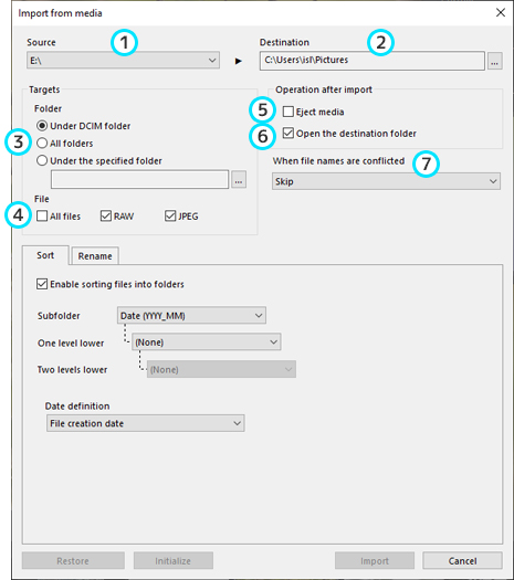

2.4. Import from media
After copying the image file from the SD card or other removable media to the PC, open it.
When SILKYPIX Developer Studio Pro11 is running and you insert media such as an SD card, the “Import from media” dialog will appear. (*)
If media has already been inserted, select [File]-[Import from media…]. or click the
icon on the toolbar
After making the following settings, click the [Import] button to copy the file from the source media.
* When the Print section is displayed, it is not available.
2.4.1. Basic settings
Source
Select the drive in which the source media is inserted.
Only removable disks are displayed.Destination
Specify the copy destination of the file.Folder
Specify the folder to be imported on the import source drive.Under DCIM folder
The target is in the “DCIM ” folder of the import source drive.
Images taken with a digital camera, etc. are usually recorded in the folder named “DCIM”, so select this when you want to target the entire shooting data.All folders
All folders on the drive specified in the import source are targeted.Under the specified folder
Target any folder on the import source drive.
File
Specify the file type to be imported.
If you select “All files”, in addition to RAW and JPEG, other types of files (video files, etc.) will also be imported.Eject media
After the import is complete, remove the removable media from the import source.Open the destination folder
After the import is complete, open the import destination folder.
If copied to multiple folders, the folder containing the last copied file will be opened.When file names are conflicted
Specify the processing when the same file name exists in the import destination
2.4.2. Sort
When the “Enable sorting files into folders” is checked, the program will create folders for the specified items and sort the corresponding images into them.
You can specify up to three levels of folders.
For example, let’s say you are importing SD cards that were taken between 2020/11/1 and 2020/12/31, and you specify Subfolder: “Date (YYYY)”, One level lower: “Date (MM)”, Two levels lower: “Date (DD)”.
In this case, folders “11” and “12” will be created under the “2020” folder, and folders “1”, “2”, and so on will be created under each folder for each date, and the images taken on each date will be copied.
As for the date, the date and time (Shooting date or File creation date) specified in “Date definition” will be applied.
If the specified item cannot be retrieved from the target file, a folder named “Unsorted” will be created and the item will be sorted into this folder.
