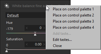

0.1.7. How to Locate Controls
By right-clicking on the title of most controls, such as parameter controls or sub-controls, a context menu is displayed, allowing you to change the placement of the controls from the menu.
0.1.7.1. Make it a floating window
By clicking the
icon in the upper right corner of a sub-control placed in the control box or control palette, you can switch to a floating window with a single click.

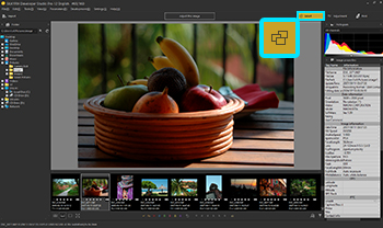

0.2. Section
The contents of the entire main window of the software can be switched to three modes depending on the purpose of work.
In this software, each mode is called a section.
The first time you start the software program, the select section is selected.
The next time you start up, it will start up with the section at the end selected.
However, if you exit with the Print section selected, the Select section is selected at startup.
The functions available in each section vary from section to section.
Unless otherwise noted, there are no differences between sections of the same function.
0.2.1. Select
The Select section is used to select photos that need adjustment from a large number of images.
Switch to the Select section by clicking the Select button on the top toolbar or choosing [View]-[Select] from the menu.
In the Select section, you can use the functions related to image selection, such as file operations, marks and rating operations, and filtering images for processing, but you cannot use the functions related to image adjustment.
For more information on the Select section, see “2.1. Select”.

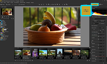

0.2.2. Adjustment
The Adjustment section is used to make adjustments to the image.
In the Adjustment section, you can also export the adjustment results to a file.
Switch to the Adjustment section by clicking the Adjustment button on the top toolbar or choosing [View]-[Adjustment] from the menu.
Most operations related to adjusting and exporting images are based on operations in the Adjustments section.

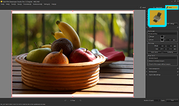

0.2.3. Print
The Print section is used to print the selected images.
You can set the print settings while checking the print image on the main window.
Switch to the Print section by clicking the Print button on the top toolbar.
Alternatively, select [File(F)]-[Print(P)] or [View(V)]-[Print] from the menu.
See “8.5. Printing” for details on the functions and operations of the Print section.
