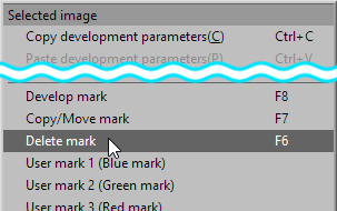

To reserve deletions, right click in either the thumbnail display or preview display, and select [Delete mark] from the context menu.

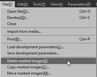

To delete multiple marked images for deletion together, select [Setting for marks] from the context menu.
The “Delete mark” is the reservation mark to delete. When you put this mark, the image will not be deleted at this moment.
After attaching the “Delete mark” to all of the images which you want to delete, the menu command [File (F)]-[Delete marked images (E)] throws away the marked images to the Trash box.
If you hold down the [Shift] key at the same time, files will not be moved to Trash box, but will be completely deleted.

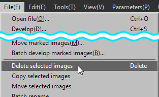

8.1.2. Delete selected images
After selecting all of the images which you want to delete, the menu command [File (F)]-[Delete selected images] or [Delete] key throws away the selected images to the Trash box.

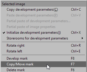

One method for copying or moving images to another folder is to first mark images with a mark that reserves them to be copied / move, and then copy / move the images marked for copying / moving all together.
Utilize this method if you are sorting images that may be for copying / moving.
The “Copy/Move mark” is the reservation mark to copy/move. When you put this mark, the image will not be copied/moved at this moment.

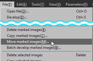

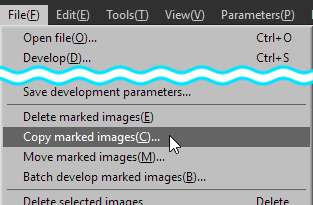

To move the marked images, execute [File (F)]-[Move marked images (M)] and then specify the folder into which the images are moved.
To copy the marked images, execute [File (F)]-[Copy marked images (C)] and then specify the folder into which the images are copied.

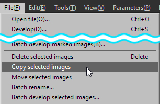

8.2.2. Copy/Move selected images
To copy/move the selected images, execute [File (F)]-[Copy selected image] or [Move selected image] and specify the folder into which the images are copied/moved.
Copying and moving selected images can be performed by dragging the selected thumbnail and dropping it into the “Folder” sub-control.

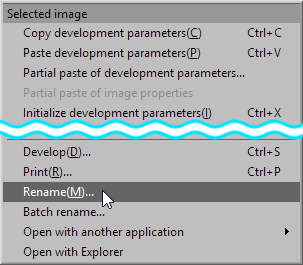

8.4.1. Rename
When an image is selected in the thumbnail mode, right click to display the context menu. Then select [Rename (M)] to display the “Rename” dialog.

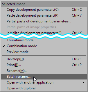

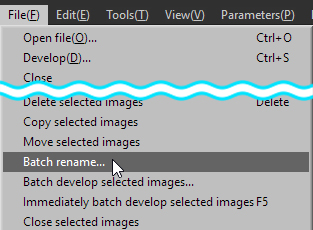

8.4.2. Batch rename

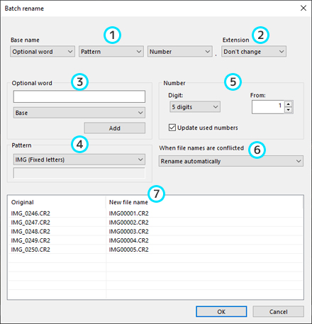

When some images are selected in the thumbnail mode or the combination mode, the menu [File (F)]-[Batch rename] displays the “Batch rename” dialog.
You can also display the “Batch rename” dialog by selecting [Batch rename] in the context menu. By inputting the base name that you want to use in this dialog, you can rename the files that have the same base name and exist in the same folder collectively.
After making the following settings, click [OK] to execute the batch renaming.
Base name
Set the naming convention for the base name of the file in combination from the following items:Optional word
Pattern
Number
Extension
Set whether to change the extension to uppercase or lowercase.Optional word
Specify any character string.
Specify the following items from the drop-down menu and click [Add] to insert the control characters(*) for renaming using the image information of the image to be renamed.- Base (%N) : “Base” means a part of filename expect the extension
- Focal-L (%L)
- F-Number (%F)
- Shutter-S (%T) : Shutter Speed
- Date (%Y%M%D)
- Time (%h%m%s)
- ISO (%I)
Pattern
Select from the prepared character strings.Number
Specify the number of digits in the serial number and the first number.
If “Update used numbers” is checked, the next number after the assigned sequential number will be set as the starting number when the dialog is displayed next time.When file names are conflicted
If the renamed file already exists, choose whether to automatically extend the filename or check each time.File name before and after renaming
The file name before renaming and the file name after renaming according to the naming convention are displayed.

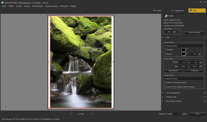

8.5. Printing
This function prints selected images on a printer.
This function has two printing formats, one is “Normal printing” that prints one image on one sheet, the other is “Contact sheet” that prints multiple images on one sheet.

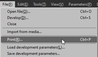

Select [File(F)]-[Print(P)] or [View(V)]-[Print] from the menu, or click the Print button on the top toolbar to display the print section.
Check the print image on the left and set the print settings with the controls on the right.

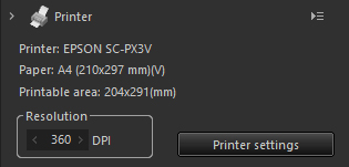

8.5.2. Printer
Resolution
SILKYPIX JPEG Photography 12 expands/reduces an image according to the print resolution, which is sent to the printer. If you set larger value, SILKYPIX JPEG Photography 12 makes larger image which is sent to the printer.
The larger value makes the better quality of printing but makes larger image data and required larger memory.Printer settings
When the “Printer settings” button is clicked, the OS standard the “Print Setup” dialog will be displayed.

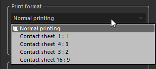

8.5.3.1. Print format
You can specify the print format. There are two different formats, one is “Normal printing” that prints one image on one sheet, and the other is “Contact sheet” that prints multiple images on one sheet.
If you select “Contact sheet”, you can select the aspect ratio of the frame for each image, which is 1:1, 4:3, 3:2, or 16:9.

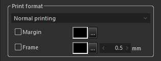

[Setting for Normal printing]
Margin
When this is checked, you can add a color to the margins of the printable area.
The “Color Selection” window opens when you click […] button.
After adjusting colors with the slider or color circle, the color is set when you click the [OK] button.Frame
When checked, you can attach a frame line to the image within the printing range frame.
After adjusting colors with the slider or color circle, when you click the [OK] button the color is determined.
Designate the size of the frame lines in mm units.

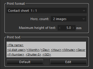

[Settings for contact sheets]
Number of Horizontal Count
When the contact sheet is selected, you can specify the number of images to be located on one horizontal line, the range is between 2-20 images.Maximum height of text
The character size is automatically adjusted to match the size of the printing area per image, but you can set an upper limit to the size here.Print text settings
Set texts located under the image.
Initial settings print in three rows as in the figure to the right: “Filename”; Date and time file shot or updated (“4 digit year,” “Month,” “Day,” “Hour,” “Minute,” “Second”), “F Number Shutter,” “Shutter Speed,” and “ISO speed.”Initialize
Return to the initial conditions of printing texts set by clicking on [Default] button.

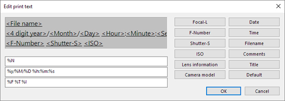

8.5.3.1.1. Editing print text
Open the “Edit print text” window and set text displayed on the contact sheet.
Click on [Edit] button and open the “Edit print text” window.
After clicking on the position which arranges items to be used in the edit box at the bottom left of the window, click the button for the item you will use.
The control characters for the item selected in (1) will be displayed in the edit box.
Control characters that can be displayed are as follows.[List of control characters]
%L : Focal Length
%F : F Number
%T : Sutter Speed
%I : ISO Speed
%l : Lens information
%c : Camera model
%Y : Date Time - Year (2 digit)
%y : Date Time - Year (4 digit)
%M : Date Time - Month
%D : Date Time - Day
%h : Date Time - Hour
%m : Date Time - Minute
%s : Date Time - Seconds
%n : Filename
%C : Comment
%t : Title
In addition to settings with item buttons, you can display character strings by inputting them directly in the edit box.
Click [Default] button to return to the default.
If the image contents for the print character string at the top of the edit box are correct, click the [OK] button.
If you click the [Cancel] button, you will return to the “Print” page without the new contents reflected.

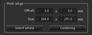

8.5.3.2. Print range
You can specify the print range if you select “Normal printing”.
Offset
Please specify the offset from the top left of the sheet.Size
Please specify the offset from the top left of the sheet.Select whole
It makes a print area the whole sheet.Centering
It puts a print area in the center in the sheet.

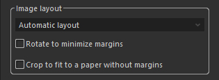

8.5.3.3. Image layout
8.5.3.3.1. Automatic layout
You can specify how to arrange the location of each image in the print area.
[Rotate to minimize margins]
If you enable this feature, the image is automatically rotated to minimize the borders.[Crop to fit to a paper without margins]

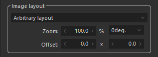

8.5.3.3.2. Arbitrary layout
[Operations on the preview image]
You can perform operations similar to “Zoom tool”.Offset adjustments
Drag and move the image.Adjust magnification
Adjust magnification with [Shift] key + dragging.

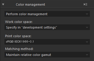

8.5.4. Color management
If you do not understand “Color management”, select “Color management on printer side” and select “sRGB” as the print color space.
Please refer to “10.2.4.5. Color management for print output” concerning color management.
8.5.4.1. Perform color management
If you print using this format, you must not make any color corrections on your printer.
Select a mode such as “No color corrections” and be sure to not perform any color conversions on your printer.
This is a method for quite easily performing color management on a PC environment in which you can choose an appropriate “print color space.”
Work color space
Choose either sRGB or Adobe RGB.Print color space
Display a list of color spaces (= color profiles) installed on your OS.
Select an appropriate color space from this list.
However, the print color space that can be used by SILKYPIX must be RGB.
Please note that color spaces other than RGB, such as CMYK, cannot be used. (*1)
Please use a profile created with special calibration tools or the like. (*2)
If a color profile is installed on Windows, select a color profile from Explorer, right click and open the context menu.
Select “Install Profile”.*1 Generally, the color space of color profiles offered by manufacturers of inkjet printers for home use is RGB, so you can use this without any problems.
*2 SILKYPIX uses the color management function installed in your OS to perform color management.
Therefore, SILKYPIX cannot use color profiles of a format not supported by your OS.
Please refer to “10.2.4.3. Color management performed on SILKYPIX” for details.Matching method
Printing photographic images generally uses “Perception” or “Maintain relative color gamut.”
Choose a matching method appropriate to the photograph’s hues and your aims.Perception
Perform color conversion that stresses the visual relationships of colors such as continuity of gradation and hues.
The absolute coordination of colors is changed, but it has a visually natural finished.Saturation
Perform color conversion that stresses saturation.
Choose this if your aim is to maintain high saturation more so than color reproduction.Maintain relative color gamut (Default setting)
This performs color conversion that maintains relative color relationships that stress hues and gradation.
Colors that cannot be found in the designated color space are adjusted to the closest colors that can be reproduced.Maintain absolute color gamut
This converts colors while maintaining the color’s absolute coordinates.
Colors that cannot be found in the designated color space are clipped. Choose this to express correct absolute colors.
8.5.4.2. Color management on printer side
Color management is performed by SILKYPIX even if this format is selected.
The SILKYPIX output is converted to the sRGB or Adobe RGB color space.
When you do not fully understand “Color management”
When you use the printer’s “Automatic correction” function or similar
When the color profile for the printer you use is not provided by the maker
When SILKYPIX is not compatible because the print color space on a special printer such as that for commercial use is something other than RGB
If you are not sure, choose “sRGB” from “Print color space.” (*1)
Be sure to make appropriate settings on your printer if the SILKYPIX print color space is set to “Adobe RGB.”
If the printer is set to “sRGB” and the SILKYPIX print color space is set to “Adobe RGB,” printed colors will be light.

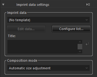

8.5.6. Imprint data
Creating “Imprint data” is required for imprinting a credit image you prepared.
Only JPEG and TIFF images can be selected as images to be imprinted.
Imprint data
Select which data for imprint data you will use.Edit data
Please refer to “9.8.1. Edit imprint data” for details.Configure list
Make settings of data for imprint data.
Please refer to “9.8. Imprint data settings” for details.Composition mode
Select which data for imprint data you will compose.
For printing and develop, select the appropriate composition mode while looking at the preview display.Automatic size adjustment
Resize the composed characters and image to meet the output printed image size.
Normally, this setting is used.Composite by the fixed-size
Compose keeping the designated size of the composed characters and image as is.
Edit data for imprint data if the position of the characters and image to be imprinted is not appropriate.Composite relative to paper
Composites an entire printable area of the paper while keeping the specified size of the characters or image to be composited.
Use this mode when you want to place text on the outside of the image to be printed.* This composite mode can be specified only when printing.
* When this composite mode is selected, the frame settings are disabled.
8.5.7. Set the number of copies and start printing
Specify the number of copies to be printed in “Number of copies” at the bottom right of the main window.
Click the [Print] button to start printing.
8.5.8. Print Preview of Multiple Images
If you select multiple images in the thumbnail mode or the combination mode, print output may be multiple pages.
In this case, you can switch the page with the button below the print image and check the print image in the preview display.

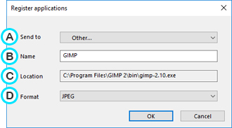

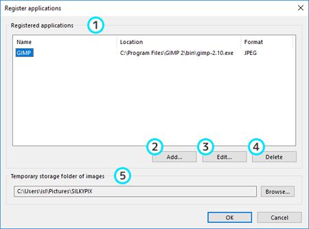

8.7.1. Register applications
The menu command [File (F)]-[Open with another application] displays the “Register applications” dialog.
You can also display the “Register applications” dialog from the context menu that is displayed by right-clicking on a preview or thumbnail, and the menu that is displayed by clicking the icon on the top toolbar.
Registered applications
A list of pre-registered applications is displayed.Add
Register a new application.Edit
Edit settings for a registered application.Delete
Delete the settings of a registered application.Temporary storage folder of images
Specify a folder to temporarily save development results when opening an image in another application.
The “SILKYPIX” folder under the “Picture” folder in each user folder is set by default.
Clicking [Add…] will display a dialog for specifying an application.
(A) Send to
Select any application from the list.
If no application is shown in the list, select “Other…” and specify an application (.exe file) directly.(B) Name
Set the name that will be shown in the list of registered applications.
The application name or file name selected in Send to will be set, so change it as needed.(C) Location
The pathname of the selected application will be shown.(D) Format
Select the file format in which to open a developed image in another application.
SILKYPIX JPEG Photography 12 is supported only JPEG output. (*)
* JPEG will be developed in Quality of 100.
