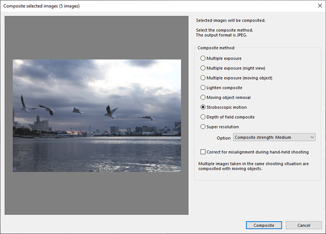

In addition, there is a “Composite selected images” function that composite images of multiple selections and saves them as a single DNG or TIFF images file.

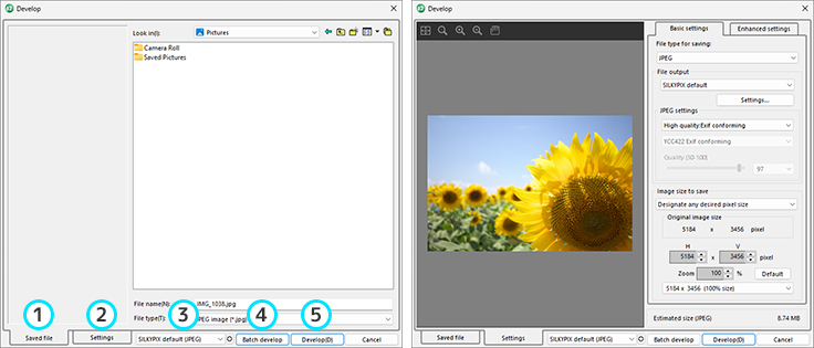

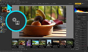

To perform “Develop,” select a single image and click the icon on the top toolbar to choose “Develop (S).” Alternatively, you can select “Develop (S)” from the [File (F)] menu or [Develop (D)] menu, or click the icon on the “Development settings” sub-control.
You can specify the filename to save the developed image, and specify settings for saving.
You can switch between “Saved file” and “Settings” pages in the “Develop” dialog.
When the “Saved file” tab is selected, you can designate the file folder, file name and file type for saving the development results.
When the “Settings” tab is selected, you can make settings for develop while looking at the preview display of the development results.
After confirming instructions for saving files and development settings, click on the “Develop” or “Batch develop” button and begin processing.
  1. Saved file
    This switches to the page for designating details of saved files.
    You can designate the file folder, file name and type of file for saving the development results.
  2. Settings
    Switch to the page for making settings for develop.
    You can make settings for develop while looking at the preview display of the development results.
  3. Develop tastes
    The status of “Develop” tastes will be displayed.
    Registered tastes will be displayed when you open the list.
    You can switch to develop settings from these tastes.
  4. Batch develop
    Confirm set development instructions and register development processing to batch development as a job.
    Registered jobs are processed as batch development. When job registration is complete, develop is closed, whether or not development processing has been completed and you can go to the next operation.
  5. Develop
    Confirm set development instructions and begin real time development processing.
    The status of processing is displayed on a progress bar until development processing is complete.

5.3. Settings for development and saving
Setting items common in both “Develop” and “Batch develop” are explained here.
5.3.1. Basic Settings
Basic settings differ slightly between “Develop” and “Batch develop”, but items that can be set in the same way will be explained.
5.3.1.1. File type for saving
From the drop down list, you can only select JPEG file. When you want to set this in detail, use the “File output settings” dialog as described below.
5.3.1.2. File output settings
By registering a setting status from “File output settings” that you often use as a taste, you can easily switch settings by selecting that taste.
You can also set JPEG saving formats here.
There are many detailed setting items in “File output settings”.
Click on the “Setting details” button and open the “File output settings” dialog to make settings for all items.
Please see “9.1. File output settings” for details.
You can make detailed settings for “JPEG” here.
Items that can be set here are the same as the items that can be set with “Setting details”. Please see “9.1.2. JPEG settings” for details.
5.3.1.3. Image size to save
You can specify the size in pixels of each developed image when you want to save an enlarged image or reduced image.
The methods for designating pixel size for resizing differ slightly between “Develop” and “Batch develop”.
You can record and save at an appropriate pixel size that meets the purposes of the image.
5.3.1.3.1. Fit to designated size
You can designate a size for the image to be saved and make settings so that you save it resized to the pixel size you designated.
Select “Fit to designated size” in “Image size to save”.
It will be saved at a pixel size within the restricted size that was designated.
This setting method can be set for both “Develop” and “Batch develop”.
When creating the picture for a slide show that are displayed on a particular display, you can specify a display size. For example, when you want to display images on a VGA display, you can specify the display size of 640x480.
By this setting, the developed image files are saved with the size of 640x480. Therefore, you do not need to adjust the image size at the slide show.
  • [Adjust orientation of the above rectangle to the target aspect ratio]
    When you check this setting, the specified size is automatically adjusted to match the orientation with the aspect ratio of the target image.
    For example, when specifying 640x480 as size, the result size will be inscribed to 640x480 for the lateral image and it will be inscribed to 480x640 for the longitudinal image.

5.4. Composite selected images
“Composite selected images” is a function to composite selected images and save them as JPEG-format files.
The “Composite selected images” dialog appears by clicking the icon on the top toolbar or by right-clicking the selected image on the thumbnail and selecting “Composite selected images” from the context menu that appears.
* This function is available only when multiple images are selected.
By selecting Composite method and clicking [Composite], you can composite the selected images.
As a condition for compositing, the pixel sizes of the output area of the selected image must all be the same.
If the cropping area is set, it is determined by the size of the pixels after cropping.
5.4.1. Composite method
Select Composite method as desired from the following modes:
  1. Multiple exposure
    Composited images are handled equally and result in an image similar to a multiple exposure shot taken with a camera.
    If you composite two or more shots of the same scene, you can achieve much more sophistication and high dynamic range photography than normal Noise reduction.
  2. Multiple exposure (night view)
    Images are composited with a focus on noise reduction, saturation, and black level for night views.
    This mode allows you to create a long-exposure, beautiful night scene from multiple photos taken with hand-held shooting.
    You can control the synthesis of dark areas with the optional Black level correction.
    The stronger Black level correction, the less dark areas are raised or dust appears, but the lighter areas are darkened.
    • Option
      • Black level correction: None
      • Black level correction: Weak
      • Black level correction: Medium (default)
      • Black level correction: Strong
  3. Multiple exposure (moving object)
    Only the moving object in the representative image is left in the image to be composed, and the other parts are composed in the same way as in a normal multiple exposure.
    By using this mode, moving objects will not be misaligned in the composite, and the other parts of the image will have the same noise reduction effect as with multiple exposures.
  4. Lighten composite
    Selected images are compared and composited giving priority to the brighter parts of each image.
    For example, if you composited an image of fireworks, you can make a photograph of large fireworks.
  5. Moving object removal
    Multiple images taken in the same shooting situation are composited without moving objects.
    For example, if you combine images of intersections where many people are walking, you can create a photograph of intersections where no one is walking.
    You can control the removal intensity with Moving object removal options.
    The stronger the removal intensity, the easier it is to remove the moving object, but the more unnatural dust is likely to appear.
    • Option
      • Moving object removal: Weak
      • Moving object removal: Medium (default)
  6. Stroboscopic motion
    Multiple images taken in the same shooting situation are composited with moving objects.
    You can create a sequence photograph that expresses motion by continuously emitting strobes in the dark.
    You can control the strength of the composite with “Composite strength” options.
    The stronger the intensity, the more clearly the moving object is composite, but dust will be more likely to appear.
    • Option
      • Composite strength: Weak
      • Composite strength: Medium (default)
  7. Depth of field composite
    An image that is in focus over a wide area can be created by compositing images with different focus points from near to far.
  8. Super resolution
    By expanding the pixel size of the selected image by a factor of 1.5 or 2, and then composing the image while aligning it, high-resolution images that cannot be obtained by simply overlaying multiple images can be output.
    You can specify the output magnification of the composite result in the “Output magnification” option.
    Normally, the larger the output magnification, the higher the resolution, but even at 1.5x, sufficient resolution can be obtained.
    • Option
      • Output magnification: 1.5
      • Output magnification: 2.0 (default)
    * In this compositing method, “Correct for misalignment during hand-held shooting” is always enabled.
    * This method can be used only when the pixel size of the selected images is smaller than 9000 pixels.
5.4.1.1. Correct for misalignment during hand-held shooting
When this checkbox is selected, alignment process is performed for images in which the position of the subject has shifted during hand-held shooting.
This function is based on the representative image and transforms other selected images to match the representative image as much as possible.
Depending on the image, the correction may not be performed successfully.
When correction cannot be performed, “Failed to correct misalignment. Images will be composited without performing alignment.” is displayed below the preview display, and compositing without correction is performed regardless of whether the checkbox is selected.
