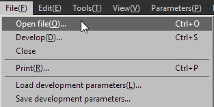

When you select [File (F)]-[Open File (O)] from the Menu, the “Open file” dialog will appear.
You can designate one or more image files for processing from the “Open file” dialog.
When selecting multiple image files for processing, do so while holding down either the [Shift] key or [Ctrl] key.
When the [Ctrl] key is pushed, the “Open (O)” button changes into an “Append (O)” button.
If adding, please click on the “Add and open (O)” button in this status.

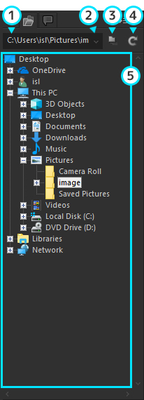

When you select [View (V)]-[Folder] from the Menu or click on the  icon, the “Folder” sub-control will be displayed in the Information Box.
- Folder name edit box
 The path for the selected folder is displayed. You can also edit these characters and designate a folder to open.
- “Select recent accessed folder” button
 Designate a folder from the folder history. Please see “2.2.2. Selecting from folder history” for details.
- “Select subfolder” button
 You can set whether subfolders will also be searched when reading. See “2.2.1.1. Load from Sub-folder” for details.
- “Update” button
 This renews the folder display to the latest status. You can introduce media and reflect newly created folders on the display.
- Folders
 Folders are displayed.
 Select a folder by clicking on a folder. The selected folder is for new processing. Image files that had been processing to that time will be automatically closed. Also at that time, the selected folder will become the focus and the folder name will be circled.
 If you hold down the [Ctrl] key and left click on a folder not on the focus, you can add that folder.
 If you hold down the [Shift] key and left click on a folder not on the focus, you can select multiple folders that were left clicked while holding down the [Shift] from the folder of focus.
 Additional folders cannot be designated subfolders. Only designated folders are referred.
 The background of the folder name for the folder with files currently being read is white.
 In addition, when you add an image for processing to a single folder that has been selected, the “Hot folder” function for adding thumbnails will automatically turn ON.
 Please see “4.1.2.2. Hot folder” concerning the “Hot folder” function.
