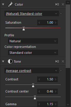

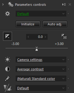

4.1. “Parameters Controls” and “Sub-control”
The GUI for setting each parameter is located in the Main Controls part at the top of Parameters Controls.
GUIs in the Main Controls are placed in the following order from the upside.
- Tastes/Parameters
- (Dropdown list + Select button + Parameter adjustment button)
- Exposure / Luminance
- (Slider control + Select button + “Automatic exposure bias” button)
- White balance
- (Dropdown list + Select button)
- Tone
- Color
- Sharpening/Noise reduction
On the bottom area of the “Parameters controls”, sub-control icons to switch sub-controls for adjustment of the development parameter are located.
The dropdown list is the GUI for selecting a taste (=preset value) that is prepared in advance by ISL (Ichikawa Soft Laboratory) or a user.
The “taste” is a value consisting of development parameters. For more details about the “taste”, please refer to ‘4.1.1 Taste’.
When you select a taste from the dropdown list, the related sub-controls automatically appear on the “Tab page”. However, according to customer’s preference, the sub-controls can be located on the “Control box” or a floating window.

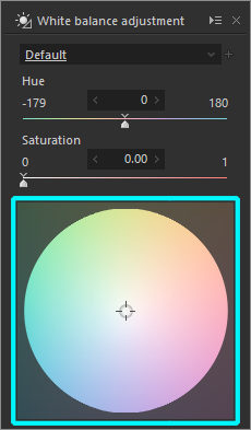

- [White Balance Taste]
- [Tone Taste]
- [Color Taste]
- [Sharpening/Noise Reduction Taste]
When the sub-controls “White balance”, “Tone”, “Color”, “Sharpening” and “Noise reduction” are displayed as floating windows, these dropdown lists will have the following in common with dropdown lists located at the top of each sub-control.
[Target parameter category]
These dropdown lists are used to select partial tastes for only one parameter category.
If a taste other than “All category taste” located in the main control section is selected from a dropdown list, only development parameters that can be adjusted by the sub-control displayed on the tab page will be influenced.
If a taste is selected from these dropdown lists located at the top of the sub-control, only the development parameter that can be adjusted by the same sub-control (*1) will be influenced.*1 “Sharpening” and “Noise reduction” sub-controls are an exception. Its sub-controls are divided to two parts despite one parameter category.

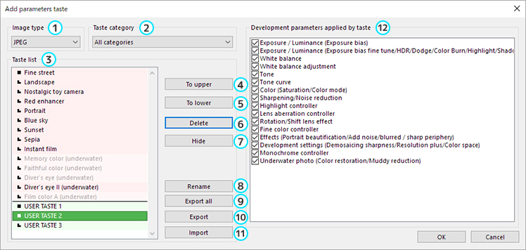

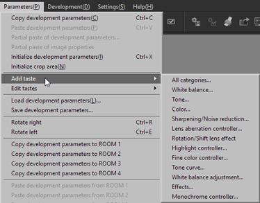

4.1.1.3. Add taste
You can add / register a development parameter applied to a currently selected image as a taste.
There are two ways to add / register a taste.
Select [Taste category] from [Parameters (P)]-[Add taste] on the menu, or click on the
icon located on the right side of the dropdown list.
The “Add parameters taste” dialog will be displayed.
The “Add parameters taste” dialog format is the same as the “Edit parameters tastes” dialog.
Please see the next section, “4.1.1.4. Edit tastes” concerning operation methods for this dialog.
“Tastes” added through the “Add parameters taste” dialog will be displayed in dialogs as selected, so set an appropriate name for the taste and click on the [OK] button to confirm.
Items set in the “Add parameters taste” dialog
Taste name
By default, names are set sequentially, such as “User taste 1.”
Change to an appropriate name to make it easy to distinguish from other tastes.Applicable development parameter category
If “Taste category” is added as a taste other than “All categories,” it is not necessary to edit because “Applicable development parameter category” is fixed to one category.
If the “Taste category” is “All categories,” you can enable any category in “Applicable development parameter category.”
Enabled categories are set as taste masks.
You can edit registered tastes.
You can customize by changing taste names and the order they are displayed to make it easier to select tastes.
You can also save / restore tastes and move then to other PCs through export and import functions
“Add parameters taste” is performed from [Parameters (P)]-[Edit tastes]-[Parameters tastes] on the menu.
Subject data
A taste is only defined for a “JPEG”.Taste category
A taste is defined for each parameter category.List of tastes
There is a list of tastes with a mark.- A mark at the left of a taste title:
The taste represents all development parameters if you select taste category “All parameters”.
The taste only part of the parameters if you select taste category “All parameters”.
There are two kinds of tastes, maker tastes created in advance by our company, and user tastes that you create. - Maker taste
These are displayed with a red background.
They cannot be deleted, exported or moved. - User taste
These are displayed with a green background.
Upward button
The upward button moves a selected taste upward.Downward button
The downward button moves a selected taste downward.Delete button
The Delete button deletes selected tastes.
Maker tastes cannot be deleted.Hide / Show button
Selected data is hidden.
Maker data cannot be deleted, but they will not be displayed on the list of tastes with this setting.Rename
Change the name of selected tastes.Export all button
All user tastes that have “Image type” and “Taste category” in common are recorded and saved in a file.
All tastes displayed with a green background are “Taste list”.Export button
The export button exports a single selected taste.Import button
The import button imports a saved taste.Development parameters applied by taste
When you select the “All parameters” in the list of the taste category, you can apply any of the parameter categories to a taste. For example, you can apply “tone” and “tone curve” to a taste.
When you add a new taste, the “Edit parameters tastes” dialog is also displayed and you can customize a name of a new taste and other settings as well as the taste customizing.

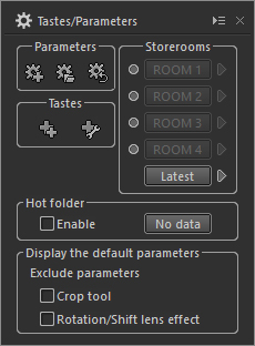

4.1.2. Tastes/Parameters
You can perform taste registration and editing, save development parameters, read, initialize and temporarily register in the “Tastes/Parameters” sub-control.
4.1.2.1. Storerooms
The “Storerooms” is a function that temporarily records development parameters.
There are four rooms (ROOM 1-4) in which you can record development parameters. There is also a special room named “Latest”.
You can record optional development parameters in the first four rooms.
Development parameters for the currently selected image are recorded in a room by clicking the o button on the left side.
When development parameters are recorded in a room, the time they were recorded is displayed.
Rooms with recorded development parameters are turned into buttons, and when you click this button, the development parameters recorded in the room are pasted onto the currently selected image.
In this way, you can copy development parameters from other images and past development parameters from the same image.
Rooms with recorded development parameters that match the development parameters of the currently selected image are displayed in bold.
The
icon on the right side is a button for entering “Continuous paste tool”.
“Continuous paste tool” is a mode for pasting development parameters recorded in a room to multiple images. Click on a scene in the thumbnail display to paste development parameters.
In order to leave this tool, click on the
icon again.
The special room, “Latest”, located at the bottom always stores the latest edited development parameters.
Use this when you want to paste the latest results from adjusted development parameters to other images.
There are several convenient ways to use the “Storerooms”.
Please see “6.5. How to Use Storerooms” for details.
4.1.2.2. Hot folder
“Hot folder” is a function for monitoring a selected folder and automatically adding images to thumbnails if an image for processing is added.
This function can be used only when a single folder is selected.
By clicking on a button reading “No data” within the border of the “Hot folder”, the development parameter of the selected image will be registered and a check will appear in the check box next to “Enable”.
While “Enable” is checked, images to which registered development parameters are applied are automatically added.
The check next to “Enable” is automatically removed when the selected folder is changed.
4.1.2.3. Display the default parameters
Make settings for the “Display the image with default parameters while holding down” button.
Please refer to “3.2.3. Displays of images with default parameters by mouse operations” for information about this function.
4.1.3. Parameter adjustment buttons
“Initialize” and “Auto adjustment” buttons are located under “All category tastes”.
4.1.3.1. Initialize
Reset the development parameters of selected images to default.
If default parameters are set, the default parameters will be applied.
Please refer to “7.4. Initialize Development Parameters” for details.
4.1.3.2. Auto adjustment
The “Auto adjustment” button adjusts to the optimal exposure, white balance, and level correction for SILKYPIX all at once.
Clicking the “Auto adjustment” button will perform the following adjustments in order for the selected images.
For auto white balance, “Auto (Natural)” will be set.
Automatic level correction will be performed on the “RGB” channel.
Further adjustments can also be made to parameters after performing auto adjustment.
Please use this function according to each situation.

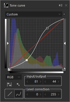

| (B) - (2) | Tone curve |
| (A) - (1) | Color |

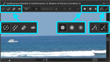

| (C) - (2) | Spotting tools |

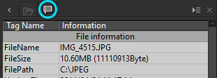

| (D) - (4) | Image properties |

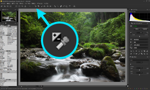

4.3.1.4. Exposure bias tool

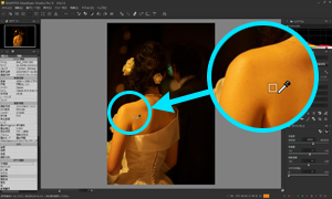

Exposure bias tool allows you to adjust the brightness of a specified point to a certain exposure level.
To adjust exposure level, you select “Exposure bias tool” from the menu [Tools (T)]-[Exposure bias tool], or click
on the toolbar.
When you designate an area by either clicking or dragging on a preview image or thumbnail of a selected image, “Exposure bias tool” adjusts the brightness of the selected area to become the “luminance level”.
You can change the “luminance level” in the “Function settings” dialog.
Please refer to ‘9.3.1.2. Luminance level of exp. bias tool’ for more details.
This function works effectively even when a specified point is not achromatic color. In that case, the largest value of R, G, or B is selected as a target value and the exposure is set to the “luminance level”.
For example, when you click the red area, this feature sets an “exposure bias” such that the R value becomes the “luminance level”.
* About eyedropper operation, please refer to ‘9.3.2. Operations’.

4.4. White Balance
White balance is the function to adjust white color.
Human eyes adjust to ambient light color. We perceive the white color of an object as the same under sunlight, tungsten lamps, and fluorescent lamps. However, digital cameras, “white” under sunlight can be recorded as white, while white under tungsten lamps are recorded as a reddish white, similarly fluorescent lamps are recorded as greenish or bluish white. What provides compensation for these color shifts is “white balance”.
White balance adjustments vastly change colors in photos. A white object in the photo can be expressed most accurately and naturally with this function. In other words, the basic concept of white balance is the method of expressing white as white, irrelevant of color tint.
However, it is not always true for all types of scenes.
For example, if a white object in evening glow is expressed as a clean white, you will not be able to perceive this as sunset scene. If you want to produce a melancholy mood on your picture in a cloudy sky, it may be appropriate to add a blueish tint.
Although most cameras today can automatically adjust the white balance, it is not always accurate and even if it is correct, the result is not always what you intend. Therefore, it becomes necessary to adjust the white balance according to your artistic expression. However, it is very difficult to select and correct the white balance when taking a picture.
For these scenes, you can freely modify white balance accordingly, during the development process.
4.4.1. Adjusting White Balance with Taste
This is the way to make adjustment by selecting maker tastes for the auto white balance or user tastes. Select a taste that specifies a light source in the dropdown list of “white balance”.
You can also change settings in detail later, so it is convenient to select the light source first.
The preset items displayed in the dropdown list may be different for each type of camera.
There are “taste” that are prepared in the dropdown list of “white balance”, which execute auto white balance.
Auto (Absolute)
This automatically determines a suitable white balance. It automatically makes adjustments to cancel out color from the light source and color cast.Auto (Natural)
This automatically sets an appropriate white balance. It automatically adjusts in order to perceptually reproduce the atmosphere of the light source color. It is effective for retaining the color tone of the light source without completely correcting color cast from the light source color.Auto (Underwater)
This automatically sets an appropriate white balance. It automatically adjusts in order to remove blueness from the underwater photograph.
4.4.2. Auto White Balance
If “Auto (Absolute)” / “Auto (Natural)” is set in white balance, it will analyze the image and automatically adjust to a suitable white balance.
Don’t worry. You can use the “auto white balance” function, which expresses a light source color in white automatically.
The method and logic of “auto white balance” of SILKYPIX is fundamentally different from “auto white balance” in cameras. And it allows very accurate detection of the white balance of high color saturation or an object having no white area, which typical “auto white balance” function cannot handle well.
There is no correct white balance.
Only “you,” the one taking the picture, can make this determination based on what you want the photograph to express.
However, if many photographs are being developed, setting an appropriate white balance for each photograph would be a lot of work.
You can utilize Auto White Balance as a step for efficiently determining the white balance in many photographs.
Expressing white things in white is the basis of white balance.
Ultimately, when you adjust white balance for effective production, it would be best to start your work by first adjusting to an appropriate white balance so that white things are shown as white.
If you use Auto White Balance, most photographs will be automatically adjusted to an appropriate white balance, so if you are making adjustments to many photographs, first try using Auto White Balance to improve the efficiency of your work.
There are two types of auto white balance: “Auto (Absolute)” and “Auto (Natural)”.
“Auto (Absolute)” automatically makes adjustments in order to eliminate color casting from the light source color as much as possible.
“Auto (Natural)” automatically makes adjustments in order to perceptually reproduce the atmosphere of the light source color. It is effective for retaining the color tone of the light source without completely correcting color cast from the light source color.
4.4.3. Color Temperature and Color Deflection
This is the way to adjust the white balance by specifying the color temperature.
There is a “color temperature” adjustment slider on the “White balance” sub-control.
Move this slider to find the point where colors of the object are well balanced.
When the color of the object is reddish or yellowish, move the slider to decrease the color temperature.
When the color of the object is bluish, move the slider to increase the color temperature.
The “Color deflection” slider is used to remove color casts. Before using it, adjust the color temperature first.
When the color of the object appears greenish, move the slider to the + side.
When the color of the object appears magenta, move the slider to the - side.
* Refer to ‘10.2.1. Color Temperature and Color Deflection’ for your information.

4.4.5. Skin color tool
This is a tool for adjusting the skin of a person appearing in the photograph to an “expected pretty skin color”.
You can switch to “Skin color tool” with the
button on the “white balance” sub-control, or menu command [Tools (T)]-[Skin color tool].
In the “Skin color tool” mode, you can click or drag a rectangle area at the target skin on the preview, then the target area is automatically adjusted to beautiful skin color and also exposure bias is adjusted.
This tool is used at the same time as adjusting white balance and exposure bias.
There are times when adjusting skin color does not change as expected with one operation.
If the result is too red, green, or blue, please click that area again. By a few repeatable operations, you can find out the suitable skin color.
Then you can additionally adjust “White balance adjustment”, “Exp. bias fine tune”, or “Tone” for fine-tuning.
If you use this tool on the woman’s face, please avoid the emphasized make-up area. Basic foundation area, especially dull color area is suitable for picking up,
* To adjust skin color continuously, you need to check “Enable Continuous Operation of Eyedropper Tool” on the “Function settings” dialog. Please refer to “9.3.2. Operations” for detail.

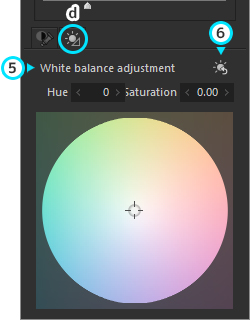

4.4.9. White Balance Adjustment
The menu command [View (V)]-[Sub-controls]-[White balance adjustment] displays the “White balance adjustment” sub-control.
Use this function when you want to adjust the white balance at the final stage of your workflow e.g. tinting
You can adjust white balance in detail with this sub-control, which has a “white balance target” graphic control, a “saturation” slider, and a “hue” slider.
White balance target
This graphic control is based on the accurate color space. You can set the white balance visually by clicking a mouse directly.- [Mouse wheel operation]
You can change “saturation” parameter with the mouse wheel on the white balance target.
And with [Shift] key, you can change “hue” parameter.

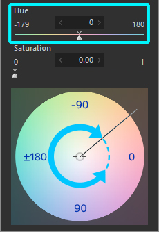

“Hue” slider
It shows the angle from the right hand side of the white balance target in clockwise. Move the slider to change the angle in detail.
You can specify the setting value indicates:- 0
right from the center - 90
downward from the center - 180
(-180)
left from the center - -90
upward from the center - +
lower half from the center - -
upper half from the center
- 0
“Saturation” slider
It shows the radius from the center of the white balance target. Move the slider to change the radius in detail. The range is 0.00 to 1.00 (0.00 is the center of the white balance target, 1.00 is the maximum radius).

4.5. Tone
Tone adjustment parameter adjusts the contrast, high or low.
Use the “Tone curve” for making minute adjustments after you finish adjusting other biases.
4.5.1. Adjusting Tone with Taste
Select a taste from the dropdown list of “Tone”.
Tones in incremental steps from Low to Strongest are included as maker tastes.
“Average contrast” is the SILKYPIX default setting. “Average contrast” is a higher contrast than that obtained using sRGB and Adobe RGB standard tone curves, and is set to improve the overall appearance of an image.
Setting to “Standard” will give similar contrast levels to sRGB and Adobe RGB standard tone curves.
4.5.2. Fine-Tuning Tone
“Tone” adjustment can also be made to “Contrast”, “Contrast center”, “Gamma”, and “Black level”.
Clarity and Dehaze can also be adjusted.
Contrast
Contrast means the difference between bright area and dark area.
When increasing the contrast, the bright area becomes brighter and the dark area becomes darker, i.e. high contrast.
On the contrary, when decreasing the contrast, difference between the bright area and dark area becomes smaller, i.e. low contrast.Contrast center
This is the reference to judge the brightness when adjusting the contrast. Upper levers from the contrast center are considered bright, and lower levels are considered dark. In other words, this reference decides the point where the brightness level is not changed when adjusting the contrast.
When setting the contrast center smaller, the tone of an image becomes lighter.
This is because the contrast is increased based on the dark area, and causes the dark area to become smaller and the bright area larger.
For example, by strengthening the contrast, “Bright areas” become brighter and “Dark areas” become darker, but “Mid contrast” is the midpoint between “Bright areas” and “Dark areas,” and there will be no influence on contrast.
When setting the contrast center larger, the tone of the image becomes darker.
While, setting the contrast center smaller, the tone of the image becomes brighter with the mid contrast level expanding.
Therefore, if a target object is dark, set the contrast center smaller, and if it is bright, set the contrast center larger to obtain an ideal tone.- [Utilizing Histogram]
Mid contrast is displayed with the
mark at the bottom of the histogram.
The brightness of R, G, B where the mouse cursor is pointed to on the preview display is also displayed here.
When you use this function to adjust while looking at brightness distribution on parts you want to use contrast, you can find the optimal value relatively easily.
Gamma
Gamma is a brightness adjustment. As the gamma increases, the overall brightness becomes higher, and vice versa.
You may think it is the same as exposure bias operation, however, they are not the same thing.
With the exposure bias, the brightness is adjusted without changing the ratio of bright range and dark range . However, with gamma, the ratio is changed.
When increasing the gamma value, the bright range is compressed, and the dark range is expanded.
When decreasing the gamma value, the dark range is compressed and the bright range is expanded.
Therefore, in this software, this operation is considered as a tone-change-operation and classified as ‘Tone Adjustment’ since it changes tone.Black level
Black level controls create clarity of the dark areas.
You can specify the level of black with this function. When increasing this parameter, the color black becomes deeper black. This function works effectively when a picture is taken against the sun and the image becomes unimpressive, or when a landscape image becomes washed out, or when a landscape image becomes obscured or influenced by haze.Clarity
Clarity adjusts the fine texture of the subject.
If you increase clarity, you can refine the details of the subject more clearly, so if you want to revive the texture of a sleepy landscape photograph as a whole, this will have that effect.
In addition, if you lower clarity, you can finish with a soft focus and atmosphere such as with portraits of women and children or macro image.
Dehaze
Dehaze restores and emphasizes the lost saturation in hazy areas due to dust.
Increasing the level of Dehaze will remove hazy areas and produce clear images.
Show tone on “Tone curve”
By placing a check next to ‘Show tone on “Tone curve”’, you can display the status of adjustments here in a graph in the “Tone curve” sub-control.
By adjusting the “Tone” parameter when displayed as a graph in the tone curve, you can visually confirm the parameter status in the graph.
Displaying the “Tone” graph can also be useful when making further minute adjustments on the “Tone curve”.

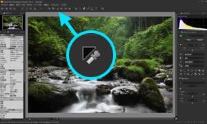

4.5.2.1. Black level tool
This tool designates and sets the black level on designated points or areas.
Enter “Black level tool” mode through either [Tools (T)] - [Black level tool] from the menu or with the
icon on the toolbar.
When you designate an area by either clicking or dragging on a preview image or thumbnail of a selected image, the black level will be adjusted on that area to the set brightness level.
You can set the brightness level at “Function settings”. Please see “9.3.1.3. Luminance level of the black level tool” for details.

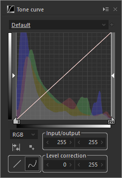

4.5.3. Tone Curve
The “Tone curve” is a tool for making minute adjustments to tone expression after completing adjustments to other biases and for converting brightness for effect.
The menu command [View (V)]-[Sub-controls]-[Tone curve (T)] displays the “Tone curve” sub-control.
You can also display it using the sub-control icon “Tone curve” button.
Bias from the “Tone curve” is reflected after other bias processing is performed and converted to the color space on the output color space of development settings.
Therefore, for example, if you set monochrome to color, when you adjust R, G and B separately on the Tone curve, this will not be monochrome, or if you change the output color space in the development settings, you will have to make readjustments to match the color space. Keep this point in mind when you use this.
You can set the curve (= Tone curve) that converts brightness on this sub-control.
The horizontal axis means input (brightness of source picture) and the vertical axis means output (brightness results of a picture after adjustment). You can control lightness in a picture by operating this curve.
* By dragging window’s frame of the “Tone curve” sub-control, you can adjust a size of the dialog.
In addition, by dragging it while pressing the Shift key, you can adjust the size while fixing the aspect ratio of it.
4.5.3.1. Selecting a Taste
Several tastes that have good effects are included as Maker Tastes in tastes.
There are also special items such as “Initialize” and “Initialize all” within the tastes of the tone curve.
“Initialize” initializes only the tone curve of the selected channel (all RGB, R, G, B or L), while “Initialize all” initializes all five tone curves.
4.5.3.2. Editing Points
The curve is drawn as passing through a point, and you can operate the curve by moving the point.
Selected point information is displayed on the “Input / Output” control.
You can move the point by editing the value in this control or by dragging the point on the tone curve.
Adding Point
Click the mouse on a graph to place a point at the position.
You can also click
to switch to a mode that will add a point to the tone curve and add a point from the preview display.Selecting a point
Select a point for operations.
The selected point is displayed with
You can switch selections by clicking the point with the mouse.Moving Point
You can move the composition point by either dragging the selected composition point on the graph or by changing the coordinate value of the composition point shown in the “Input/output” control.Deleting Point
Move and right-click the mouse on the target point to delete.
In addition, you can delete the current point by pressing the
4.5.3.3. Control explanation
Channel selection
Select a channel for processing.
The process is reflected in order of tone curve settings for each R, G, B, and L first and then tone curve setting for RGB.RGB
Set gradation process for all RGB values with the tone curve.R
Set gradation process for R value with the tone curve.G
Set gradation process for G value with the tone curve.B
Set gradation process for B value with the tone curve.L
Set gradation process for L (Luminance) value with the tone curve.
* When changing tones, colors are changed with brightness on tone curves combined with general RGB channels.
Because you can adjust only the tone of brightness with the L tone curve, color omissions and changes in chroma are decreased, even when using high key or high contrast, for example.Add point
Switch to a mode for adding a point to the tone curve.
The point clicked on the preview display adds a point to the tone curve.
By clicking the point while pressing the Ctrl key, you can add a point on all tone curves of RGB, R, G, B, and L.Linear
Create a tone curve at the interpolation of a straight line between points.Curve
Create a tone curve at the interpolation of a curved line between points.Input / output
Edit selected point coordinates.Level correction
Edit input range of level correction.Automatic level correction
This is a function that automatically adjusts level correction on the currently selected channel.
It recognizes the image’s histogram and adjusts the level correction so that shadows and highlights are to the set ratio.
Ratios of shadows and highlights can be set at “Function settings”.
Please see “9.3.1.7. Set automatic level correction” for details.* The “Add point” function works only when the tone curve is monotone increase or monotone decrease.
[How to use “Add point” function]
Click “Add point” button to add the target tone point on the tone curve.Select the target image on the preview window.
Display the “Tone curve” sub-control and click on the “Add point” button.
Switch to a mode to add a point on the tone curve.Click the target point on the preview image.
Then the target point is added on the tone curve.
Move the point and adjust the tone curve.
Moving the point edits the coordinate value by dragging the point on the tone curve or with the “Input / Output” control.Then the tone curve that you adjusted is applied to the target image.

Color representation determine the direction of color reproduction. You can select it from the “Color representation” drop list in the “Color” sub-control. The following are categories of color representations: “Standard color,” “Memory color,” “Portrait color,” “Film color” and “Monochrome.”
4.6.4.1. Standard color
This mode provides the original color of JPEG image.
4.6.4.2. Memory color
True colors in photo are not always “beautiful colors.”
It is common knowledge that colors in our memory, or colors of an object that we perceive are different from actual colors. Although they differ in individuals, we can see a trend and directional characteristic.
We consider the picture “beautiful” when colors in our memory or colors we perceive are printed in the photo.
This mode creates colors of perception.
Although the directional character is different for each color, in short, saturation tends to be higher than the “Standard color” mode.
This mode provides “beautiful colors” for many scenes, but colors of some objects with high saturation such as flowers become too vivid and over saturated.
In such case, adjust with ‘4.10. Fine Color Controller’, set lower saturation level or lower development gain to correct the conflicting color.
Memory Color 1 reproduces colors equivalent to “Memory Color” in previous versions of SILKYPIX Developer Studio Pro. Memory color 2 provides a humanistic touch of memory color with a new color reproduction technology called “3-dimentional color mapping method.”
Select the mode, as you like.
* When decreasing the development gain to express dark images, it becomes easier to reproduce the color of object with high saturation. This is because most display screens and printers are not good at outputting high saturation and brightness simultaneously.
This mode is not effective in portrait photography.
Skin tones, or oranges, are often over saturated. This allows for high expressions in this mode, but as for skin tones, there are many cases in which neither the subjects nor the photographer like this over saturation.
If you want more beautiful skin colors, select the “Portrait color” expression.
4.6.4.3. Portrait color
With pictures of people, you can create “pleasing skin tones” by creating more natural skin colors at the expense of accurate and neutral color reproduction.
Portrait color mode is a color reproduction which emphasizes skin tones and is better suited to photographing people.
Skin color is easily effected by different lighting sources. More specifically, luminosity, saturation and hue of skin are all effected under different the light source.
In this mode, overall saturation is reduced with luminosity being given to skin tones. Colors which are distant from skin tones are slightly effected because of the necessity to achieve greater skin tone balance.
In “Standard color” mode, when you require “pleasing and expected colors” by adjusting the white balance, the color balance in parts other than skin may easily be effected or break up. However, in this mode, colors close to skin tones are reproduced as accurately much as possible and are adjusted to obtain a normal white balance. Therefore, when used on portraits, both a natural background and pleasing skin tones are easy to achieve.
Female skin tones were mainly use as a reference in the development of this mode.
This emphasis in “expected” colors are especially strong in women, while men portraits seem to render better with tanned healthy colors (tinted slightly with yellow).
Therefore, the portrait mode may not be appropriate for male portraits if one wishes to use this for natural skin tones or brownish skin tones.
When this mode is not appropriate for your picture, use the “Standard color.”
Portrait color 1 reproduces colors similar to “Portrait colors” in earlier versions of this software.
Portrait color 2 is a mode that provides skin color with a new color reproduction technology “3-dimentional color mapping method”, which is different from Portrait color 1.
Portrait color 3 provides colors of clothes and background slightly shifted to “memory color” based on “Portrait color 2.”
* In order to reproduce pleasing skin colors, appropriate white balance adjustments may be required.
In cases other than photographs under fixed light sources, adjusting these will inevitably involve some trouble.
Use these color modes according to your preference.
4.6.4.4. Film color
This mode provides color reproduction similar to reversal film.
In film, the light source or exposure impacts on colors, this is different in digital cameras. If you want a neutral color when using film, the color of the light source is critical and the exposure range is limited.
Since we did not wish for this digital cameras to be limited in this way, we have adjusted each parameter to realize all adjustment functions including the white balance or exposure bias and film tone colors simultaneously.
Therefore, you can easily obtain film-like colors by simply selecting this film color representation.
However, the tone of the gray axis is not effected when changing this mode. Adjust the tone, too, if required.
Since the film tone mode (for example, vivid film tone V) makes saturation high, colors in that mode are effected according to the white balance adjustment.
In the “White balance” sub-control, adjust the white balance to create your favorite colors if needed.
4.10. Fine Color Controller’ allows more precise color adjustment.

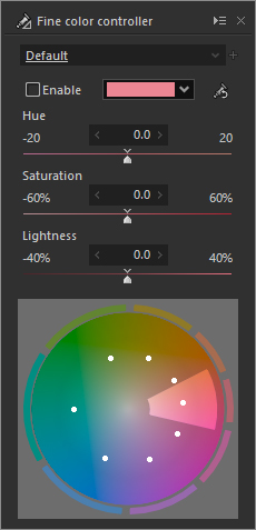

The fine color controller is a powerful color adjusting function that can freely handle colors.
Select [View (V)]-[Sub-controls]-[Fine color controller] from the menu to display the “Fine color controller” sub-control.
It can also be displayed from the fine color controller icon in the sub-control icons at the bottom of parameters controls.

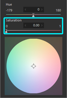

The fine color controller divides colors into 8 hues and provides a function for adjusting colors in each of the hues.
The color circle hue display shown on the control is arranged so that white is in center of the chroma chart, with color positions starting at the 3:00 position on a clock and going clockwise in the following order.
- Color name
- Rose red
- Purple
- Ultra marine blue
- Turquoise
- Blue-green
- Green
- Yellow-green
- Golden yellow
- Rose red
Color placement is arranged on this color circle such that the further from the center of the color circle, the higher the chroma, and they are placed at average color intervals as much as possible to meet human perception.
* A chroma chart of average color differences, called the CIE 1976 UCS Chroma Diagram, is used on the color circle.
There are two main ways to adjust parameters on the fine color controller.
These are a method of operating a mouse on the color circle and a method of setting parameter values using a slider control.
Please use these together for effective parameter adjustments.
4.10.1. Adjustments using the color circle
As seen in the diagram of the color circle shown above, the color circle is divided into 8 hue blocks, and there are operation points in each of these blocks.
(1) shows a block, and (2) shows an operation point.
A hue for operation is selected by clicking any of the 8 blocks.
Borderlines of the blocks of hues for operation are displayed in bold.
Operation points in each block can be moved by dragging the mouse or with the mouse wheel.
With either of these methods, movements along the circumference are interlocked with “Hue,” and distance from the center of the color circle is interlocked with “Chroma.”
Adjusting the “Brightness” parameter can be done with the mouse wheel, but it will not be shown on the color circle.
Parameters adjusted through mouse operations are reflected on the slider control, so both the color circle display and the slider control display are synchronized.

4.10.2. Adjusting with the sliders
Adjustments to each parameter value on standard controls, compared to the method of adjusting the color circle with the mouse, will be explained here.
Enable checkbox
Enable the fine color control.Hue adjustment
Select a hue for adjustment from the dropdown list.Hue
Set how much change in hue.
Set the angle in counter clockwise rotation from the reference point.Saturation
Set the ratio assuming that the distance from the center of the color circle to the reference point is 100%. When setting -20%, the operation point moves to the inside by 20%, and the saturation level is decreased. When setting 20%, the point moves to the outside by 20% and the saturation level is increased.Lightness
Set the ratio assuming that the lightness of the reference point is 100%. When setting -20%, the lightness level is decreased, and setting 20%, it is increased.
(Initialize)
Return all points to the initial state.

To use spotting tools, either select [Tools (T)]-[Spotting tools] from the menu or switch to “Spotting tools” mode from
on the sub-control icon when in the preview display.
A “Spotting tools” sub-control will be displayed when you switch to “Spotting tools” mode.
Also, a navigation display will appear for the “Spotting tools” display area on the preview display.

Each of the four operation modes, “Auto Erase”, “Copy”, “Eraser” and “Red Eye Correction”, are performed by left clicking the mouse over the “Spotting tools” sub-control preview display, and in the area inside the circle cursor in each mode.
You can remove dust and make red eye corrections by switching to operation mode and adjusting the size of the circle cursor.
[Operating Mode]
: Auto Erase
: Copy
: Eraser
: Red eye correction
[Tool effects]
: Wide pen
: Medium pen
: Thin pen
[Other Functions]
: Emphasize spotting areas
: Initialize spotting areas
4.17.3.1. Operation Modes
You can switch between the four modes, “Auto Erase”, “Copy”, “Eraser” and “Red Eye Correction”, while doing your work.
Switch operation modes using the
and
icons.

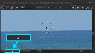

4.17.3.6. Changing Display Location / Magnification
The “Spotting tools” preview display can be displayed from 100%-1600% display magnification.
Change controls on the “Spotting tools” sub-control
Magnification changes are adjusted with the display magnification slider control.
Display magnification cannot go below 100%.
Adjust display magnification with the scroll bar.

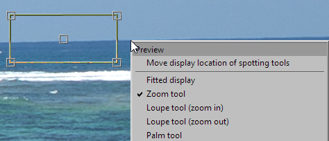

Change the preview window’s navigation display
Navigation display showing the area of the “Spotting tools” is executed on the preview window displaying the preview image of the selected image.
You can adjust the display area by moving the handles on the four corners of the navigation frame and with the center handle.
You can also move the display area of the “Spotting tools” to the location of the mouse pointer on the preview window.
Display the context menu by right clicking and select “Move display location of spotting tools”.

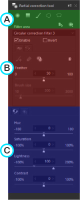

The “Partial correction tool” sub-control will be displayed when you switch to “Partial correction tool” mode.
The “Partial correction tool” sub-control is mainly divided into the following three sections.
(A) Add filter area and operate entire filter area
Add a new filter area and operate all added filter areas.
When performing correction, first add a filter area from here.(B) Operate “area” of selected filter
Set Feather, Brush size, and other parameters when adding a new filter area.
Also, operate each added filter area.(C) Operate “adjustment parameters” of selected filter
Set Lightness, Contrast, and other adjustment parameters for the selected filter area.

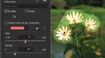

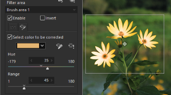

b. “Select color to be corrected” tab
(10) Select color to be corrected
Set whether to enable the “Select color to be corrected” function.
“Select color to be corrected” is a function that can specify a certain color to be corrected within a set filter area.
For example, you can increase the lightness of only red within the area drawn with the brush, and decrease the saturation of only blue within the area where gradual correction filter is applied.
Place a check here to enable the “Select color to be corrected” function.(11) Select color
Select a color to be corrected from the dropdown list.
If you wish to set an approximate color, select one from the dropdown list.
Colors set with the “Color selection tool” or “Hue” slider will be displayed in the dropdown list.(12) Color selection tool
This is a tool for directly specifying a color to be corrected on a preview image.
You can enter the “Color selection tool” mode by clicking
If you specify an area by clicking or dragging over the preview of a selected image, the average color of that area will be set as the color.(13) Preview of selected color
Reflect the selected color on the preview image.
Color will be maintained only in the areas corresponding to the selected color within the filter area, and all other areas will be displayed in monochrome.
Click
to turn ON or OFF the preview.(14) Hue
Set the hue of the color to be corrected with a slider.(15) Range
Using a slider, set the range of the color to be corrected where the color set with the “Hue” slider is the center.
Reducing the range will narrow the range of the color to be corrected, and increasing the range will widen the range of the color to be corrected.
Set an appropriate range while using “Preview of selected color”.

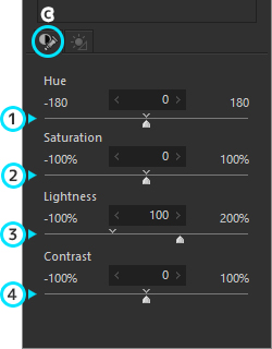

c. “Color / Contrast” tab
(1) Hue
You can adjust from “-180” to “180” with the slider.
This changes the relative hues within the designated area.(2) Saturation
You can adjust from “-100%” to “100%” with the slider.
The higher the chroma, the more brilliant the colors appear, but if the colors are already brilliant, they may become saturated and you may lose details.
When adjusting chroma, check the overall vividness of the colors. It is necessary to adjust so that the vividly colored parts are not saturated and details are not lost.(3) Lightness
You can adjust from “-100%” to “200%” with the slider.
The default value of lightness is 100%. Lightness decreases as this value lowers.(4) Contrast
d. “White Balance Adjustment” tab
(5) White Balance Adjustment
You can also adjust white balance in detail by numerical value.* “White balance target” control is based on the accurate color space.
(6) Initialize white balance target
Click
to set white balance target to the default value.
4.18.2. How to operate in Filter area mode
4.18.2.1. Circular correction filter
Open the “Partial correction tool” sub-control and click the
.Drag on the part of the image you wish to create to designate a rectangular area.
When you designate the area of the first circular correction filter, this becomes “Circular correction filter 1” and an item for this area is added to the “Filter area.”
The designated area has a quadrilateral with a handle. Control the handles by dragging them and fine tuning the area.
Operate the handles by dragging them and fine tuning the area.[How to operate the handles]
(A) You can adjust the rectangular height, by dragging the handles at the centers in the up and down sides of the rectangle moving to the up or down.
(B) You can adjust the rectangular width, by dragging the handles at the centers in the left and right sides of the rectangle moving to the left or right.
(C) You can expand or reduce the size of the rectangle, by dragging the handles at the corners of the rectangle inside and outside of the rectangle.
(D) You can rotate the rectangle and adjust its angle by dragging the handle projecting out of the top side of the rectangle.
In addition, you can rotate the rectangle 45 degrees by dragging this handle while holding down the [Shift] key.(E) You can move the location of the rectangle by dragging the handle at the center of the rectangle.
After designating the area, control each item in the “Partial correction tool” sub-control and make corrections.
If you want to make adjustments to another area, follow steps (1)~(4) making a new area for a circular correction filter.
By repeating steps (1)~(4), a new area will be added to the “Filter area” as follows: “Circular correction filter 2,” “Circular correction filter 3,” etc.
* You can control areas one by one on the image.
Therefore, when you have multiple designated areas, you can perform operations by switching areas of operation in the “Filter area.”

4.18.3. How to use adjustment using “Select color to be corrected”
By using the “Select color to be corrected” function on a filter area, you can specify an area in an image and change the color of only that area, or retain only certain colors and turn the other areas into monochrome.
Here, we will introduce an example of how to make adjustments using the “Select color to be corrected” function on a filter area.
How to make adjustments using 'Select color to be corrected'
Adjustment steps
Add a filter area by encircling the area to be corrected.
In this example, a flower drawn with a brush is set as an area to be corrected.
If you add a filter area, the entire specified area will be set to be lighter at first.
Switch to the “Select color to be corrected” tab and set the color to be corrected.
The color to be corrected can be specified using any of the following three methods.- Select an approximate color from the “Select color” dropdown list
- Select a color in an image using the “Color selection tool”
- Set a value directly using the “Hue” slider in the “Select color to be corrected” tab
By directly selecting a color in an image using the “Color selection tool”, you can make adjustments intuitively.
Here, we will select the petal area using the “Color selection tool”.
“Select color to be corrected” will be enabled, and the color selected as the color to be corrected will be set.
By clicking “Preview of selected color”, you can check the selected color on the preview image(*).
The area shown in color is the selected color.
In this example, the tip of the petal is not completely inside the selected color area, so the “Range” slider value will be increased so that the petal will be shown entirely in color.
The selected color has now been set.
* Note that the “Preview of selected color” function is a function for displaying areas other than the selected area in monochrome, and is not an adjustment parameter.
Clear “Preview of selected color” and adjust parameters.
The example on the right shows the flower area in a different color by adjusting the “Hue” and “Saturation”.
The example on the right shows the image with the selected color inverted by placing a check in “Invert”, after completely removing the saturation of the flower area by setting “Saturation” to -100.
Color is retained only in the flower area, with all other areas in monochrome.

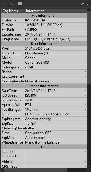

4.20. Image properties
Change properties of currently selected image
Select [View (V)]-[Image properties] from the menu.
This can be displayed by clicking on
in the main control.
The “Image Properties” sub-control is also a control for viewing image property information, but there is also a function for simultaneously editing image properties.
If photographic information recorded in the JPEG image is incorrect, you can correct it or add information not recorded.
You can edit comments here.
You can also add information based on IPTC (International Press Telecommunications Council).
You can also make settings that do not record only specific information.
Contents edited here are recorded in JPEG images development results by SILKYPIX .
Image Properties
4.20.1. File information
File information for the selected image file is displayed.
Editing is not available for items in this category.
Information related to the file format is displayed in “UniqueInfo”.
Refer to this information when a selected image is not shown in the preview display, because information may be displayed if it is a format not supported by SILKYPIX or if the file is corrupted.
“Editing date and time” displays the date and time of the latest edit by SILKYPIX.
This is the edit date and time development parameter that SILKYPIX automatically records. It is not displayed for images that have not had development parameters edited or for initial development parameters.
4.20.2. Data information
This is mainly information recorded in Exif information for JPEG images. Information related to the image and secondary information on the image is displayed here.
“UserComment” and “Rating” are items that can be edited.
4.20.3. Image information
This is mainly information recorded in Exif information for JPEG images. Photographic information such as camera settings at the time the photograph was taken is displayed here.
“DateTime”, “ISO Speed”, “ShutterSpeed,” “ApertureVal”, “FocalLength” and “Lens” can be edited.
You can freely edit items such as corrections to incorrect dates and times set on the camera or when photographic information is not correctly recorded such as when you use a manual lens.
When recording to a developed JPEG image, the “Name of Lens Used” is recorded in a standard format to XMP, while other information is recorded as Exif information.

4.20.6. Editing Items
Some image property items can be edited.
Edited contents are reflected in additional information when saved to developed JPEG images.
Utilize this for corrections to image property recorded in JPEG images, for adding unrecorded information or if not recorded as additional information when saving developed JPEG images.
Items that can be edited have one of the following icons displayed on the right side of “Information.”
Items that do not show an icon cannot be edited.
: Show items that are unedited from their initial values.
There are some cases where initial values are not set.
: Show edited items.
: Show items where the “Do not record when developing” setting was explicitly performed.
This item is not recorded as secondary image information when saving developed JPEG images.
To edit an item that can be edited, place the mouse over the item and click on
displayed on the left side, or double click on the “Information” cell.
An edit item dialog will appear.
4.20.6.1. Edit Item Dialog
The contents of the edit item dialog edit item dialog may slightly differ depending on the image property item, but the following are common operations.
Edit item contents
Set optional item contents.
The setting format may slightly differ depending on the type of item.
Enter characters in the text box for characters.
There are also some items for which you can choose values from a dropdown list.
“Datetime” is a special case, so please refer to “4.20.6.2. DateTime”.Select item contents from edit history
If there are items that can be set with optional values, you can choose item contents from the edit history up set to that time.
Use this if you set the same information repeatedly, such as IPTC information items and the name of your lens.Initialize
Return to unedited status.When developing, non-record
Items with this check box checked will not record secondary image information when saving developed JPEG images.
Items without initial values set are checked in their initial status.
You can explicitly make a setting for items that you do not want to record as secondary image information when saving developed JPEG images.
4.20.6.2. DateTime
“DateTime” takes special handling, so it will be explained here separately.
The “DateTime” setting is used mainly for corrections to “<DateTime” when the date and/or time of the photograph recorded by the camera is incorrect.
The set “DateTime” manages time differences in consideration of correcting the date and/or time the photograph was taken for all photographs taken, such as when the time set on the camera is not correct.
Therefore, you can correct the “DateTime” at one time by editing the “DateTime” on one image and copying the contents onto other images.
Use Change Date / Time of file as the default “DateTime” for image processing images that do not have “DateTime” recorded such as images read by scanners.
In this case “(Date / Time changed)” is added to the end of the “DateTime” item in “Image Properties”.

Some settings within the development parameters can be set “On / Off.”
The “On / Off” settings can be found in the following sub-controls.
Lens aberration controller
Rotation/Shift lens effect
Effects
Monochrome controller
In “Fine color controller”, the “On / Off” settings for the development parameters of the entire sub-control will be switched.
In other sub-controls, the “On / Off” settings for development parameters will be switched for each adjustment item with a “On / Off” setting in each block.
If parameter blocks are off, they will have equal status no matter what value is used in the development parameters composed of the parameter blocks.
