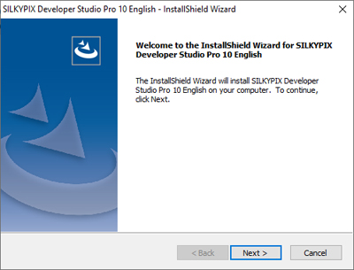

1. Startup
When you execute the downloaded set-up program (Windows version), installation of SILKYPIX Developer Studio Pro10 / 10 starts.
“SILKYPIX Developer Studio Pro10” or “SILKYPIX Developer Studio 10” icon is created on the desktop after the installation is complete.
Double-click the above icon on your desktop to execute “SILKYPIX Developer Studio Pro10” or ”SILKYPIX Developer Studio 10”.

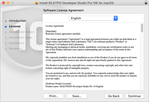

1.1.2. macOS: Installation and Execution
When you execute the downloaded dmg by double-clicking, the volume “SILKYPIX…” is mounted on your desktop, which includes the installer.
When you execute the installer by double-clicking, installation of SILKYPIX starts. Please proceed according to the instruction.
Double-click the SILKYPIX icon which was installed to execute SILKYPIX.
(The administrator’s password is required for the first execution.)
*To uninstall the SILKYPIX, go to the Application folder and place the SILKYPIX into the trash can.

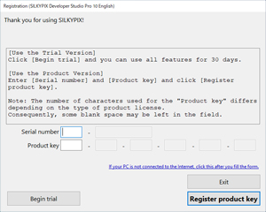

1.2.1. Beginning Trial
When installing or running “SILKYPIX Developer Studio Pro10 / 10” for the first time, process as the administer in order to record administer information on the PC you are using.
Please refer to “1.4. Operations using Windows” for more details.
When you register the product key on your PC once, you will be able to fully use “SILKYPIX Developer Studio Pro10 / 10”.
Processing is performed as the administrator the first time “SILKYPIX Developer Studio Pro10 / 10” is run, but after this process is complete, it runs as a standard user.

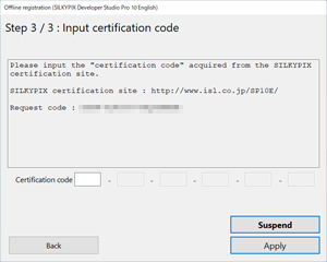

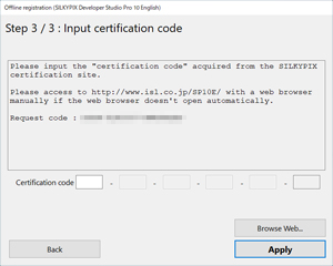

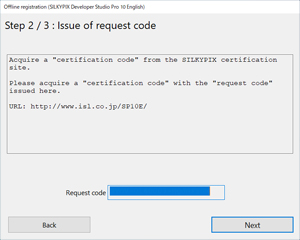

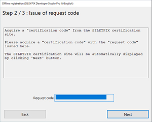

- Step-2
The “request code” will be displayed, which is necessary to acquire a “certification code” at Step-3. “SILKYPIX certification site” will be displayed with the Internet browser automatically.
- Step-3

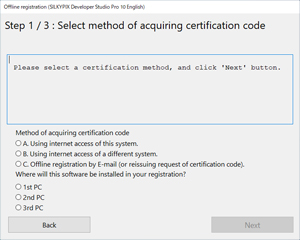

- Step-1
Step-2
If you got the “certification code”, then please click the [Next] button.- SILKYPIX Developer Studio Pro10 / 10 English certification site
http://www.isl.co.jp/SP10E/
Step-3
- Step-1
Step-2

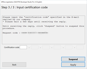

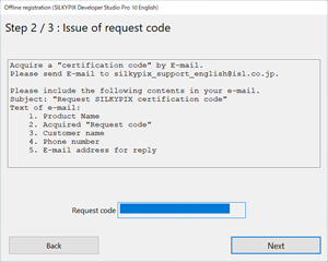

Please send an e-mail with the subject and text reading “Request code” to our offline registration center (silkypix_support_english@isl.co.jp). We will send reply e-mail with your “certification code” to you in three business days or less.
Text of e-mail:- Product Name
- Acquired “Request code”
- Customer name
- Phone number
- E-mail address for reply
- Product Name
Step-3

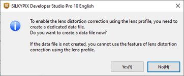

1.3. Create data file for the lens profile
A message dialog to confirm whether to create a data file for the lens profile will be displayed when this software is launched for the first time.
The data file for the lens profile will be needed to perform distortion correction with the lens profile.
Please see “4.11.4.5. About create data file for the lens profile” for details on this message dialog and creating a data file.
Please see “4.11.4. Lens profile” for information about distortion correction with the lens profile.
