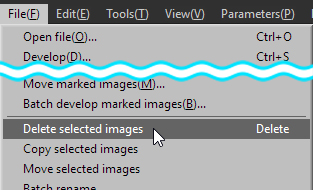

8.1.2. Delete selected images
 After selecting all of the images which you want to delete, the menu command [File (F)]-[Delete selected images] or [Delete] key throws away the selected images to the Trash box.
If you hold down the [Shift] key at the same time, files will not be moved to Trash box, but will be completely deleted.

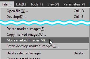

 To move the marked images, execute [File (F)]-[Move marked images (M)] and then specify the folder into which the images are moved.

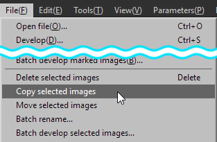

 To copy/move the selected images, execute [File (F)]-[Copy selected image] or [Move selected image] and specify the folder into which the images are copied/moved.

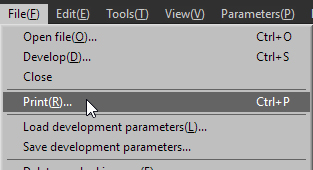

8.5. Printing
 This function prints selected images on a printer.

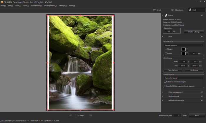

This function has two printing formats, one is “Normal printing” that prints one image on one sheet, the other is “Contact sheet” that prints multiple images on one sheet.
Select [File(F)]-[Print(P)] or [View(V)]-[Print] from the menu, or click the  Print button on the toolbar to display the print section.
Check the print image on the left and set the print settings with the controls on the right.

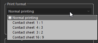

8.5.3.1. Print format
 You can specify the print format. There are two different formats, one is “Normal printing” that prints one image on one sheet, and the other is “Contact sheet” that prints multiple images on one sheet.
If you select “Contact sheet”, you can select the aspect ratio of the frame for each image, which is 1:1, 4:3, 3:2, or 16:9.

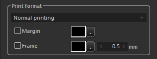

- [Setting for Normal printing]
  - Margin
 When this is checked, you can add a color to the margins of the printable area.
 The “Color Selection” window opens when you click […] button.
 After adjusting colors with the slider or color circle, the color is set when you click the [OK] button.
- Frame
 When checked, you can attach a frame line to the image within the printing range frame.
 After adjusting colors with the slider or color circle, when you click the [OK] button the color is determined.
 Designate the size of the frame lines in mm units.

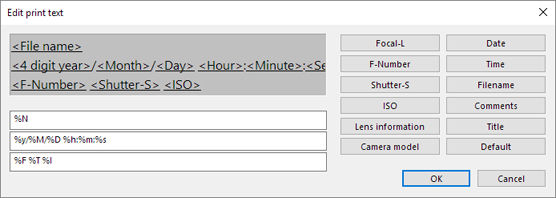

Open the “Edit print text” window and set text displayed on the contact sheet.
- Click on [Edit] button and open the “Edit print text” window.
- After clicking on the position which arranges items to be used in the edit box at the bottom left of the window, click the button for the item you will use.
- The control characters for the item selected in (1) will be displayed in the edit box.

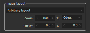

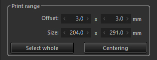

8.5.3.2. Print range
 You can specify the print range if you select “Normal printing”.
- Offset
 Please specify the offset from the top left of the sheet.

8.5.3.3.2. Arbitrary layout
- [Operations on the preview image]
 You can perform operations similar to “Zoom tool”.- Offset adjustments
 Drag and move the image.
- Adjust magnification
 Adjust magnification with [Shift] key + dragging.

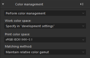

8.5.4. Color management
If you do not understand “Color management”, select “Color management on printer side” and select “sRGB” as the print color space.
Please refer to “10.4.5.5. Color management for print output” concerning color management.
8.5.4.1. Perform color management
If you print using this format, you must not make any color corrections on your printer.
Select a mode such as “No color corrections” and be sure to not perform any color conversions on your printer.
This is a method for quite easily performing color management on a PC environment in which you can choose an appropriate “print color space.”
- Work color space
 Choose either sRGB or Adobe RGB.
- Print color space
 Display a list of color spaces (= color profiles) installed on your OS.
 Select an appropriate color space from this list.
 However, the print color space that can be used by SILKYPIX must be RGB.
 Please note that color spaces other than RGB, such as CMYK, cannot be used. (*1)
 Please use a profile created with special calibration tools or the like. (*2)
 If a color profile is installed on Windows, select a color profile from Explorer, right click and open the context menu.
 Select “Install Profile”.- *1 Generally, the color space of color profiles offered by manufacturers of inkjet printers for home use is RGB, so you can use this without any problems. - *2 SILKYPIX uses the color management function installed in your OS to perform color management.
 Therefore, SILKYPIX cannot use color profiles of a format not supported by your OS.
 Please refer to “10.4.5.3. Color management performed on SILKYPIX” for details.
- Matching method
 Printing photographic images generally uses “Perception” or “Maintain relative color gamut.”
 Choose a matching method appropriate to the photograph’s hues and your aims.- Perception
 Perform color conversion that stresses the visual relationships of colors such as continuity of gradation and hues.
 The absolute coordination of colors is changed, but it has a visually natural finished.
- Saturation
 Perform color conversion that stresses saturation.
 Choose this if your aim is to maintain high saturation more so than color reproduction.
- Maintain relative color gamut (Default setting)
 This performs color conversion that maintains relative color relationships that stress hues and gradation.
 Colors that cannot be found in the designated color space are adjusted to the closest colors that can be reproduced.
- Maintain absolute color gamut
 This converts colors while maintaining the color’s absolute coordinates.
 Colors that cannot be found in the designated color space are clipped. Choose this to express correct absolute colors.

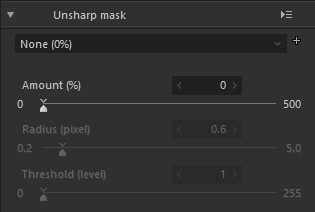

8.5.5. Unsharp mask
 This is an adjustment item in effect only under “Normal printing”. Use if you want to perform additional unsharp mask when printing (Outline emphasis processing: A type of sharpness processing).
Please use this feature apart from the sharpness of the development parameter if you want to make up the sharpness to measure up to the blur of printing. The “sharpening” of the development parameter should be adjusted for each image to increase resolution.
On the other hand, the “Unsharp mask” set here has the same effect on all images printed at the same time, so it will compensate lowered resolution from ink runs that occur during the printing process.
Please refer to ‘10.1.9. Proper Use of Sharp in Development Parameters and Unsharp Mask when Developing / Printing’ for more details.
There are three types of adjustment items. You can adjust in terms of amount(%), radius(pixel) and threshold(level).
- Amount
 You can specify the “amount” to apply “unsharp mask”. The larger value makes the stronger sharpness.
- Radius
- Threshold
 If the value is set smaller, the outlines are emphasized regardless of the clearness of the edge.
 If the value is set larger, only the outlines are emphasized which has clear edge.
8.5.6. Imprint data
 This item is effective only for normal printing.  You can imprint the date and time the photograph was taken when printing.
Creating “Imprint data” is required for imprinting a credit image you prepared.
Only JPEG and TIFF images can be selected as images to be imprinted.
- Imprint data
 Select which data for imprint data you will use.
- Edit data
 Please refer to “9.7.1. Edit imprint data” for details.
- Configure list
 Make settings of data for imprint data.
 Please refer to “9.7. Imprint data settings” for details.
- Composition mode
 Select which data for imprint data you will compose.
 For printing and develop, select the appropriate composition mode while looking at the preview display.- Automatic size adjustment
 Resize the composed characters and image to meet the output printed image size.
 Normally, this setting is used.
- Composite by the fixed-size
 Compose keeping the designated size of the composed characters and image as is.
 Edit data for imprint data if the position of the characters and image to be imprinted is not appropriate.
- Composite relative to paper
 Composites an entire printable area of the paper while keeping the specified size of the characters or image to be composited.
 Use this mode when you want to place text on the outside of the image to be printed.- * This composite mode can be specified only when printing. - * When this composite mode is selected, the frame settings are disabled.
8.5.7. Set the number of copies and start printing
 Specify the number of copies to be printed in “Number of copies” at the bottom right of the main window.
Click the [Print] button to start printing.

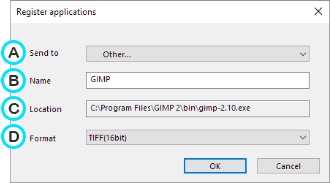

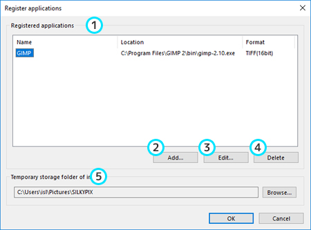

8.7.1. Register applications
The menu command [File (F)]-[Open with another application] displays the “Register applications” dialog.
You can also display the “Register applications” dialog from the context menu that is displayed by right-clicking on a preview or thumbnail, and the menu that is displayed by clicking the  icon on the toolbar.
- Registered applications
 A list of pre-registered applications is displayed.
- Add
 Register a new application.
- Edit
 Edit settings for a registered application.
- Delete
 Delete the settings of a registered application.
- Temporary storage folder of images
 Specify a folder to temporarily save development results when opening an image in another application.
 For both Windows and macOS, the “SILKYPIX” folder under the “Picture” folder in each user folder is set by default.
 Clicking [Add…] will display a dialog for specifying an application.
- (A) Send to
 Select any application from the list.
 If no application is shown in the list, select “Other…” and specify an application (.exe file) directly.
- (B) Name
 Set the name that will be shown in the list of registered applications.
 The application name or file name selected in Send to will be set, so change it as needed.
- (C) Location
 The pathname of the selected application will be shown.
- (D) Format
 Select the file format in which to open a developed image in another application.
 Choose from TIFF(16bit), TIFF(8bit), and JPEG. (*)
* TIFF (16bit, 8bit) will be developed without compression, and JPEG in Quality of 100.

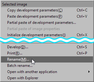

8.7.2. Open selected images with another application
 Select a registered application from any of the following menus.
- Select from [File(F)]-[Open with another application]
- Select from “Open with another application” in the context menu that is displayed by right-clicking on a preview or thumbnail
- Select from the menu that is displayed by clicking the  icon in the toolbar icon in the toolbar
The selected image will be developed, and the developed image will open in the specified application.
