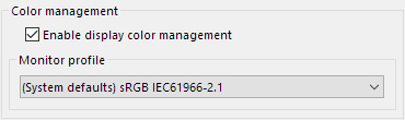

9.2.1. Color management
* This setting is only available on the Windows version.
The preview image cannot display accurate colors if it is a JPEG / TIFF image recorded in an input color space other than sRGB and if the output color space is set to something other than sRGB when color management is disabled.
* In the macOS version, this automatically succeeds the monitor profile set on the macOS and displays the program.
Therefore, there is no “Color management” item in the macOS version.
Please refer to “10.4.5. Color management” for details.

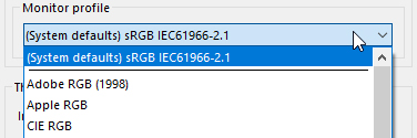

9.2.1.1. Monitor profile
Please refer to “10.4.5.4. Color management on monitor displays” for details.

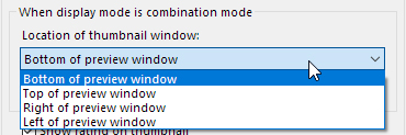

9.2.3. Preview window
9.2.3.3. Grid Settings
9.2.3.4. Partial Correction Tool Settings
  • Brush overlay color
    This is a setting for overlay color displays shown when drawing / editing the Brush in the Partial Correction Tool.
  1. Stay in preview mode
  2. Change to thumbnail mode
  3. Change to combination mode

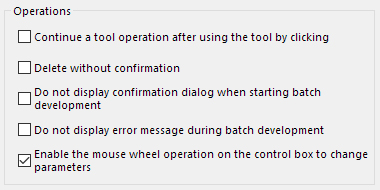

9.3.2. Operations
    If this setting is not checked, values will not be changed when the mouse wheel is operated on controls.

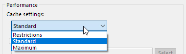

9.3.3. Performance
9.3.3.1. Cache settings
  • Restrictions
  • Standard (default)
    It’s a standard setting.
  • Maximum
    Maximize the use of Cache
  • Normal (default)

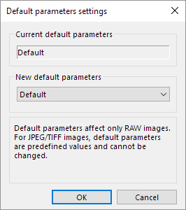

* “Default parameters” affect only RAW images. For JPEG/TIFF images, “Default parameters” are predefined values and cannot be changed.

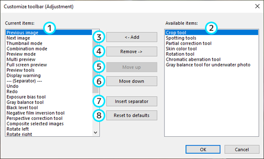

9.6. Customize toolbar
You can also select [Customize toolbar] from the context menu displayed by right-clicing on the toolbar.
  1. Current items
  2. Available items
  3. Add
  4. Remove
  5. Move up
  6. Move down
  7. Insert separator
  8. Reset to defaults
* This setting is saved for each size of the skin that can be selected in “9.9.3. Select skin”.
* The items available in this setting differ for each selected section.
In addition, this setting is saved for each section.

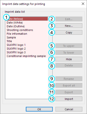

9.7. Imprint data settings
  1. Imprint data list
    • Maker data
    • User data
  2. Edit
    Edit selected data.
  3. Create new
    Create new data.
  4. Copy
  5. To upper
  6. To lower
  7. Hide / Show
  8. Delete
    Delete selected data.
  9. Rename
  10. Export all
  11. Export
  12. Import

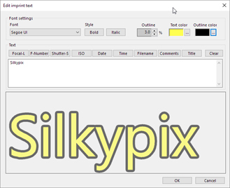

9.7.1.2. Character settings
  1. Standard point
  3. Size
    Set character size.
    When composition mode “Automatic size adjustment”, if the standard size of imprint data is changed to match the size of the image, the height will change at the same ratio.
    If “Composite by the fixed-size” or “Composite relative to paper” is being used in the composition mode, imprinting will be performed at the set size.
  4. Setting details
      • %L : Focal length
      • %F : F number
      • %T : Shutter speed
      • %I : ISO speed
      • %l : Lens
      • %c : Model
      • %n : Filename
      • %C : Comment
      • %t : Title

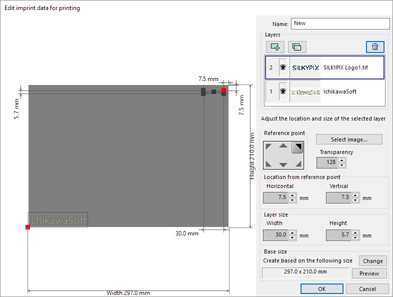

9.7.1.4. Base size
  1. Base size
    Set this standard size.
    The composition mode for imprint data when printing and developing can be designated, but if “Composite by the fixed-size” or “Composite relative to paper” is being used in the composition mode, imprinting will be performed at the set size.
    When composition mode “Automatic size adjustment”, the ratio of image and character size will remain the same as the base size and the size will change to fit the paper and output size.

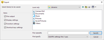

9.8.1. Export
  1. Save file
  2. Settings to be exported
* When you import a setting file exported from SILKYPIX Developer Studio Pro10 / 10 in a previous version, some settings are lost in a previous version.

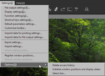

9.9. Options
9.9.1. Delete access history
9.9.2. Initialize window positions and display states
9.9.3. Select skin
This new skin is only visible after restarting SILKYPIX Developer Studio Pro10 / 10. To display with the new skin, please close this software once and re-execute it.

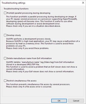

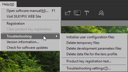

9.10. Troubleshooting settings
9.10.1. Initialize user configuration files
9.10.2. Delete data file for the lens profile
Delete the data file created for performing distortion correction using the lens profile.
When a data file needs to be created, a message dialog will be displayed to confirm whether to create it when the software is launched.
Create a data file again as needed.
Please refer to “4.11.4.5. About create data file for the lens profile” for information about data files for the lens profile.
9.10.3. Product key registration test
If it is determined that you cannot perform online registration of your product key, enter your “Serial number” and “Product key” in the “Product key registration” dialog and register offline by clicking on the “Offline registration” button.
