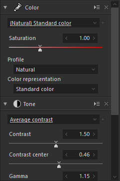

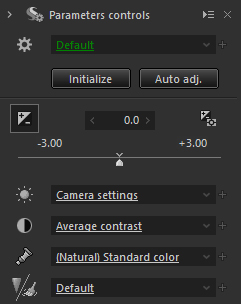

4.1. “Parameters Controls” and “Sub-control”
The GUI for setting each parameter is located in the Main Controls part at the top of Parameters Controls. GUIs in the Main Controls are placed in the following order from the upside.
  • Tastes/Parameters
    • (Dropdown list + Select button + Parameter adjustment button)
  • Exposure / Luminance
    • (Slider control + Select button + “Automatic exposure bias” button)
  • White balance
    • (Dropdown list + Select button)
  • Tone
  • Color
  • Sharpening/Noise reduction
On the bottom area of the “Parameters controls”, sub-control icons to switch sub-controls for adjustment of the development parameter are located.
The dropdown list is the GUI for selecting a taste (=preset value) that is prepared in advance by ISL (Ichikawa Soft Laboratory) or a user. The “taste” is a value consisting of development parameters. For more details about the “taste”, please refer to ‘4.1.1 Taste’.
When you select a taste from the dropdown list, the related sub-controls automatically appear on the “Tab page”. However, according to customer’s preference, the sub-controls can be located on the “Control box” or a floating window.

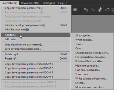

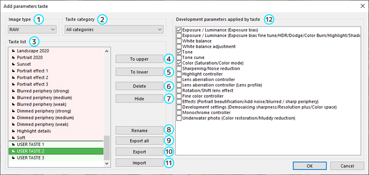

4.1.1.3. Add taste
You can add / register a development parameter applied to a currently selected image as a taste.
There are two ways to add / register a taste.
Select [Taste category] from [Parameters (P)]-[Add taste] on the menu, or click on the icon located on the right side of the dropdown list.
The “Add parameters taste” dialog will be displayed.
The “Add parameters taste” dialog format is the same as the “Edit parameters tastes” dialog.
Please see the next section, “4.1.1.4. Edit tastes” concerning operation methods for this dialog.
“Tastes” added through the “Add parameters taste” dialog will be displayed in dialogs as selected, so set an appropriate name for the taste and click on the [OK] button to confirm.
  • Items set in the “Add parameters taste” dialog
    1. Taste name
      By default, names are set sequentially, such as “User taste 1.”
      Change to an appropriate name to make it easy to distinguish from other tastes.
    2. Applicable development parameter category
      If “Taste category” is added as a taste other than “All categories,” it is not necessary to edit because “Applicable development parameter category” is fixed to one category.
      If the “Taste category” is “All categories,” you can enable any category in “Applicable development parameter category.”
      Enabled categories are set as taste masks.

  1. Subject data
    A taste is defined for a “RAW” or a “JPEG/TIFF”. You can select either of the two types.
  2. Taste category
    A taste is defined for each parameter category.
  3. List of tastes
    There is a list of tastes with a mark.
    • A mark at the left of a taste title:
      The taste represents all development parameters if you select taste category “All parameters”.
      The taste only part of the parameters if you select taste category “All parameters”.
      There are two kinds of tastes, maker tastes created in advance by our company, and user tastes that you create.
    • Maker taste
      These are displayed with a red background.
      They cannot be deleted, exported or moved.
    • User taste
      These are displayed with a green background.
  4. Upward button
    The upward button moves a selected taste upward.
  5. Downward button
    The downward button moves a selected taste downward.
  6. Delete button
    The Delete button deletes selected tastes.
    Maker tastes cannot be deleted.
  7. Hide / Show button
    Selected data is hidden.
    Maker data cannot be deleted, but they will not be displayed on the list of tastes with this setting.
  8. Rename
    Change the name of selected tastes.
  9. Export all button
    All user tastes that have “Image type” and “Taste category” in common are recorded and saved in a file.
    All tastes displayed with a green background are “Taste list”.
  10. Export button
    The export button exports a single selected taste.
  11. Import button
    The import button imports a saved taste.
  12. Development parameters applied by taste
    When you select the “All parameters” in the list of the taste category, you can apply any of the parameter categories to a taste. For example, you can apply “tone” and “tone curve” to a taste.
When you add a new taste, the “Edit parameters tastes” dialog is also displayed and you can customize a name of a new taste and other settings as well as the taste customizing.

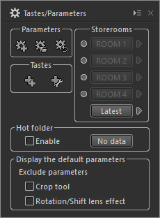

4.1.2. Tastes/Parameters
You can perform taste registration and editing, save development parameters, read, initialize and temporarily register in the “Tastes/Parameters” sub-control.
4.1.2.1. Storerooms
The “Storerooms” is a function that temporarily records development parameters.
There are four rooms (ROOM 1-4) in which you can record development parameters. There is also a special room named “Latest”.
You can record optional development parameters in the first four rooms.

4.1.3. Parameter adjustment buttons
“Initialize” and “Auto adjustment” buttons are located under “All category tastes”.
4.1.3.1. Initialize
Reset the development parameters of selected images to default.
If default parameters are set, the default parameters will be applied.
Please refer to “7.4. Initialize Development Parameters” for details.
4.1.3.2. Auto adjustment
The “Auto adjustment” button adjusts to the optimal exposure, white balance, and level correction for SILKYPIX all at once.
Clicking the “Auto adjustment” button will perform the following adjustments in order for the selected images.
  1. Auto exposure bias
  2. Auto White Balance
  3. Automatic level correction
For auto white balance, “Auto (Natural)” will be set.
Automatic level correction will be performed on the “RGB” channel.
Further adjustments can also be made to parameters after performing auto adjustment.
Please use this function according to each situation.

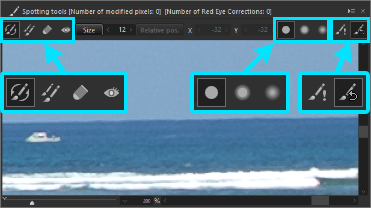

(C) - (2) Spotting tools

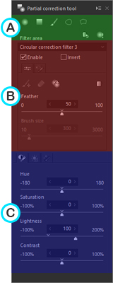

(C) - (2) Partial correction tool

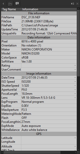

(D) - (4) Image properties

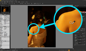

4.4.5. Skin color tool
This is a tool for adjusting the skin of a person appearing in the photograph to an “expected pretty skin color”.
You can switch to “Skin color tool” with the button on the “white balance” sub-control, or menu command [Tools (T)]-[Skin color tool]. In the “Skin color tool” mode, you can click or drag a rectangle area at the target skin on the preview, then the target area is automatically adjusted to beautiful skin color and also exposure bias is adjusted.
This tool is used at the same time as adjusting white balance and exposure bias.
There are times when adjusting skin color does not change as expected with one operation.
If the result is too red, green, or blue, please click that area again. By a few repeatable operations, you can find out the suitable skin color. Then you can additionally adjust “White balance adjustment”, “Exp. bias fine tune”, or “Tone” for fine-tuning. If you use this tool on the woman’s face, please avoid the emphasized make-up area. Basic foundation area, especially dull color area is suitable for picking up,
* To adjust skin color continuously, you need to check “Enable Continuous Operation of Eyedropper Tool” on the “Function settings” dialog. Please refer to “9.3.2. Operations” for detail.

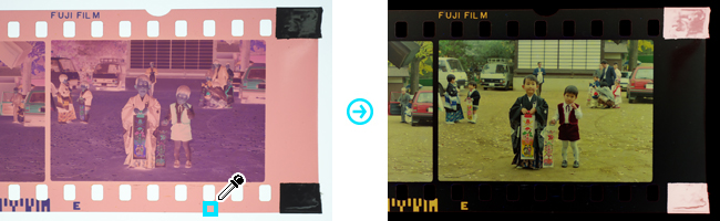

4.4.6. Gray balance tool for underwater photo
With the Gray balance tool for underwater photo, you can designate parts of the photo you want expressed in gray (neutral colors), which automatically adjusts the white balance so that those parts are expressed in gray, as well as calculating the color depth and underwater color deviation.
The White Balance Adjustment Mode is activated through the Underwater Gray Balance Tool by either selecting [Tools (T)] - [Gray balance tool for underwater photo] from the Menu, or by clicking on the button under Marine Controller.
Under this status, you can click on the portion of the preview image you wish to Gray, or you can designate the range by dragging. This will set the portions for white balance to be expressed in Gray.
This is an especially effective method when white objects (or objects with no color or of neutral color) are shown in the picture. Even if not completely white, you can drive this by using the color depth and underwater color deviation after using rough white balance by clicking on sandy areas or such.
* For eyedropper operation, refer to ‘9.3.2. Operations’.

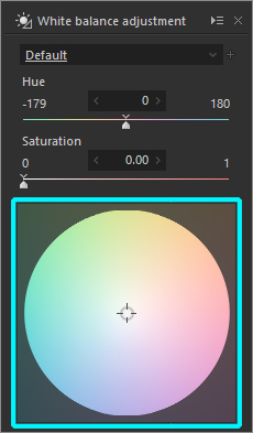

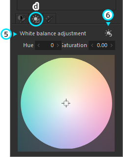

4.4.9. White Balance Adjustment
The menu command [View (V)]-[Sub-controls]-[White balance adjustment] displays the “White balance adjustment” sub-control. Use this function when you want to adjust the white balance at the final stage of your workflow e.g. tinting You can adjust white balance in detail with this sub-control, which has a “white balance target” graphic control, a “saturation” slider, and a “hue” slider.

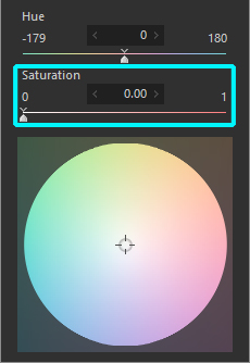

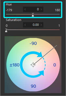

  1. White balance target
    This graphic control is based on the accurate color space. You can set the white balance visually by clicking a mouse directly.
    • [Mouse wheel operation]
      You can change “saturation” parameter with the mouse wheel on the white balance target.
      And with [Shift] key, you can change “hue” parameter.
  2. “Hue” slider
    It shows the angle from the right hand side of the white balance target in clockwise. Move the slider to change the angle in detail. You can specify the setting value indicates:
    • 0
      right from the center
    • 90
      downward from the center
    • 180 (-180)
      left from the center
    • -90
      upward from the center
      lower half from the center
      upper half from the center
  3. “Saturation” slider
    It shows the radius from the center of the white balance target. Move the slider to change the radius in detail. The range is 0.00 to 1.00 (0.00 is the center of the white balance target, 1.00 is the maximum radius).

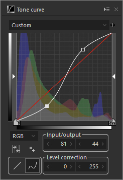

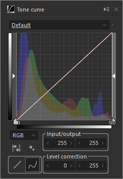

4.5.3. Tone Curve
The “Tone curve” is a tool for making minute adjustments to tone expression after completing adjustments to other biases and for converting brightness for effect.
The menu command [View (V)]-[Sub-controls]-[Tone curve (T)] displays the “Tone curve” sub-control.
You can also display it using the sub-control icon “Tone curve” button.
Bias from the “Tone curve” is reflected after other bias processing is performed and converted to the color space on the output color space of development settings.
Therefore, for example, if you set monochrome to color, when you adjust R, G and B separately on the Tone curve, this will not be monochrome, or if you change the output color space in the development settings, you will have to make readjustments to match the color space. Keep this point in mind when you use this.
You can set the curve (= Tone curve) that converts brightness on this sub-control.
The horizontal axis means input (brightness of source picture) and the vertical axis means output (brightness results of a picture after adjustment). You can control lightness in a picture by operating this curve.
* By dragging window’s frame of the “Tone curve” sub-control, you can adjust a size of the dialog.
In addition, by dragging it while pressing the Shift key, you can adjust the size while fixing the aspect ratio of it.
4.5.3.1. Selecting a Taste
Several tastes that have good effects are included as Maker Tastes in tastes.
There are also special items such as “Initialize” and “Initialize all” within the tastes of the tone curve.
“Initialize” initializes only the tone curve of the selected channel (all RGB, R, G, B or L), while “Initialize all” initializes all five tone curves.
4.5.3.2. Editing Points
The curve is drawn as passing through a point, and you can operate the curve by moving the point.
Selected point information is displayed on the “Input / Output” control.
You can move the point by editing the value in this control or by dragging the point on the tone curve.

Color adjustment can be performed by selecting Color saturation adjustment, Color profile and Color representation.
4.6.1. Adjusting Saturation with Taste
Select a taste from the dropdown list of “Color”.
4.6.2. Fine-Tuning Saturation
The taste includes a range of saturation that is considered to be appropriate to normal use. However, if you want more or less saturation, or adjust saturation more precisely, you can set it manually.
4.6.3. Color profile
Color profile refers to the characteristics of Color representation. Select this from the “Profile” dropdown list in the “Color” sub-control.

4.6.4. Color representation
Color representation determine the direction of color reproduction. You can select it from the “Color representation” drop list in the “Color” sub-control. The following are categories of color representations: “Standard color,” “Memory color,” “Portrait color,” “Film color,” “Monochrome,” “Photo style/Camera color” and “FILM SIMULATION.”
4.6.4.1. Standard color
This is the standard color creation of SILKYPIX, which aims for true color reproduction. This mode provides reasonably natural colors for many scenes.

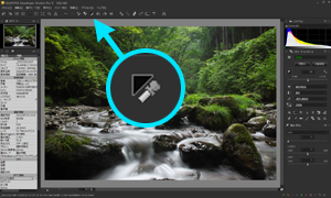

4.6.5. Negative film inversion tool
Negative film inversion tool is a tool for inverting a negative film by specifying the film part in the photograph.
Invert can also be done by adjusting Tone curve, but this inverts adjustments such as Exposure bias and White balance.
By inverting with this tool, you can make adjustments such as Exposure bias and White balance as with ordinary images.
Enter “Negative film inversion tool” mode by clicking on the toolbar or by clicking [Tools(T)]-[Negative film inversion tool] on the menu.
Specifies the unexposed area of the film by clicking or dragging on the preview or thumbnail for the selected images.
When an area is specified, white balance is adjusted and inverted so that the area becomes black at the same time. (*1)
When the inversion process is performed with this tool, the Profile of the “Color” sub-control will be “Negative film inversion”.
To cancel the Inverse, select a profile other than “Negative film inversion”.
When you shoot negative films, they should include unexposed areas of the film.
Alternatively, unexposed film image should be shot in the same shooting conditions as other images and unexposed areas should be specified on the thumbnail.

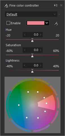

4.10. Fine Color Controller
The fine color controller is a powerful color adjusting function that can freely handle colors.
Select [View (V)]-[Sub-controls]-[Fine color controller] from the menu to display the “Fine color controller” sub-control.
It can also be displayed from the fine color controller icon in the sub-control icons at the bottom of parameters controls.
The fine color controller divides colors into 8 hues and provides a function for adjusting colors in each of the hues.
The color circle hue display shown on the control is arranged so that white is in center of the chroma chart, with color positions starting at the 3:00 position on a clock and going clockwise in the following order.
  • Color name
    • Rose red
    • Purple
    • Ultra marine blue
    • Turquoise
    • Blue-green
    • Green
    • Yellow-green
    • Golden yellow
Color placement is arranged on this color circle such that the further from the center of the color circle, the higher the chroma, and they are placed at average color intervals as much as possible to meet human perception.
* A chroma chart of average color differences, called the CIE 1976 UCS Chroma Diagram, is used on the color circle.
There are two main ways to adjust parameters on the fine color controller.
These are a method of operating a mouse on the color circle and a method of setting parameter values using a slider control.
Please use these together for effective parameter adjustments.
4.10.1. Adjustments using the color circle
As seen in the diagram of the color circle shown above, the color circle is divided into 8 hue blocks, and there are operation points in each of these blocks.
(1) shows a block, and (2) shows an operation point.
A hue for operation is selected by clicking any of the 8 blocks.
Borderlines of the blocks of hues for operation are displayed in bold.
Operation points in each block can be moved by dragging the mouse or with the mouse wheel.
With either of these methods, movements along the circumference are interlocked with “Hue,” and distance from the center of the color circle is interlocked with “Chroma.”
    • You can operate the “saturation” slider with the mouse wheel on color circle GUI.
    • [Shift] key + mouse wheel is for the “hue” slider and [Ctrl] key + mouse wheel is for the “lightness” slider.

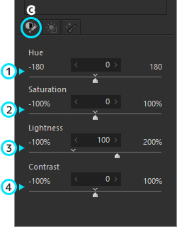

4.10.2. Adjusting with the sliders
Adjustments to each parameter value on standard controls, compared to the method of adjusting the color circle with the mouse, will be explained here.
  1. Enable checkbox
    Enable the fine color control.
  2. Hue adjustment
    Select a hue for adjustment from the dropdown list.
  3. Hue
    Set how much change in hue.
    Set the angle in counter clockwise rotation from the reference point.
  4. Saturation
    Set the ratio assuming that the distance from the center of the color circle to the reference point is 100%. When setting -20%, the operation point moves to the inside by 20%, and the saturation level is decreased. When setting 20%, the point moves to the outside by 20% and the saturation level is increased.
  5. Lightness
    Set the ratio assuming that the lightness of the reference point is 100%. When setting -20%, the lightness level is decreased, and setting 20%, it is increased.
  6. (Initialize)
    Return all points to the initial state.

* If the mouse cursor is over the preview image, the color the mouse cursor is pointing to will be displayed in a circle over the color circle.
Placing the mouse cursor where you want to adjust on the preview image will be an indicator of what color block would be good to adjust.

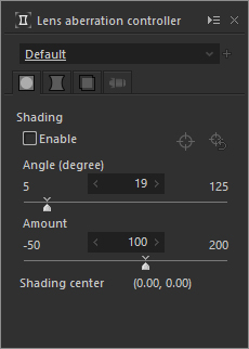

4.11.1. Shading (Peripheral Brightness Reduction) Correction
“Shading” corrections contained within the shading tab is a function to correct light falloff at edges, which is a characteristic of a lens, making an area around the object darker. Use two parameters to correct shading.
4.11.1.1. Angle of View
Input the diagonal angle of view of the lens at photographing.
Calculate and correct shading on lens design theory from this angle.
On a lens, light volume is decreasing toward the periphery area. The angle of view is larger in a wide-angle lens and smaller in a telescopic lens. Based on conversion to 35mm film format (full size digital single-lens reflex camera), the angle of view of a 50mm standard lens is approximately 46 degrees, that of a 135mm telescopic lens is approximately 18 degrees, and that of a 35mm wide-angle lens is approximately 63 degrees. When you input the angle of view,shading correction of a lens is performed through the calculation of logical lens shading.
However, it does not always match to the actual shading of the photograph. (Please refer to ‘4.11.1.3 Detail of Shading Reduction’) Please move the slider and find the best point using the value mentioned above.
4.11.1.2. Correction Ratio for Amount of Light
Input the ratio that you apply for the correction.
When you set the amount 0%, no correction is performed, and the amount 100%, the logical value calculated based on the angle is used. You can set the parameter up to 200%.
You can use this function to adjust the level of correction for the following cases. The case you want to remain the shading effect without complete correction since the shading is one of the tastes that are unique to a lens. Or a case that a bright object is on the periphery of a photo and when you make corrections it becomes too bright and lost.
You can also increase the shading level by setting minus value. Use the value to emphasize the center area on purpose by darkening the periphery, or to make the background quiet.

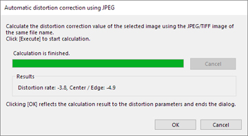

4.11.2.4. Automatic distortion correction using JPEG
This function calculates the distortion correction value using the JPEG image recorded when the photograph was taken.
In order to use this function, a JPEG image with distortion corrected must be recorded at the time the photograph is taken.
* This function is effective only for a single selected image.
* This function cannot be used when a JPEG / TIFF image is selected.
For the selected image, when there is a JPEG / TIFF image with the same file name as the RAW image to be corrected, the button will be activated.
If you click the button, the “Automatic distortion correction using JPEG” dialog will be displayed.
If you click the [Execute] button, the distortion correction values will be calculated.
When the calculation is complete, the results will be displayed.
Click [OK] to reflect the correction values to the “Distortion rate” and “Center/Edge” sliders and perform distortion correction,
This function analyzes the image to be corrected and performs calculations, so the correction results may vary between images photographed under the same shooting conditions using the same camera and lens.
If the aspect ratio, pixel count and angle of view differ between RAW and JPEG images, correction values may not be calculated correctly.

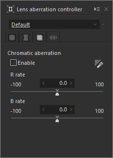

4.11.3. Chromatic aberration
“Chromatic aberration” corrections contained within the Chromatic aberration tab is a function that corrects lens characteristics such as when chromatic aberrations of magnification appear as coloring on the edges around the image.
The transverse chromatic aberration is caused by the difference in lens magnification rates for each colored light (red light, green light, and blue light) incoming to a lens.
The transverse chromatic aberration correction is performed by changing R and B magnification slightly.
First, enlarge the area, where the edge of an object in the image periphery is colored, to more than 400%, and display it. Then, decrease the color distortion in the “Noise reduction” sub-control (for example, 0 - 80). After that, check the “Chromatic aberration” checkbox to adjust the R rate and the B rate.
When you correct a picture, enlarge the periphery area as shown below to check the correction result and change parameters.
4.11.3.1. R rate
This adjusts the lens magnification for red light. If the edge is colored by red or cyan (complimentary color of red), change this parameter first.
4.11.3.2. B rate
This adjusts the lens magnification for blue light. If the edge is colored by blue or yellow (complimentary color of blue), change this parameter first.
When these two parameters are appropriate, coloring is decreased most.
First, look the edge condition and change the R rate so that “red <–> cyan” in the both sides of edge is decreased. Then change the B rate to adjust “blue <–> yellow” coloring. Repeat the R rate and B rate adjustments to find the best point.
Do not try to decrease coloring, but try to distribute the edge coloring uniformly. After that, when increasing the “Color distortion” slider in the “Noise reduction” sub-control, the remaining colors are disappeared. Increase the parameter until you are satisfied, and finish adjustments.
At this time, if colors still remain even after the color distortion is maximized, there is a possibility that transverse chromatic aberration is so big that it exceeds the correctable range or that coloring occurs because of aberration other than transverse chromatic aberration. For example, too light background shows a possibility of coma aberration.
At the present time, you can correct transverse chromatic aberration.
The Original Picture
Before Correction
After Correction

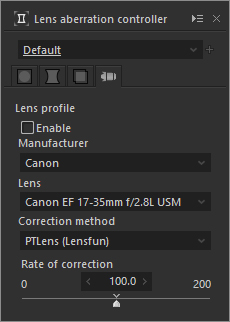

4.11.4. Lens profile
“Lens profile” found in the Lens profile tab is a function for performing automatic distortion correction based on the lens information prepared in advance.
SILKYPIX Developer Studio Pro10 / 10 uses the lens database that comes with Lensfun, an open source library, for lens information.
Please refer to the Lensfun website (English) for details on the Lensfun lens database.
To perform correction using the lens profile, turn ON the “Enable” checkbox.
* This function cannot be used for JPEG / TIFF images.
* To use this function, a dedicated data file must be created in advance from the lens database.
If there is no data file, the controls within the Lens profile tab will be disabled, and this function cannot be used.
Please refer to 4.11.4.5. About create data file for the lens profile for details.
* We are unable to respond to questions regarding the Lensfun lens database and lens information. We appreciate your understanding.
Lens profile controls are contained in the “Lens aberration controller” sub-controls, but lens profile parameters are handled independently.
However, the dropdown list of “Lens aberration controller” sub-control tastes and the colors of sub-control icons when parameters are edited will be shared.
Lens profile parameters will not be included when pasting development parameters.
4.11.4.1. Manufacturer
A list of lenses that can use the lens profile will be shown in a dropdown list.
Please select the manufacturer of the lens to which you wish to apply the lens profile.
If the appropriate lens profile could be identified from the Exif information of the RAW data, the manufacturer contained in that lens profile will be set as the default value.
If the appropriate lens profile could not be identified automatically, “Select manufacturer and lens” will be displayed.
The following messages may be displayed in the “Manufacturer” dropdown list.
  • “Data file does not exist”
    This message is displayed when the data file needed to used this function is not found.
    If a data file for the lens profile was not created when launching the software, this function cannot be used.
    Please refer to “4.11.4.5. About create data file for the lens profile” for information about the data file for the lens profile.
  • “Select manufacturer and lens”
    This message is displayed when the appropriate lens profile is not identified automatically from the Exif information of the RAW data.
    In this case, you can perform the correction by selecting the manufacturer and lens from the dropdown list.
    Please note, however, that the appropriate lens profile may not exist.
  • “This RAW cannot be corrected”
    This message is displayed when distortion correction using this function cannot be performed on the selected RAW data.
    SILKYPIX Developer Studio Pro10 / 10 always displays optimal development results for some RAW data without using this function.
    For this reason, automatic distortion correction using this function cannot be performed on such RAW data.
  • “Cannot use for JPEG/TIFF”
    This message is displayed when a JPEG / TIFF image is selected.
  • “Correction information not found”
    This message is displayed when the same lens profile as the one recorded in the development parameter file is not found.
    The applicable lens profile may have been deleted, or its name may have been changed, due to the lens database being updated or for other reasons.
    To correctly reproduce the adjustment results, a lens profile based on the same lens database information as the one when the adjustment was performed must be prepared.
    While you can select another dropdown list and apply a different lens profile, please note that the information recorded in the development parameter file will be overwritten and lost.
When you cannot use this function, controls within the Lens profile tab will be disabled.
4.11.4.2. Lens
A list of lenses for the selected manufacturer will be displayed in a dropdown list.
Select the lens to which you wish to apply the lens profile.
If the appropriate lens profile could be identified from the Exif information of the RAW data, the lens contained in that lens profile will be set as the default value.
4.11.4.3. Correction method
A list of correction methods available for the profile corresponding to the selected manufacturer and lens will be displayed in a dropdown list.
In many cases, only one method will be displayed, but multiple methods may be available depending on the profile.
If you are presented with multiple correction methods to choose from, select one that is the most suitable for correcting the selected image.
* Correction methods are displayed based on the lens profile information, so we are unable to provide information about how correction methods are selected or other details. We appreciate your understanding.
4.11.4.4. Rate of correction
You can adjust the rate of distortion correction performed based on the lens profile.
SILKYPIX Developer Studio Pro10 / 10 contains a Lensfun database file. To perform correction processing using the lens profile in a short amount of time, you need to create a dedicated data file in advance from the database.
This data file needs to be created when this software is launched for the first time or when the lens database is updated.
When a data file needs to be created, a message dialog confirming whether to create the file or not will be displayed (*).
If you select “Yes”, the lens database will be converted into a dedicated data file.
You may skip data file creation by selecting “No” when the message dialog is displayed.
Please note, however, that if the data file does not exist, controls inside the Lens profile tab will be disabled, and this function cannot be used.
* This message dialog is displayed when the “Create data file for the lens profile” checkbox in “Function settings” is turned ON.
When the checkbox is turned OFF, this confirmation message dialog will not be displayed even when a data file needs to be created.
Please refer to “1.3. Create data file for the lens profile” for details.

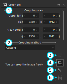

4.14. Crop tool
Use to create your work by cropping a part of an image in the photograph.
Cropping can be performed by switching tool mode in the preview display to Crop tool.
The “Crop tool” can be used only if the Preview window is displayed from either Preview display mode or Combination display mode.
Switching to tool mode can be performed by selecting [Tools (T)]-[Crop tool] from the menu, or by clicking on the icon in the sub-control icon, or by pushing [Ctrl] + [T].
When tool mode changes to “Crop tool”, the Crop tool sub-control will be displayed along with handles for controlling the frame lines that show the cropping area on the preview image.
When the image is cropped, a cropping mark will be displayed on the thumbnail.
To crop the image, first you can determine a cropping method from the Cropping method dropdown list.
You can freely crop the image, and can crop in accordance with the purpose of the output by fixing the aspect ratio.
There are three way to crop the image: Adjusting a handle displayed in the Preview window with your mouse; Adjusting parameters in the Crop tool sub-control; and dragging on the Preview window.
The cropping area has to be set for each image, but the Cropping method is common to each image as software settings.
4.14.1. How to Operate a Handle in Cropping Area
Cropping area can be set by using the mouse to operate handles displayed on the preview image.
  1. Set the area with each handle at every corner and every side.
  2. Move the area with the center handle.
  3. The cropping area is rotated 90 degrees when the rotation handle to the right of center is clicked.
* The cropping area is automatically adjusted so that the aspect ratio is always constant, except for when Cropping method is set to “Custom”.
4.14.2. How to Operate Crop Tool
  1. Cropping area
    Set a numerical value for the cropping area.
    • Upper left coordinates (x,y)
    • (B) Size (width x height)
    • (C) One coordinates (x,y) for the area
    • (D) The other coordinates (x,y) for the area
  2. Cropping method
    Select a method to crop the image.
    Select from “Custom”, “Constrain original proportion”, “Specify aspect ratio”, “Print size”, and “Fixed size (fixed aspect ratio)”.
    • Custom
      Designate when freely cropping the image.
    • Constrain original proportion
      Crop while maintaining the aspect ratio of the original image.
      Designate when cropped image and original image share the same aspect ratio.
    • Specify aspect ratio
      Designate when cropping to your own set aspect ratio.
      • (Set output size)
        When this setting is on, the numerical value of the aspect ratio set here is the default pixel size at the time of “Develop”.
        For example, if cropping is set here to 640:480, whatever value the size of the actual cropping, the default pixel size at the time of “Develop” will be set to 640x480.
        Enable this when the output pixel size is set and cropping will match it.
    • Print size
      Crop to the aspect ratio of the printing area for the currently set printing paper.
      Use this so there will not be any wasted space when printing.
      When designating this setting format, you must first complete printer settings.
    • Fixed size
      Crop to an aspect ratio of a standard size found on the list.
  3. Apply specified aspect ratio
    Automatically crop the image with the selected cropping method.
    If the aspect ratio is set, it crops to the designated aspect ratio.
  4. Initialize to default
    Set cropping area to the initial area.
  5. Crop image on preview
    Crop the image by dragging the mouse on the preview window.
  6. Extend processing area to entire recorded area
    Extend so that you can designate all areas recorded in RAW data as subject to processing.
4.14.3. Crop image on preview
Click the icon to switch to crop the image by dragging the mouse on the preview window.
Set a rectangle from the start point of the drag to the end point as the cropping area, following the Cropping method.
The rectangle from the start point of the drag to the end point will be the cropping area when Custom is selected as the Cropping method.
When other settings are selected, the aspect ratio of the cropping area is fixed.
The rectangle cropping area is automatically calculated and displayed from the location of the mouse while dragging.
4.14.4. Extend processing area to entire recorded area
With RAW data, information on an area a little larger than the area for development processing may be recorded as a photograph through default development processing.
This area is called the extension area.
Also, whiteout areas caused by “Distortion” from “Rotation/Shift lens effect” and “Lens aberration controller” are included in the extension area.
When Extend processing area to entire recorded area is on, the cropping area, including this extension area, can be set.
The size of extension areas varies according to the type of digital camera.
Also, black areas from no exposure and invalid images such as electronic noise may be recorded, depending on the type of camera.
Blank areas that occur as a result of edited parameters are processed in gray.

4.15. Monochrome controller
With the Monochrome controller, images are converted in black and white using two kinds of settings. You can make adjustments by using the “Color Filter” simulates the effect of designating a color filter on a lens, and “Lightness” adjusts the brightness of a specific hue.
Select [View (V)] - [Sub-controls] - [Monochrome controller] to bring up the Monochrome controller. You can also bring it up with the icon among the sub-control icons at the lower right.
If the Taste drop down list is set to “Default,” you can return to the status just before starting operations with the Monochrome controller.

4.17.3. Operation Methods
Each of the four operation modes, “Auto Erase”, “Copy”, “Eraser” and “Red Eye Correction”, are performed by left clicking the mouse over the “Spotting tools” sub-control preview display, and in the area inside the circle cursor in each mode.
You can remove dust and make red eye corrections by switching to operation mode and adjusting the size of the circle cursor.
  • [Operating Mode]
    • : Auto Erase
    • : Copy
    • : Eraser
    • : Red eye correction
  • [Tool effects]
    • : Wide pen
    • : Medium pen
    • : Thin pen
  • [Other Functions]
    • : Emphasize spotting areas
    • : Initialize spotting areas
4.17.3.1. Operation Modes
You can switch between the four modes, “Auto Erase”, “Copy”, “Eraser” and “Red Eye Correction”, while doing your work.
Switch operation modes using the , , and icons.
4.17.3.2. Tool effects
The effects of each tool, “Auto Erase”, “Copy” and “Eraser”, take place within the area shown in the circle cursor.
The effects of these tools are stronger in the center of the circle cursor and weaker near the edges, but you can choose from three degrees of strength.
Switch “Tool effects” using the , and icons.
However, you cannot select tool effects in “Red eye correction” mode.
4.17.3.3. Emphasize Spotting Areas
Emphasize the display of the area to which corrections were added to the image with “Spotting tools”.
Turn the emphasis display ON / OFF by clicking on .
Areas processed under “Auto Erase” or “Copy” mode are emphasized in red, while areas processed in “Red Eye Correction” mode are emphasized in green.
4.17.3.4. Initialize Spotting Areas
Initialize the “Spotting tools” parameters by clicking on .
Initialized parameters are different depending on the operation mode.
When in “Auto Erase” or “Copy” mode, dust removal parameters are initialized, and when in “Red Eye Correction” mode, red eye correction parameters are initialized.
When in “Eraser” mode, parameters for both dust removal and red eye corrections are initialized.

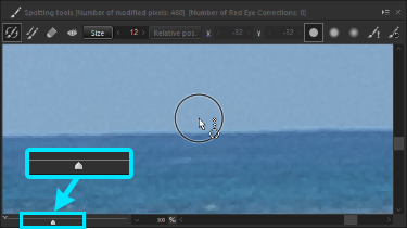

4.17.3.6. Changing Display Location / Magnification
The “Spotting tools” preview display can be displayed from 100%-1600% display magnification.
  1. Change controls on the “Spotting tools” sub-control
    Magnification changes are adjusted with the display magnification slider control.
    Display magnification cannot go below 100%.
    Adjust display magnification with the scroll bar.

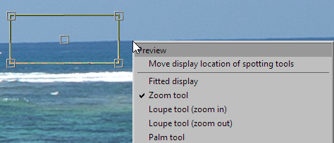

  2. Change the preview window’s navigation display
    Navigation display showing the area of the “Spotting tools” is executed on the preview window displaying the preview image of the selected image.
    You can adjust the display area by moving the handles on the four corners of the navigation frame and with the center handle.
    You can also move the display area of the “Spotting tools” to the location of the mouse pointer on the preview window.
    Display the context menu by right clicking and select “Move display location of spotting tools”.

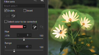

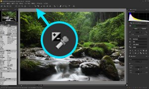

4.18. Partial correction tool
The Partial correction tool is a tool for designating areas to be corrected and for making corrections to parts such as shading and contrast within the area.
The main purpose is for making corrections on parts of images, such as raising brightness on expressions on some subjects darkened by backlighting, or for fine tuning the white balance on some subjects seeming to be to bright from reflected light.
To use the partial correction tool, either select [Tools (T)] - [Partial correction tool] from the menu, or switch to “Partial correction tool” mode with on the sub-control icon.
The “Partial correction tool” sub-control will be displayed when you switch to “Partial correction tool” mode.
The “Partial correction tool” sub-control is mainly divided into the following three sections.
* The position of the filter area created with the “Partial correction tool” does not follow the transformations and rotations of the image performed by the “Lens aberration controller” and “Rotation/Shift lens effect.”

4.18.1.2. Operate selected filter
Operate and manage the selected filter area.
For brush areas, set “Feather” and “Brush size” before drawing with the brush.
  • (1) Filter area
    The added filter area will be displayed.
    The filter selected here will be the area that can be operated at that time.
  • (2) Enable
    This activates the effects of filters selected in the “Filter area.”
    The selected effects will be removed if you remove the check mark.
  • (3) Invert
    The area where effects are applied and area where effects are not applied will be inverted in the filter selected in the “Filter area”.
  • a. “Basic tools” tab
    • (4) Add brush to the selected filter area
      When you click on , the brush area selected as the “Filter area” will turn into Edit mode, and you can add a brush and draw with it. (*1)
    • (5) Brush eraser
      When you click on , the brush area selected as the “Filter area” will turn into Edit mode, and you can erase the brush you had drawn. (*1)
    • (6) Duplicate selected filter area
      When you click the , it will duplicate the filter that is selected in “Filter area”.
      The filter is duplicated under conditions saved for filter size and each parameter in a location a little to the lower right from the filter center of the original.
    • (7) Delete selected filter area
      By clicking , only filters selected in the “Filter area” at that time will be deleted.
    • (8) Feather
      Adjust from “0” to “100” with the slider.
      You can adjust the shading degree on the borders of the designated area. (*2)
      By increasing the value of “Feather”, the shading increases and the effects taper off from the outside to the center.
      Conversely, by decreasing the value of “Feather”, there will be less shading and the boundary lines of the designated area appear more clearly.
    • (9) Brush size
      This can be set with the slider from “10” to “3000.”
      When drawing with a brush under “Add new brush,” “Add brush to the selected filter area,” or “Brush eraser,” you can adjust the size of the brush being drawn with.
      Set according to the area to be corrected.
      *1 This can be used when the filter selected in “Filter area” is the “Brush area.”
      *2 When used in the “Brush area,” set before drawing with the brush. You can not change the feathering after drawing with the brush.

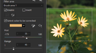

  • b. “Select color to be corrected” tab
    • (10) Select color to be corrected
      Set whether to enable the “Select color to be corrected” function.
      “Select color to be corrected” is a function that can specify a certain color to be corrected within a set filter area.
      For example, you can increase the lightness of only red within the area drawn with the brush, and decrease the saturation of only blue within the area where gradual correction filter is applied.
      Place a check here to enable the “Select color to be corrected” function.
    • (11) Select color
      Select a color to be corrected from the dropdown list.
      If you wish to set an approximate color, select one from the dropdown list.
      Colors set with the “Color selection tool” or “Hue” slider will be displayed in the dropdown list.
    • (12) Color selection tool
      This is a tool for directly specifying a color to be corrected on a preview image.
      You can enter the “Color selection tool” mode by clicking .
      If you specify an area by clicking or dragging over the preview of a selected image, the average color of that area will be set as the color.
    • (13) Preview of selected color
      Reflect the selected color on the preview image.
      Color will be maintained only in the areas corresponding to the selected color within the filter area, and all other areas will be displayed in monochrome.
      Click to turn ON or OFF the preview.
    • (14) Hue
      Set the hue of the color to be corrected with a slider.
    • (15) Range
      Using a slider, set the range of the color to be corrected where the color set with the “Hue” slider is the center.
      Reducing the range will narrow the range of the color to be corrected, and increasing the range will widen the range of the color to be corrected.
      Set an appropriate range while using “Preview of selected color”.
4.18.1.3. Parameters Available for Adjustment
Indicate parameters that can be used to adjust the selected filter area.
  • c. “Color / Contrast” tab
    • (1) Hue
      You can adjust from “-180” to “180” with the slider.
      This changes the relative hues within the designated area.
    • (2) Saturation
      You can adjust from “-100%” to “100%” with the slider.
      The higher the chroma, the more brilliant the colors appear, but if the colors are already brilliant, they may become saturated and you may lose details.
      When adjusting chroma, check the overall vividness of the colors. It is necessary to adjust so that the vividly colored parts are not saturated and details are not lost.
    • (3) Lightness
      You can adjust from “-100%” to “200%” with the slider.
      The default value of lightness is 100%. Lightness decreases as this value lowers.
    • (4) Contrast
      Contrast means the difference between bright area and dark area.
      When increasing the contrast, the bright area becomes brighter and the dark area becomes darker, i.e. high contrast.
      On the contrary, when decreasing the contrast, difference between the bright area and dark area becomes smaller, i.e. low contrast.
  • d. “White Balance Adjustment” tab
    • (5) White Balance Adjustment
      You can also adjust white balance in detail by numerical value.
      * “White balance target” control is based on the accurate color space.
    • (6) Initialize white balance target
      Click to set white balance target to the default value.

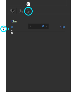

  • e. Effects tab
    • (7) Blur
      You can adjust from “0” to “100” with the slider.
      Applies a blur effect to the specified area.
      The higher the value, the stronger the blur effect.

4.18.2.4. Curve / Polygon area
  1. Activate the “Partial correction tool” sub-control and click “Add curve” or “Add polygon” .
  2. Click on the preview to add points. When three or more points are added, a curve or polygon connecting the points will be displayed.
    Click on the preview around the range you wish to correct.
    Right-click to delete the last point you set.
  3. Double-click at the end to confirm the set area(*1).
  4. This area is added to “Filter area” as an item named “Curve area 1” or “Polygon area 1”.
    The designated area is displayed as a curve or polygon connecting points.
    You can make fine adjustments to the area by operating the center or points of the area.
    Right-clicking on a point will delete it.
  5. Once an area is set, operate the items in the “Partial correction tool” sub-control to perform correction.
  6. If there are more areas you wish to adjust, perform steps (1) through (5) to create a new curve or polygon area to operate.
    Each time you repeat steps (1) through (5), a new area will be added to “Filter area” (e.g., “Curve area 2”, “Curve area 3”, and so on).
    *1 Curve and polygon areas cannot be set in a way in which sides intersect.
    If there are intersecting sides when points are added, the color of the curve or polygon will change to pink, so make sure there are no intersecting sides when confirming the area.
4.18.3. How to use adjustment using “Select color to be corrected”
By using the “Select color to be corrected” function on a filter area, you can specify an area in an image and change the color of only that area, or retain only certain colors and turn the other areas into monochrome.
Here, we will introduce an example of how to make adjustments using the “Select color to be corrected” function on a filter area.
How to make adjustments using 'Select color to be corrected'
Adjustment steps
  1. Add a filter area by encircling the area to be corrected.
    In this example, a flower drawn with a brush is set as an area to be corrected.
    If you add a filter area, the entire specified area will be set to be lighter at first.
  2. Switch to the “Select color to be corrected” tab and set the color to be corrected.
    The color to be corrected can be specified using any of the following three methods.
    • Select an approximate color from the “Select color” dropdown list
    • Select a color in an image using the “Color selection tool”
    • Set a value directly using the “Hue” slider in the “Select color to be corrected” tab
    By directly selecting a color in an image using the “Color selection tool”, you can make adjustments intuitively.
    Here, we will select the petal area using the “Color selection tool”.
    “Select color to be corrected” will be enabled, and the color selected as the color to be corrected will be set.
  3. By clicking “Preview of selected color”, you can check the selected color on the preview image(*).
    The area shown in color is the selected color.
    In this example, the tip of the petal is not completely inside the selected color area, so the “Range” slider value will be increased so that the petal will be shown entirely in color.
    The selected color has now been set.
    * Note that the “Preview of selected color” function is a function for displaying areas other than the selected area in monochrome, and is not an adjustment parameter.
  4. Clear “Preview of selected color” and adjust parameters.
    The example on the right shows the flower area in a different color by adjusting the “Hue” and “Saturation”.
    The example on the right shows the image with the selected color inverted by placing a check in “Invert”, after completely removing the saturation of the flower area by setting “Saturation” to -100.
    Color is retained only in the flower area, with all other areas in monochrome.

4.20. Image properties
Change properties of currently selected image
Select [View (V)]-[Image properties] from the menu.
The “Image Properties” sub-control is also a control for viewing image property information, but there is also a function for simultaneously editing image properties.
If photographic information recorded in the RAW data is incorrect, you can correct it or add information not recorded.
You can edit comments here.
You can also add information based on IPTC (International Press Telecommunications Council).
You can also make settings that do not record only specific information.
Contents edited here are recorded in JPEG / TIFF images development results by SILKYPIX .
Image Properties
4.20.1. File information
File information for the selected image file is displayed.
Editing is not available for items in this category.
Information related to the file format is displayed in “UniqueInfo”.
Refer to this information when a selected image is not shown in the preview display, because information may be displayed if it is a format not supported by SILKYPIX or if the file is corrupted.
“Editing date and time” displays the date and time of the latest edit by SILKYPIX.
This is the edit date and time development parameter that SILKYPIX automatically records. It is not displayed for images that have not had development parameters edited or for initial development parameters.
4.20.2. Data information
This is mainly information recorded in Exif information for RAW data and JPEG / TIFF images. Information related to the image and secondary information on the image is displayed here.
“UserComment” and “Rating” are items that can be edited.
4.20.3. Image information
This is mainly information recorded in Exif information for RAW data and JPEG / TIFF images. Photographic information such as camera settings at the time the photograph was taken is displayed here.
“DateTime”, “ISO Speed”, “ShutterSpeed,” “ApertureVal”, “FocalLength” and “Lens” can be edited.
You can freely edit items such as corrections to incorrect dates and times set on the camera or when photographic information is not correctly recorded such as when you use a manual lens.
When recording to a developed JPEG / TIFF image, the “Name of Lens Used” is recorded in a standard format to XMP, while other information is recorded as Exif information.
4.20.4. GPS
Positional information such as from GPS is chiefly found in information recorded in RAW data and Exif information in JPEG/TIFF images.
It is possible to edit each item.
4.20.5. IPTC
Information is edited based on IPTC (International Press Telecommunications Council).
If IPTC information is recorded to RAW data or JPEG / TIFF images under IPTC standards and/or XMP standards, it is displayed as initial values.
If recorded to developed JPEG / TIFF images, it is recorded under a format based on both IPTC and XMP standards.
4.20.6. Editing Items
Some image property items can be edited.
Edited contents are reflected in additional information when saved to developed JPEG / TIFF images.
Utilize this for corrections to image property recorded in RAW data, for adding unrecorded information or if not recorded as additional information when saving developed JPEG / TIFF images.
Items that can be edited have one of the following icons displayed on the right side of “Information.”
Items that do not show an icon cannot be edited.
  • : Show items that are unedited from their initial values. There are some cases where initial values are not set.
  • : Show edited items.
  • : Show items where the “Do not record when developing” setting was explicitly performed. This item is not recorded as secondary image information when saving developed JPEG / TIFF images.
To edit an item that can be edited, place the mouse over the item and click on displayed on the left side, or double click on the “Information” cell.
An edit item dialog will appear.

4.20.7. IPTC Information Taste
You can create tastes for IPTC information.
You can easily recall them by recording IPTC information you often use as a “Taste.”
Please see “4.1.1. Taste” for details on how to use tastes.
