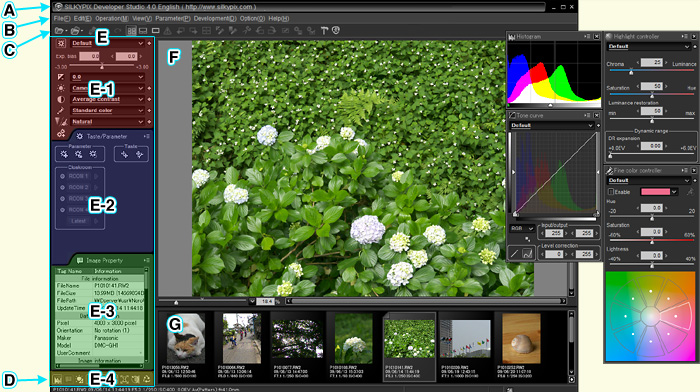

0.1. Section Names An overview of section names and operation methods of the SILKYPIX® screen display will be explained. 0.1.1. Entire SILKYPIX Display ![]() The SILKYPIX® display is composed of the following elements.
The basic windows in this software are composed of the following parts.
Sub-controls for adjusting development parameters and windows for displaying status can be displayed as windows independent of the main window. These are collectively known as floating windows in this software.
These are windows that temporarily display various setting dialogs, setting changes, etc.
Message boxes are displayed while running the software in cases such as special processing, when an error occurs or when you are asked to select the next operation from multiple choices. Messages displayed here are assigned their own message numbers. Please make note of this message number if there is a problem, such as when an error occurs. You may be able to use the troubleshooting sections in the manual or on our company's home page. The Menu Bar is an interface from which you can select and execute various operations from the SILKYPIX menu. Sub-menus for each menu item are displayed in dropdown form when you click on an item from the Menu Bar. Each item on the Menu Bar is an entry point to locating menu items. They are categorized so that menu items are easy to find.
![]() Icons for functions that are frequently used are located in the tool bar.
0.1.5. Sub-control Sub-controls are controls for detailed adjustments to development parameters. 0.1.6. Sub-control icon Located on the tab page of parameter control or displayed as a floating window, each category of development parameters has separate sub-controls. (*1) Selection / adjustment to parameters through sub-controls are mainly composed of controls for adjusting numerical values using sliders and edit boxes, dropdown lists and check boxes. Please see "0.1.7. How to Operate GUI" for operation methods.
