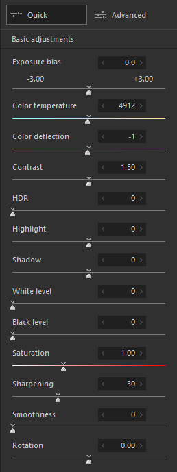

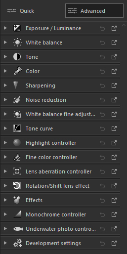

4.1. “Parameters Controls” and “Sub-control”
The parameters controls are arranged in order from the top with dropdown lists and parameter adjustment buttons (*1).
Additionally, a Quick/Advanced (*2) button is provided to switch the control box, where sub-controls for various parameter adjustments are lined up.
The dropdown list is the GUI for selecting a taste (=preset value) that is prepared in advance by our company or a user.
The “taste” is a value consisting of development parameters. For more details about the “taste”, please refer to ‘4.1.1. Taste’.
*1 Please refer to the “4.1.3. Parameter adjustment buttons” for details of parameter adjustment buttons.
*2 Please refer to “4.1.4. Quick/Advanced” for details of Quick/Advanced.

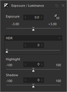

*1 It is not available in the “Exposure / Luminance,” “Underwater photo controller,” or “Development settings” sub-controls.

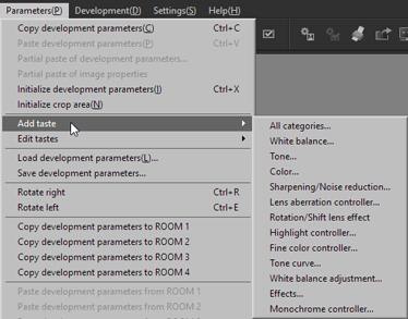

4.1.1.3. Add taste
You can add / register a development parameter applied to a currently selected image as a taste.
There are two ways to add / register a taste.
Select [Taste category] from [Parameters (P)]-[Add taste] on the menu, or click on the icon located on the right side of the dropdown list.
The “Add parameters taste” dialog will be displayed.
The “Add parameters taste” dialog format is the same as the “Edit parameters tastes” dialog.
Please see the next section, “4.1.1.4. Edit tastes” concerning operation methods for this dialog.
“Tastes” added through the “Add parameters taste” dialog will be displayed in dialogs as selected, so set an appropriate name for the taste and click on the [OK] button to confirm.

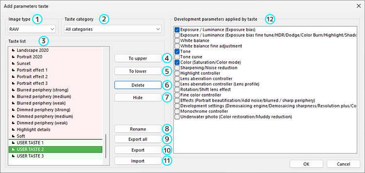

You can edit registered tastes.
You can customize by changing taste names and the order they are displayed to make it easier to select tastes.
You can also save / restore tastes and move then to other PCs through export and import functions
“Add parameters taste” is performed from [Parameters (P)]-[Edit tastes]-[Parameters tastes] on the menu.
  1. Subject data
    A taste is defined for a “RAW” or a “JPEG/TIFF/HEIF”. You can select either of the two types.
  2. Taste category
    A taste is defined for each parameter category.
  3. List of tastes
    There is a list of tastes with a mark.
    • A mark at the left of a taste title:
      The taste represents all development parameters if you select taste category “All parameters”.
      The taste only part of the parameters if you select taste category “All parameters”.
      There are two kinds of tastes, maker tastes created in advance by our company, and user tastes that you create.
    • Maker taste
      These are displayed with a red background.
      They cannot be deleted, exported or moved.
    • User taste
      These are displayed with a green background.
  4. Upward button
    The upward button moves a selected taste upward.
  5. Downward button
    The downward button moves a selected taste downward.
  6. Delete button
    The Delete button deletes selected tastes.
    Maker tastes cannot be deleted.
  7. Hide / Show button
    Selected data is hidden.
    Maker data cannot be deleted, but they will not be displayed on the list of tastes with this setting.
  8. Rename
    Change the name of selected tastes.
  9. Export all button
    All user tastes that have “Image type” and “Taste category” in common are recorded and saved in a file.
    All tastes displayed with a green background are “Taste list”.
  10. Export button
    The export button exports a single selected taste.
  11. Import button
    The import button imports a saved taste.
  12. Development parameters applied by taste
    When you select the “All parameters” in the list of the taste category, you can apply any of the parameter categories to a taste. For example, you can apply “tone” and “tone curve” to a taste.
When you add a new taste, the “Edit parameters tastes” dialog is also displayed and you can customize a name of a new taste and other settings as well as the taste customizing.

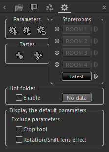

4.1.2. Tastes/Parameters
You can perform taste registration and editing, save development parameters, read, initialize and temporarily register in the “Tastes/Parameters” sub-control.
In the initial placement, it is located in the tab on the left side of the main window.
It can also be displayed from [View(V)]-[Taste Parameters] in the menu.
4.1.2.1. Storerooms
The “Storerooms” is a function that temporarily records development parameters.
There are four rooms (ROOM 1-4) in which you can record development parameters. There is also a special room named “Latest”.
You can record optional development parameters in the first four rooms.
Development parameters for the currently selected image are recorded in a room by clicking the o button on the left side.
When development parameters are recorded in a room, the time they were recorded is displayed.
Rooms with recorded development parameters are turned into buttons, and when you click this button, the development parameters recorded in the room are pasted onto the currently selected image.
In this way, you can copy development parameters from other images and past development parameters from the same image.
Rooms with recorded development parameters that match the development parameters of the currently selected image are displayed in bold.
The icon on the right side is a button for entering “Continuous paste tool”.
“Continuous paste tool” is a mode for pasting development parameters recorded in a room to multiple images. Click on a scene in the thumbnail display to paste development parameters.
In order to leave this tool, click on the icon again.
The special room, “Latest”, located at the bottom always stores the latest edited development parameters.
Use this when you want to paste the latest results from adjusted development parameters to other images.
There are several convenient ways to use the “Storerooms”.
Please see “6.5. How to Use Storerooms” for details.
4.1.2.2. Hot folder
“Hot folder” is a function for monitoring a selected folder and automatically adding images to thumbnails if an image for processing is added.
This function can be used only when a single folder is selected.
By clicking on a button reading “No data” within the border of the “Hot folder”, the development parameter of the selected image will be registered and a check will appear in the check box next to “Enable”.
While “Enable” is checked, images to which registered development parameters are applied are automatically added.
The check next to “Enable” is automatically removed when the selected folder is changed.

4.1.4. Quick / Advanced
Below the Parameter adjustment buttons, there are Quick and Advanced toggle buttons.
Switching the button selection changes the contents of the control box below accordingly.
4.1.4.1. Quick
“Quick” consists of controls that aggregate only the frequently used parameters from the “Advanced” adjustment items available in SILKYPIX Developer Studio Pro12.
Adjusting from top to bottom allows for quick basic adjustments.
Since only the main parameters are collected, balancing adjustments is made easier.
The parameters in “Quick” and “Advanced” are interlinked and work together.
Therefore, you can perform basic adjustments in “Quick” and then switch to “Advanced” for additional adjustments.
The parameters adjustable in “Quick” are as follows.
The values in parentheses indicate the corresponding parameter categories in “Advanced”.
*1 This adjustment applies to the selected item in the “Dodge / Color Burn / HDR” section of the “Exposure / Luminance” sub-control.
For example, if “Dodge” is selected, it functions as the Dodge slider.
*2 This adjusts the saturation of the selected item in the “Profile” and “Color Representation” sections of the “Color” sub-control.
*3 This adjustment applies to the selected “Type” in the “Sharpening” sub-control.
It is linked to the value of the first slider in the “Sharpening” sub-control.
*4 This adjustment applies to the selected “Mode” in the “Noise Reduction” sub-control.
4.1.4.2. Advanced
“Advanced” contains all parameter sub-controls, excluding tools, available for adjustment in SILKYPIX Developer Studio Pro12.
The sub-controls arranged in “Advanced” are as follows.
  1. Exposure / Luminance
  2. White balance
  3. Tone
  4. Color
  5. Sharpenning
  6. Noise reduction
  7. White balance fine adjustment
  8. Tone curve
  9. Highlight controller
  10. Fine color controller
  11. Lens aberration controller
  12. Rotation/Shift lens effect
  13. Effects
  14. Monochrome controller
  15. Underwater photo controller
  16. Development settings

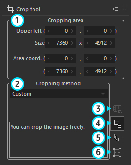

(C) - (2) Crop tool

4.3. Exposure / Luminance
Adjust the brightness of images.
In exposure correction, the brightness of an entire image will be adjusted.
If the entire image is too dark or too bright, it can be adjusted to the appropriate brightness.
In Dodge / Color Burn / HDR and Highlight / Shadow, the brightness of light and dark areas is adjusted.
Objects with considerable differences in brightness can be adjusted to an appropriate balance, and dark areas that are hard to see can be made brighter so that they can be seen.

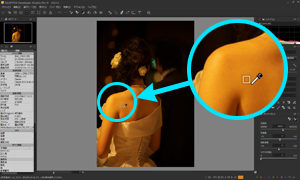

4.3.1.4. Exposure bias tool

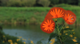

Exposure bias tool allows you to adjust the brightness of a specified point to a certain exposure level. To adjust exposure level, you select “Exposure bias tool” from the menu [Tools (T)]-[Exposure bias tool], or click on the top toolbar.
When you designate an area by either clicking or dragging on a preview image or thumbnail of a selected image, “Exposure bias tool” adjusts the brightness of the selected area to become the “luminance level”. The “luminance level” is specified as the photosensitive level on the RAW data. You can change it in the “Function settings” dialog. Please refer to ‘9.3.1.2. Luminance level of exp. bias tool’ for more details.
This function works effectively even when a specified point is not achromatic color. In that case, the largest value of R, G, or B is selected as a target value and the exposure is set to the “luminance level”.
For example, when you click the red area, this feature sets an “exposure bias” such that the R value becomes the “luminance level”.
* About eyedropper operation, please refer to ‘9.3.2. Operations’.

4.3.3. Highlight / Shadow
In Highlight / Shadow, the brightness of the bright and dark areas of an image is adjusted.
This software analyzes images and automatically identifies bright and dark areas.
Dark areas that are hard to see can be made brighter so that they can be seen, and discontinuity In the tone of clouds can be restored.
4.3.3.1. Highlight
Adjust the brightness of the bright areas of images.
Adjustments can be made by selecting adjustment values using the Highlight slider.
4.3.3.2. Shadow
Adjust the brightness of the dark areas of images.
Adjustments can be made by selecting adjustment values using the Shadow slider.

4.4.2.1. Auto area specification tool
Auto white balance analyzes the whole image area to calculate the white balance.
Normally, you can use Auto white balance to get the proper white balance.
However, in scenes where there are multiple light sources in the image, the white balance may not be adjusted as intended.
In such scenes, you can specify an area for auto white balance calculation using the Auto area specification tool to obtain a white balance that focuses on the light source in that area.
When you select Auto (Absolute), Auto (Natural), or Auto (Underwater) for white balance taste, the Auto area specification control in the White balance sub-control will be enabled.
* This function is effective only for a single selected image.

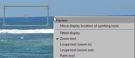

Click the “Auto area specification tool” button or select [Tools(T)]-[Auto area specification tool] from the menu to enter the Auto area specification tool mode.
A frame indicating the Auto area will appear on the preview, and you can drag the handles on the four corners and sides of the frame to set the area.
Drag the center handle to move the area.
When you finish dragging an area, the auto white balance calculation will be performed and the white balance value will be set based on the specified area.
When you have finished setting the Auto region, click the “Auto area specification tool” button again, or select [Tools(T)]-[Auto area specification tool] from the menu to exit the tool mode.

4.4.4. Gray balance tool
This is a tool for adjusting white balance, targeting the gray subjects that appear in the photograph.
To adjust white balance in the “Gray balance tool” mode, you click “Gray balance tool” on the “White balance” sub-control, select “Gray balance tool” from the menu [Tools (T)]-[Gray balance tool], or click on the top toolbar.
Then, click or drag the area that you want to change gray to specify the range. The white balance will be set to express that area in gray.
When there is a gray object in a photo, you can easily adjust the white balance with this function. Taking a photograph of a gray chart or white paper in advance may be very helpful.
* For eyedropper operation, refer to ‘9.3.2. Operations’.
4.4.5. Skin color tool
This is a tool for adjusting the skin of a person appearing in the photograph to an “expected pretty skin color”.
You can switch to “Skin color tool” with the button on the “white balance” sub-control, the menu command [Tools (T)]-[Skin color tool], or the icon on the top toolbar. In the “Skin color tool” mode, you can click or drag a rectangle area at the target skin on the preview, then the target area is automatically adjusted to beautiful skin color and also exposure bias is adjusted.
This tool is used at the same time as adjusting white balance and exposure bias.
There are times when adjusting skin color does not change as expected with one operation.
If the result is too red, green, or blue, please click that area again. By a few repeatable operations, you can find out the suitable skin color. Then you can additionally adjust “White balance adjustment”, “Exp. bias fine tune”, or “Tone” for fine-tuning. If you use this tool on the woman’s face, please avoid the emphasized make-up area. Basic foundation area, especially dull color area is suitable for picking up,
* To adjust skin color continuously, you need to check “Enable Continuous Operation of Eyedropper Tool” on the “Function settings” dialog. Please refer to “9.3.2. Operations” for detail.

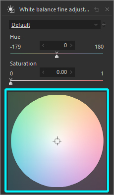

4.4.9. White Balance Fine Adjustment

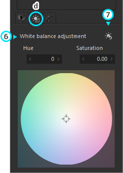

Use this function when you want to adjust the white balance at the final stage of your workflow, e.g., tinting. You can adjust white balance in detail with this sub-control, which has a “white balance target” graphic control, a “saturation” slider, and a “hue” slider.
  1. White balance target
    This graphic control is based on the accurate color space. You can set the white balance visually by clicking a mouse directly.
    • [Mouse wheel operation]
      You can change the “saturation” parameter by holding the [Ctrl] key and using the mouse wheel on the white balance target.
      With [Ctrl] + [Shift] keys, you can change the “hue” parameter.
    * If the “Enable the mouse wheel operation on the control to change parameters” setting is enabled, holding the [Ctrl] key will not be necessary.
    Please refer to “9.3.2. Operations” for more details.

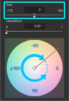

  2. “Hue” slider
    It shows the angle from the right hand side of the white balance target in clockwise. Move the slider to change the angle in detail. You can specify the setting value indicates:
    • 0
      right from the center
    • 90
      downward from the center
    • 180 (-180)
      left from the center
    • -90
      upward from the center
      lower half from the center
      upper half from the center

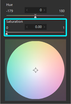

  3. “Saturation” slider
    It shows the radius from the center of the white balance target. Move the slider to change the radius in detail. The range is 0.00 to 1.00 (0.00 is the center of the white balance target, 1.00 is the maximum radius).

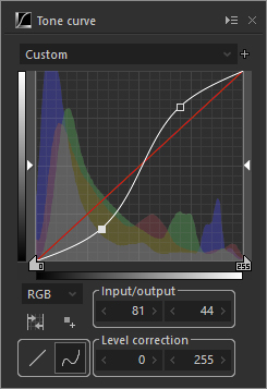

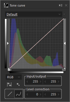

4.5.3. Tone Curve
The “Tone curve” is a tool for making minute adjustments to tone expression after completing adjustments to other biases and for converting brightness for effect.
Bias from the “Tone curve” is reflected after other bias processing is performed and converted to the color space on the output color space of development settings.
Therefore, for example, if you set monochrome to color, when you adjust R, G and B separately on the Tone curve, this will not be monochrome, or if you change the output color space in the development settings, you will have to make readjustments to match the color space. Keep this point in mind when you use this.
You can set the curve (= Tone curve) that converts brightness on this sub-control.
The horizontal axis means input (brightness of source picture) and the vertical axis means output (brightness results of a picture after adjustment). You can control lightness in a picture by operating this curve.
* By dragging window’s frame of the “Tone curve” sub-control, you can adjust a size of the dialog.
In addition, by dragging it while pressing the Shift key, you can adjust the size while fixing the aspect ratio of it.
4.5.3.1. Selecting a Taste
Several tastes that have good effects are included as Maker Tastes in tastes.
There are also special items such as “Initialize” and “Initialize all” within the tastes of the tone curve.
“Initialize” initializes only the tone curve of the selected channel (all RGB, R, G, B or L), while “Initialize all” initializes all five tone curves.
4.5.3.2. Editing Points
The curve is drawn as passing through a point, and you can operate the curve by moving the point.
Selected point information is displayed on the “Input / Output” control.
You can move the point by editing the value in this control or by dragging the point on the tone curve.
  1. Adding Point
    Click the mouse on a graph to place a point at the position.
    You can also click to switch to a mode that will add a point to the tone curve and add a point from the preview display.
  2. Selecting a point
    Select a point for operations.
    The selected point is displayed with .
    You can switch selections by clicking the point with the mouse.

4.5.3.3. Control explanation
  1. Channel selection
    Select a channel for processing.
    The process is reflected in order of tone curve settings for each R, G, B, and L first and then tone curve setting for RGB.
    • RGB
      Set gradation process for all RGB values with the tone curve.
    • R
      Set gradation process for R value with the tone curve.
    • G
      Set gradation process for G value with the tone curve.
    • B
      Set gradation process for B value with the tone curve.
    • L
      Set gradation process for L (Luminance) value with the tone curve.
    * When changing tones, colors are changed with brightness on tone curves combined with general RGB channels.
    Because you can adjust only the tone of brightness with the L tone curve, color omissions and changes in chroma are decreased, even when using high key or high contrast, for example.
  2. Add point
    Switch to a mode for adding a point to the tone curve.
    The point clicked on the preview display adds a point to the tone curve.
    By clicking the point while pressing the Ctrl key, you can add a point on all tone curves of RGB, R, G, B, and L.
  3. Linear
    Create a tone curve at the interpolation of a straight line between points.
  4. Curve
    Create a tone curve at the interpolation of a curved line between points.
  5. Input / output
    Edit selected point coordinates.
  6. Level correction
    Edit input range of level correction.
  7. Automatic level correction
    This is a function that automatically adjusts level correction on the currently selected channel.
    It recognizes the image’s histogram and adjusts the level correction so that shadows and highlights are to the set ratio.
    Ratios of shadows and highlights can be set at “Function settings”.
    Please see “9.3.1.7. Set automatic level correction” for details.
    * The “Add point” function works only when the tone curve is monotone increase or monotone decrease.
  • [How to use “Add point” function]
    Click “Add point” button to add the target tone point on the tone curve.
    1. Select the target image on the preview window.
    2. Display the “Tone curve” sub-control and click on the “Add point” button.
      Switch to a mode to add a point on the tone curve.
    3. Click the target point on the preview image.
    4. Then the target point is added on the tone curve.
    5. Move the point and adjust the tone curve.
      Moving the point edits the coordinate value by dragging the point on the tone curve or with the “Input / Output” control.
    6. Then the tone curve that you adjusted is applied to the target image.

4.9. Highlight controller
Highlight controller function controls color creation in highlight area.
This function controls a color clip in the highlight area, where one of color components (R, G, or B) is saturated. There are several types of controls. The “Chroma/Luminance” and the “Saturation/Hue” controls impact on the area where at least one of color components is saturated. The “Luminance restoration” control restores the lightness of the area that were clipped at capture. Combined with under exposure bias adjustment, you can restore gradation to areas that have clipped.
You can restore gradation to areas that have been whiteout.
* “Color reproduction” and “Gradation” has been greatly improved in SILKYPIX Developer Studio Pro 7. Because the developing engine has improved, when reading development parameters for Highlight controller from SILKYPIX Developer Studio Pro 6 or earlier versions, results from Highlight controller processing will differ from earlier products.
If development effects are different from what you desire, please readjust on SILKYPIX Developer Studio Pro12. We apologize for the inconvenience.
When applying development parameters from earlier versions, icons will be displayed in Thumbnail window and in the status bar.
Please see “3.8. Icons that show status of image” to see if development parameters from previous versions are applicable.
4.9.1. Emphasis on Chroma/Luminance
Chroma/Luminance controls the priority of chroma or luminance to create colors in the highlight area.
The following pictures were developed based on the RAW data with highlight area (flowers). They were developed with chroma, luminance, or intermediate between Saturation/Tone.
Chroma emphasizes the colors of the flowers, and “Luminance” controls the highlight area effectively to emphasize the glare of the reflected light.
Chroma (value: 0)
Intermediate (value: 25)
Luminance (value: 100)

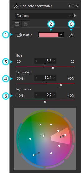

4.10.1.2. Adjusting with the sliders
Adjustments to each parameter value on standard controls, compared to the method of adjusting the color circle with the mouse, will be explained here.
  1. Enable checkbox
    Check this box to enable the “Basic” adjustment of the Fine color controller. If unchecked, the “Basic” adjustment of the Fine color controller will be disabled while the set values will remain unchanged.
  2. Hue adjustment
    Select a hue for adjustment from the dropdown list.
  3. Hue
    Set how much change in hue.
    Set the angle in counter clockwise rotation from the reference point.
  4. Saturation
    Set the ratio assuming that the distance from the center of the color circle to the reference point is 100%. When setting -20%, the operation point moves to the inside by 20%, and the saturation level is decreased. When setting 20%, the point moves to the outside by 20% and the saturation level is increased.
  5. Lightness
    Set the ratio assuming that the lightness of the reference point is 100%. When setting -20%, the lightness level is decreased, and setting 20%, it is increased.
  6. (Initialize)
    Return all points to the initial state.

Click the “Hue selection tool” button to enter the Hue selection tool mode.
Select the color to be adjusted on the preview.
When a color is selected, the selected hue will be set in the adjustment hue.
In addition, the color gamut to be adjusted, centered on the added hue, will be displayed as a white border on the color circle.
On the color circle, you will see the “Source” point (a), indicated by the black circle.
By dragging the “Source” point, the “Destination” point (b) (indicated by the white circle) will appear, and you can adjust the Hue and Saturation in the color circle.
Hue and Saturation can also be adjusted using the slider controls.
Lightness can be adjusted with the slider control.
Change the “Gradation” setting according to the adjustment purpose.
The white border on the color circle can be dragged in the © Hue and (d) Saturation directions to expand or narrow the color gamut to be adjusted.
Set the range to be adjusted while checking the adjustment result in the preview image.

* If the mouse cursor is over the preview image, the color the mouse cursor is pointing to will be displayed in a circle over the color circle.
Placing the mouse cursor where you want to adjust on the preview image will be an indicator of what color block would be good to adjust.

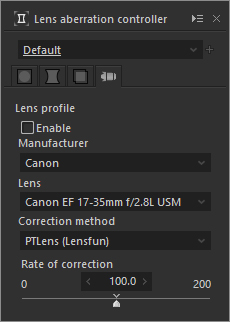

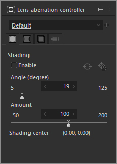

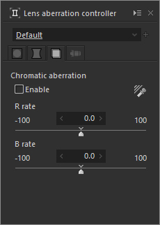

4.11. Lens Aberration Controller
Lens aberration controller is a function to correct lens aberration at development in order to create high quality image.
Photo lenses have aberration. Today, the resolution of digital camera has improved, therefore, lens aberration may have a damaging effect on the picture quality. There are various kinds of lens aberration such as spherical aberration, coma aberration, astigmatism, curved field, distortion aberration, axial chromatic aberration, chromatic aberration of magnification, and shading reduction that is a decrease of light volume occurring in the periphery. To adjust these aberration three corrections are available: shading, distortion, and chromatic aberration.
Tabs corresponding to the above three correction functions and the “Lens profile” tab for performing distortion correction using the lens profile are displayed in the “Lens aberration controller” sub-control.
When adjusting each parameter, select either the Shading (peripheral light quantities) tab, the Distortion tab, the Chromatic aberration tab, or the Lens profile tab.
4.11.1. Shading (Peripheral Brightness Reduction) Correction
“Shading” corrections contained within the shading tab is a function to correct light falloff at edges, which is a characteristic of a lens, making an area around the object darker. Use two parameters to correct shading.
4.11.1.1. Angle of View
Input the diagonal angle of view of the lens at photographing.
Calculate and correct shading on lens design theory from this angle.
On a lens, light volume is decreasing toward the periphery area. The angle of view is larger in a wide-angle lens and smaller in a telescopic lens. Based on conversion to 35mm film format (full size digital single-lens reflex camera), the angle of view of a 50mm standard lens is approximately 46 degrees, that of a 135mm telescopic lens is approximately 18 degrees, and that of a 35mm wide-angle lens is approximately 63 degrees. When you input the angle of view,shading correction of a lens is performed through the calculation of logical lens shading.
However, it does not always match to the actual shading of the photograph. (Please refer to ‘4.11.1.3 Detail of Shading Reduction’) Please move the slider and find the best point using the value mentioned above.
4.11.1.2. Correction Ratio for Amount of Light
Input the ratio that you apply for the correction.
When you set the amount 0%, no correction is performed, and the amount 100%, the logical value calculated based on the angle is used. You can set the parameter up to 200%.
You can use this function to adjust the level of correction for the following cases. The case you want to remain the shading effect without complete correction since the shading is one of the tastes that are unique to a lens. Or a case that a bright object is on the periphery of a photo and when you make corrections it becomes too bright and lost.
You can also increase the shading level by setting minus value. Use the value to emphasize the center area on purpose by darkening the periphery, or to make the background quiet.
4.11.1.3. Shading center tool
The cross and circle control is displayed on the preview screen by clicking the button when the [Enable] box is checked.
The location of the cross in the center of the circle indicates the central location of shading effects. You can change the center for correcting shading (peripheral lighting) by dragging this part.
This is useful for obtaining dimming effects equally in the four corners as an effect, even if the center of the angle of view is moved by cropping.
In addition, you can reset the shading central location by clicking the button.
The central location of the shading effects is the center of the image. Its coordinates are expressed as (0, 0). Each edge of rectangle of the shading effects is expressed as an edge with length 1 based on the edge of the extension area used in the crop tool. Therefore, the extended area for the top left corner is (-0.5, -0.5), the top right corner is (0.5, -0.5), and the bottom right corner is (0.5, 0.5).
In addition, if the shading center is outside the range of the preview display, the control display will turn pink and an arrow indicating the direction of the center will be displayed.
4.11.1.4. Detail of Shading Reduction
Reducing shading happens through several complex factors.
Although image formation is distorted in a wide angle lens, the lens periphery tends to be lighter as the object is much distorted.
For example, fish-eye lens prevents the shading effect by distorting the object in the lens periphery.
On the contrary, with a wide-angle lens, generally, corrections to distortions are performed so that a straight line appears as a straight line, but the perimeter of the image becomes dark because this method corrects by enlarging the perimeter.
Also, in a certain type of lens, a lens aperture seen from an oblique direction becomes smaller (vignetting), and such lens causes larger shading effect in the periphery area than the logical features.
An aperture value also impacts on the shading level. When it is the minimum value, large shading is caused, and when it is a larger value, shading becomes smaller. Moreover, with a digital camera, oblique incidence to the image sensor causes shading.
Therefore, use the angle of view for reference only. Find the best-balanced point by yourself. It is helpful to understand that correction amount becomes smaller and correction between the center and periphery becomes linear when making the angle parameter smaller, and correction amount becomes larger especially in the periphery when making the angle parameter bigger.
When you find that most of the area is corrected well, except the periphery area, make the parameter bigger to increase the light level in the periphery. When the relationship between the most of the area and the periphery is less, make the parameter smaller.
4.11.1.5. Color vignetting auto-correction
“Color vignetting auto-correction” is a function to correct color vignetting automatically. “Color vignetting auto-correction” is only available for a photograph taken with a certain camera and recorded in RAW data.
The icon is shown in the shading tab on the “Lens aberration controller” sub-control when you select a photograph which color vignetting auto-correction can be applied to.
By clicking the icon, a context menu to toggle “color vignetting auto-correction” is appeared.
Color vignetting is a reduction of brightness or colors at the image corners compared to the image center. Color vignetting is caused by a difference of receiving angles at the image sensor.
In general, filters to cut infrared (IR) and ultraviolet (UV) are placed in front of the image sensor.
These filters are plate-like glasses with a certain thickness. An incident luminous flux causes color vignetting.
Brightness or color reductions caused by color vignetting depend on light sources at shooting. It makes color vignetting difficult to correct. To correct color vignetting automatically, advanced image processing algorithms are required.
This function corrects color vignetting automatically with our original light sources detection technology. Our light sources detection technology identifies colors of light sources from a photo taken with your smartphone. According to identified colors of light sources, SILKYPIX Developer Studio Pro12 determines correction parameters and corrects color vignetting automatically.

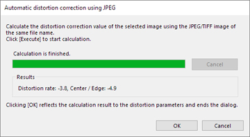

4.11.2.4. Automatic distortion correction using JPEG
This function calculates the distortion correction value using the JPEG image recorded when the photograph was taken.
In order to use this function, a JPEG image with distortion corrected must be recorded at the time the photograph is taken.
* This function cannot be used when a JPEG / TIFF /HEIF image is selected.
For the selected image, when there is a JPEG / TIFF image with the same file name as the RAW image to be corrected, the button will be activated.
If you click the button, the “Automatic distortion correction using JPEG” dialog will be displayed.
If you click the [Execute] button, the distortion correction values will be calculated.
When the calculation is complete, the results will be displayed.
Click [OK] to reflect the correction values to the “Distortion rate” and “Center/Edge” sliders and perform distortion correction,
This function analyzes the image to be corrected and performs calculations, so the correction results may vary between images photographed under the same shooting conditions using the same camera and lens.
If the aspect ratio, pixel count and angle of view differ between RAW and JPEG images, correction values may not be calculated correctly.
4.11.3. Chromatic aberration
“Chromatic aberration” corrections contained within the Chromatic aberration tab is a function that corrects lens characteristics such as when chromatic aberrations of magnification appear as coloring on the edges around the image.
The transverse chromatic aberration is caused by the difference in lens magnification rates for each colored light (red light, green light, and blue light) incoming to a lens.
The transverse chromatic aberration correction is performed by changing R and B magnification slightly.
First, enlarge the area, where the edge of an object in the image periphery is colored, to more than 400%, and display it. Then, decrease the color distortion in the “Noise reduction” sub-control (for example, 0 - 80). After that, check the “Chromatic aberration” checkbox to adjust the R rate and the B rate.
When you correct a picture, enlarge the periphery area as shown below to check the correction result and change parameters.
4.11.3.1. R rate
This adjusts the lens magnification for red light. If the edge is colored by red or cyan (complimentary color of red), change this parameter first.
4.11.3.2. B rate
This adjusts the lens magnification for blue light. If the edge is colored by blue or yellow (complimentary color of blue), change this parameter first.
When these two parameters are appropriate, coloring is decreased most.
First, look the edge condition and change the R rate so that “red <–> cyan” in the both sides of edge is decreased. Then change the B rate to adjust “blue <–> yellow” coloring. Repeat the R rate and B rate adjustments to find the best point.
Do not try to decrease coloring, but try to distribute the edge coloring uniformly. After that, when increasing the “Color distortion” slider in the “Noise reduction” sub-control, the remaining colors are disappeared. Increase the parameter until you are satisfied, and finish adjustments.
At this time, if colors still remain even after the color distortion is maximized, there is a possibility that transverse chromatic aberration is so big that it exceeds the correctable range or that coloring occurs because of aberration other than transverse chromatic aberration. For example, too light background shows a possibility of coma aberration.
At the present time, you can correct transverse chromatic aberration.

4.11.4. Lens profile
“Lens profile” found in the Lens profile tab is a function for performing automatic distortion correction based on the lens information prepared in advance.
SILKYPIX Developer Studio Pro12 uses the lens database that comes with Lensfun, an open source library, for lens information.
Please refer to the Lensfun website (English) for details on the Lensfun lens database.
To perform correction using the lens profile, turn ON the “Enable” checkbox.
* This function cannot be used for JPEG / TIFF / HEIF images.
* To use this function, a dedicated data file must be created in advance from the lens database.
If there is no data file, the controls within the Lens profile tab will be disabled, and this function cannot be used.
Please refer to 4.11.4.5. About create data file for the lens profile for details.
* We are unable to respond to questions regarding the Lensfun lens database and lens information. We appreciate your understanding.
Lens profile controls are contained in the “Lens aberration controller” sub-controls, but lens profile parameters are handled independently.
However, the dropdown list of “Lens aberration controller” sub-control tastes and the colors of sub-control icons when parameters are edited will be shared.
However, the dropdown list of “Lens aberration controller” sub-control tastes and the behavior of the “Reset to defaults” button will be shared.
Lens profile parameters will not be included when pasting development parameters.
4.11.4.1. Manufacturer
A list of lenses that can use the lens profile will be shown in a dropdown list.
Please select the manufacturer of the lens to which you wish to apply the lens profile.
If the appropriate lens profile could be identified from the Exif information of the RAW data, the manufacturer contained in that lens profile will be set as the default value.
If the appropriate lens profile could not be identified automatically, “Select manufacturer and lens” will be displayed.
The following messages may be displayed in the “Manufacturer” dropdown list.
  • “Data file does not exist”
    This message is displayed when the data file needed to used this function is not found.
    If a data file for the lens profile was not created when launching the software, this function cannot be used.
    Please refer to “4.11.4.5. About create data file for the lens profile” for information about the data file for the lens profile.
  • “Select manufacturer and lens”
    This message is displayed when the appropriate lens profile is not identified automatically from the Exif information of the RAW data.
    In this case, you can perform the correction by selecting the manufacturer and lens from the dropdown list.
    Please note, however, that the appropriate lens profile may not exist.
  • “This RAW cannot be corrected”
    This message is displayed when distortion correction using this function cannot be performed on the selected RAW data.
    SILKYPIX Developer Studio Pro12 always displays optimal development results for some RAW data without using this function.
    For this reason, automatic distortion correction using this function cannot be performed on such RAW data.
  • “Cannot be used for non-RAW data”
    This message is displayed when a JPEG / TIFF / HEIF image is selected.
    This function cannot be used for JPEG / TIFF /HEIF images.
  • “Correction information not found”
    This message is displayed when the same lens profile as the one recorded in the development parameter file is not found.
    The applicable lens profile may have been deleted, or its name may have been changed, due to the lens database being updated or for other reasons.
    To correctly reproduce the adjustment results, a lens profile based on the same lens database information as the one when the adjustment was performed must be prepared.
    While you can select another dropdown list and apply a different lens profile, please note that the information recorded in the development parameter file will be overwritten and lost.
When you cannot use this function, controls within the Lens profile tab will be disabled.
4.11.4.2. Lens
A list of lenses for the selected manufacturer will be displayed in a dropdown list.
Select the lens to which you wish to apply the lens profile.
If the appropriate lens profile could be identified from the Exif information of the RAW data, the lens contained in that lens profile will be set as the default value.
4.11.4.3. Correction method
A list of correction methods available for the profile corresponding to the selected manufacturer and lens will be displayed in a dropdown list.
In many cases, only one method will be displayed, but multiple methods may be available depending on the profile.
If you are presented with multiple correction methods to choose from, select one that is the most suitable for correcting the selected image.
* Correction methods are displayed based on the lens profile information, so we are unable to provide information about how correction methods are selected or other details. We appreciate your understanding.
4.11.4.4. Rate of correction
You can adjust the rate of distortion correction performed based on the lens profile.

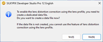

SILKYPIX Developer Studio Pro12 contains a Lensfun database file. To perform correction processing using the lens profile in a short amount of time, you need to create a dedicated data file in advance from the database.
This data file needs to be created when this software is launched for the first time or when the lens database is updated.
When a data file needs to be created, a message dialog confirming whether to create the file or not will be displayed (*).
If you select “Yes”, the lens database will be converted into a dedicated data file.
You may skip data file creation by selecting “No” when the message dialog is displayed.
Please note, however, that if the data file does not exist, controls inside the Lens profile tab will be disabled, and this function cannot be used.
* This message dialog is displayed when the “Create data file for the lens profile” checkbox in “Function settings” is turned ON.
When the checkbox is turned OFF, this confirmation message dialog will not be displayed even when a data file needs to be created.
Please refer to “1.3. Create data file for the lens profile” for details.

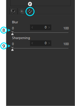

4.13.3. Blurred / Sharp periphery
Blurred / Sharp periphery can be used to blur or sharpen the periphery of an image with its center as the reference point.
The blurring and sharpening effects will be stronger farther out from the center.
You can also change the effect type and move the center of the effect.
Turn ON the checkbox to enable Blurred / Sharp periphery.
4.13.3.1. Type
Specifies Blurred / Sharp periphery type.
  • Circular
    Applies a circular blur or sharp effect from the center.
  • Linear
    Applies a linear blur from the center up and down.
    Linear lets you specify the angle of the blur direction.
4.13.3.2. Blurring / Sharpening
Set the strength of the blurring or sharpening effects.
The function of the slider varies depending on the Type.
  • Circular
    Move the slider farther to the left to make the “Blurring” effect stronger.
    Move the slider farther to the right to make the “Sharpening” effect stronger.
    Neither effect will apply when the value is 0.
  • Linear
    Move the slider farther to the right to make the “Blurring” effect stronger.
    Sharpening is not available in Linear.
4.13.3.3. Area of effect
Set the area of the blurring or sharpening effect.
Smaller values will only apply the effect farther away from the center.
Larger values will apply the effect closer toward the center.
4.13.3.4. Angle
Specifies the direction of the effect in degrees.
Angle can only be specified when the Type is “Linear”.
If the angle is 0deg., the effect is applied vertically from the center, and if the angle is +90deg. and +90deg., the effect is applied horizontally from the center.

4.14.2. How to Operate Crop Tool
  1. Cropping area
    Set a numerical value for the cropping area.
    • Upper left coordinates (x,y)
    • (B) Size (width x height)
    • (C) One coordinates (x,y) for the area
    • (D) The other coordinates (x,y) for the area
  2. Cropping method
    Select a method to crop the image.
    Select from “Custom”, “Constrain original proportion”, “Specify aspect ratio”, “Print size”, and “Fixed size (fixed aspect ratio)”.
    • Custom
      Designate when freely cropping the image.
    • Constrain original proportion
      Crop while maintaining the aspect ratio of the original image.
      Designate when cropped image and original image share the same aspect ratio.
    • Specify aspect ratio
      Designate when cropping to your own set aspect ratio.
      • (Set output size)
        When this setting is on, the numerical value of the aspect ratio set here is the default pixel size at the time of “Develop”.
        For example, if cropping is set here to 640:480, whatever value the size of the actual cropping, the default pixel size at the time of “Develop” will be set to 640x480.
        Enable this when the output pixel size is set and cropping will match it.
    • Print size
      Crop to the aspect ratio of the printing area for the currently set printing paper.
      Use this so there will not be any wasted space when printing.
      When designating this setting format, you must first complete printer settings.
    • Fixed size
      Crop to an aspect ratio of a standard size found on the list.
  3. Apply specified aspect ratio
    Automatically crop the image with the selected cropping method.
    If the aspect ratio is set, it crops to the designated aspect ratio.
  4. Initialize to default
    Set cropping area to the initial area.
  5. Crop image on preview
    Crop the image by dragging the mouse on the preview window.
  6. Extend processing area to entire recorded area
    Extend so that you can designate all areas recorded in RAW data as subject to processing.

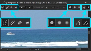

4.17. Spotting tools
Spotting tools are tools for erasing dust and such found in photographs and correcting for red eye.
The main purpose is for making corrections when dust is found on the photograph or for removing dust from images made from film scanners or red eye from flashes.
To use spotting tools, either select [Tools (T)]-[Spotting tools] from the menu or switch to “Spotting tools” mode from on the top toolbar when in the preview display.
A “Spotting tools” sub-control will be displayed when you switch to “Spotting tools” mode.
Also, a navigation display will appear for the “Spotting tools” display area on the preview display.
4.17.1. How to Erase Spots
Two methods to erase dust are included in “Spotting tools”: “Auto Erase” mode and “Copy” mode.
“Auto Erase” mode automatically erases spots by clicking on the area with spots.
“Copy” mode hides spots by copying designated areas on top of spots.
You can also remove corrections to spots in the “Eraser” mode.
You can combine these two methods.
If you are not able to completely erase in “Auto Erase” mode or if you can see traces of the erasures, you can make additional corrections in the “Copy” mode.
You can also make more natural finishes by using the “Eraser”.
4.17.2. Red Eye Correction
The “Red Eye Correction” mode effectively corrects for red eye from surrounding hues by clicking on the area including the whole iris.
If the clicked area falls on a previously clicked area for red eye correction, the previous correction is cancelled and the new area will be used for processing the correction.
In addition, you can cancel corrections with the “Eraser” mode.
4.17.3. Operation Methods
Each of the four operation modes, “Auto Erase”, “Copy”, “Eraser” and “Red Eye Correction”, are performed by left clicking the mouse over the “Spotting tools” sub-control preview display, and in the area inside the circle cursor in each mode.
You can remove dust and make red eye corrections by switching to operation mode and adjusting the size of the circle cursor.
  • [Operating Mode]
    • : Auto Erase
    • : Copy
    • : Eraser
    • : Red eye correction
  • [Tool effects]
    • : Wide pen
    • : Medium pen
    • : Thin pen
  • [Other Functions]
    • : Emphasize spotting areas
    • : Initialize spotting areas
4.17.3.1. Operation Modes
You can switch between the four modes, “Auto Erase”, “Copy”, “Eraser” and “Red Eye Correction”, while doing your work.
Switch operation modes using the , , and icons.
4.17.3.2. Tool effects
The effects of each tool, “Auto Erase”, “Copy” and “Eraser”, take place within the area shown in the circle cursor.
The effects of these tools are stronger in the center of the circle cursor and weaker near the edges, but you can choose from three degrees of strength.
Switch “Tool effects” using the , and icons.
However, you cannot select tool effects in “Red eye correction” mode.
4.17.3.3. Emphasize Spotting Areas
Emphasize the display of the area to which corrections were added to the image with “Spotting tools”.
Turn the emphasis display ON / OFF by clicking on .
Areas processed under “Auto Erase” or “Copy” mode are emphasized in red, while areas processed in “Red Eye Correction” mode are emphasized in green.
4.17.3.4. Initialize Spotting Areas
Initialize the “Spotting tools” parameters by clicking on .
Initialized parameters are different depending on the operation mode.
When in “Auto Erase” or “Copy” mode, dust removal parameters are initialized, and when in “Red Eye Correction” mode, red eye correction parameters are initialized.
When in “Eraser” mode, parameters for both dust removal and red eye corrections are initialized.
4.17.3.5. Adjusting Correction Size
All four operation modes, “Auto Erase”, “Copy”, “Eraser” and “Red Eye Correction”, display the area for corrections as the area within the circle cursor.
The area surrounded by the circle cursor is the range of corrections.
Adjust the area of correction for each operation by adjusting the size of the circle cursor.
The size of the circle cursor is designated by displaying “Size” and setting the pixel unit.
In you are in “Copy” mode, you can also change the area to be copied.
The relationship between the area to be copied and the copy location is shown in “Relative position” and you can set the pixel unit.
You can set and change “Size” and “Relative position” through three methods.
  1. Change the displayed numerical value
    You can change the displayed numerical value of the “Size” and “Relative position” by adjusting with the spinner or by directly entering in the text box.
  2. Change in the “Change size / relative position” mode
    Enter the “Change size / relative position” mode by clicking either the “Size” button or “Relative position” button, or by right clicking.
    You can change the “Size” by either dragging the edge of the circle cursor or with the mouse wheel, and the “Relative position” by dragging the center of the circle cursor with the mouse.
  3. Change by using the [Ctrl] key + mouse
    You can adjust the “Size” by holding down the [Ctrl] key and turning the mouse wheel.
    Also, if you are in “Copy” mode, you can change the “Relative position” by holding down the [Ctrl] key and moving the mouse.
    Once you are used to these methods, you can quickly change the “Size” and “Relative Position.”

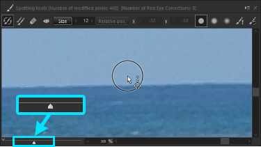

4.17.3.6. Changing Display Location / Magnification
The “Spotting tools” preview display can be displayed from 100%-1600% display magnification.
  1. Change controls on the “Spotting tools” sub-control
    Magnification changes are adjusted with the display magnification slider control.
    Display magnification cannot go below 100%.
    Adjust display magnification with the scroll bar.
  2. Change the preview window’s navigation display
    Navigation display showing the area of the “Spotting tools” is executed on the preview window displaying the preview image of the selected image.
    You can adjust the display area by moving the handles on the four corners of the navigation frame and with the center handle.
    You can also move the display area of the “Spotting tools” to the location of the mouse pointer on the preview window.
    Display the context menu by right clicking and select “Move display location of spotting tools”.
  3. Change with [Alt] key + mouse operations
    You can change the display location and magnification of the “Spotting tools” preview image with the “Zoom Tool” while holding down the [Alt] key.
    You can change the display location with [Alt] key + dragging and resize the display with [Alt] key + [Shift] key + dragging.
You can efficiently proceed with your work by arranging the preview window display when using “Spotting tools”.
4.17.4. Notes

4.18. Retouch brush tool
Retouch brush tool is a tool that allows you to remove unwanted objects from your photo by tracing them with a brush.
You can make corrections by tracing the area you want to erase with a brush, and then copying another area in the image to reflect it.
To use the Retouch brush tool, select [Tools(T)] - [Retouch brush tool] from the menu while the preview screen is displayed, or switch to the Retouch brush tool mode from the sub-control icon.
When you switch to the Retouch brush tool mode, the “Retouch brush tool” sub-control appears.
* The position of the Retouch brush area does not follow the image deformation or rotation performed by “Lens aberration controller” and “Rotation/Shift lens effect”.
Use the Retouch brush tool only after adjusting these parameters in advance.
4.18.1. “Retouch brush tool” sub-control
  1. Add retouch brush
    Enter the “Add retouch brush” mode.
    Drag on the preview screen to add an area for the Retouch brush.
  2. Emphasize retouch brush areas
    Highlight all added brush areas.
    Click the button to toggle the emphasis on/off.
  3. Delete selected brush area
    Delete selected brush area.
  4. Mode
    Sets the mode for correcting the Retouch brush area.
    • Copy
      The source area is copied directly to the brush area and reflected.
      By setting the feather of the brush to a larger size, a natural correction can be achieved.
    • Retouch
      Adjusts and reflects the image of the source area to match the brightness and color of the surrounding area of the brush area.
  5. Feather
    Use the slider to adjust the value from “0” to “100”.
    The larger the feather, the softer the brush’s nib becomes, and the weaker the effect on the outside of the brush.
    The smaller the amount of feather, the more clearly the boundaries of the brush will be visible.
  6. Brush size
    Use the slider to adjust the value from “10” to “300”.
    Adjusts the size of the brush’s nib to match the area you want to correct.
  7. Opacity
    Adjusts the amount to which the correction effect of the added retouch brush area is reflected in the original image before correction.
    The smaller the value, the more transparent the original image before correction will be displayed.
4.18.2. How to add and manipulate a retouch brush area
Press the “Add retouch brush” button to enter the “Add retouch brush” mode.
A double-circle cursor will appear on the preview screen, and you can set the “Feather” and “Brush size” to match the area you want to correct in advance.
Drag the area you want to correct, and the brush’s locus will be drawn in red on the preview.
When the mouse is released, a retouch brush area will be created according to the locus of the drawn brush.
When the retouch brush area is created, a rectangle showing the brush area, (a) the center handle, and (b) the source handle will be displayed.
By dragging the (b) source handle, you can change the source area to be applied to the brush area.
After adding multiple brush areas, click on the (a) center handle to switch between the areas you want to operate on.
* The “Feather” and “Brush size” are set before the brush is drawn.

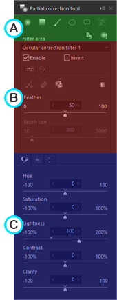

4.19. Partial correction tool
The Partial correction tool is a tool for designating areas to be corrected and for making corrections to parts such as shading and contrast within the area.
The main purpose is for making corrections on parts of images, such as raising brightness on expressions on some subjects darkened by backlighting, or for fine tuning the white balance on some subjects seeming to be to bright from reflected light.
To use the Retouch brush tool, select [Tools(T)] - [Retouch brush tool] from the menu while the preview screen is displayed, or switch to the Retouch brush tool mode from the top toolbar.
The “Partial correction tool” sub-control will be displayed when you switch to “Partial correction tool” mode.
The “Partial correction tool” sub-control is mainly divided into the following three sections.
* The position of the filter area created with the “Partial correction tool” does not follow the transformations and rotations of the image performed by the “Lens aberration controller” and “Rotation/Shift lens effect.”
Please use the “Partial correction tool” after the adjustment of these parameters.
4.19.1. “Partial correction tool” sub-control functions

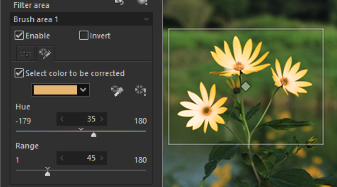

4.19.1.1. Add filter area
In “Partial correction tool”, you can add five types of filter area: circular correction filter, gradual correction filter, brush area, curve area, and polygon area.
You can also add an object information filter if an image is selected for which one is available.
Use a filter area that is easy to use according to the shape of the area that you wish to correct.
  • (1) Add circular correction filter
    Enter the “Add circular correction filter” mode.
    The “Add circular correction filter” mode reflects the results of settings for each item in the “Partial correction tool” sub-control in a circle from the center of the designated area.
    After clicking , you can drag across the preview image to designate the area for correction.
    Please refer to “4.19.2.1. Circular correction filter” for information about how to operate the “Add circular correction filter” mode.
  • (2) Add gradual correction filter
    Enter the “Add gradual correction filter” mode.
    The “Add gradual correction filter” mode displays a band on top of the image and reflects the results of settings for each item in the “Partial correction tool” sub-control in that band.
    After clicking, three bands will be displayed on the preview image.
    The range of effects in the gradation state are displayed within the band.
    Please refer to “4.19.2.2. Gradual correction filter” for information about how to opeate the “Add gradual correction filter” mode.

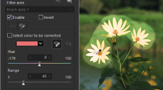

  • (3) Add new brush
    The “Add new brush” mode reflects effects set by the various items in the “Partial correction tool” sub-control for the area you draw on your own by dragging the mouse.
    When you click on , a double circle will replace the cursor on the preview image.
    The tracks of the brush will be drawn in red on the preview image when you drag the area to be corrected.
    After releasing the mouse, the brush area to be effected in accordance with the tracks drawn by the brush will be created.
    Please refer to “4.19.2.3.1. Add new brush” for information about how to operate the “Add new brush” mode.
    * When adding a brush area, set “Feather” and “Brush size” in advance according to the areas you wish to correct.
    You cannot change “Feather” and “Brush size” settings once you have drawn with the brush.
  • (4) Add curve
    Enter the “Add curve” mode.
    The “Add curve” mode reflects effects set by the items in the “Partial correction tool” sub-control for the curve linking the specified points.
    If you click , the mouse cursor on the preview screen will change to the “Add curve” cursor .
    Points will be set by clicking on the preview, and a curve linking the points will be displayed.
    The curve area will be confirmed by double-clicking the mouse, and effects will apply to the set curve area.(*1)
    Please refer to “4.19.2.4. Curve-polygon area” for information about how to operate the “Add curve” mode.
  • (5) Add polygon
    Enter the “Add polygon” mode.
    The “Add polygon” mode reflects effects set by the items in the “Partial correction tool” sub-control for the polygon linking the specified points.
    If you click , the mouse cursor on the preview screen will change to the “Add polygon” cursor .
    Points will be set by clicking on the preview, and a polygon linking the points will be displayed.
    The polygon area will be confirmed by double-clicking the mouse, and effects will apply to the set polygon area.(*1)
    Please refer to “4.19.2.4. Curve-polygon area” for information about how to operate the “Add polygon” mode.
    *1 Curve and polygon areas cannot be set in a way in which sides intersect.
    If there are intersecting sides when points are added, the color of the curve or polygon will change to pink, so make sure there are no intersecting sides when confirming the area.
  • (6) Add object information filter
    If the selected image has object information and a DNG file with object information available in this software is selected, “Object information filter” can be added.
    If the selected image contains object information and it is available, the button will be enabled.

4.19.1.2. Operate selected filter
Operate and manage the selected filter area.
For brush areas, set “Feather” and “Brush size” before drawing with the brush.
  • (1) Filter area
    The added filter area will be displayed.
    The filter selected here will be the area that can be operated at that time.
  • (2) Enable
    This activates the effects of filters selected in the “Filter area.”
    The selected effects will be removed if you remove the check mark.
  • (3) Invert
    The area where effects are applied and area where effects are not applied will be inverted in the filter selected in the “Filter area”.
  • a. “Basic tools” tab
    • (4) Add brush to the selected filter area
      When you click on , the brush area selected as the “Filter area” will turn into Edit mode, and you can add a brush and draw with it. (*1)
    • (5) Brush eraser
      When you click on , the brush area selected as the “Filter area” will turn into Edit mode, and you can erase the brush you had drawn. (*1)
    • (6) Duplicate selected filter area
      When you click the , it will duplicate the filter that is selected in “Filter area”.
      The filter is duplicated under conditions saved for filter size and each parameter in a location a little to the lower right from the filter center of the original.
    • (7) Delete selected filter area
      By clicking , only filters selected in the “Filter area” at that time will be deleted.
    • (8) Feather
      Adjust from “0” to “100” with the slider.
      You can adjust the shading degree on the borders of the designated area. (*2)
      By increasing the value of “Feather”, the shading increases and the effects taper off from the outside to the center.
      Conversely, by decreasing the value of “Feather”, there will be less shading and the boundary lines of the designated area appear more clearly.
    • (9) Brush size
      This can be set with the slider from “10” to “3000.”
      When drawing with a brush under “Add new brush,” “Add brush to the selected filter area,” or “Brush eraser,” you can adjust the size of the brush being drawn with.
      Set according to the area to be corrected.
      *1 This can be used when the filter selected in “Filter area” is the “Brush area.”
      *2 When used in the “Brush area,” set before drawing with the brush. You can not change the feathering after drawing with the brush.
  • b. “Select color to be corrected” tab
    • (10) Select color to be corrected
      Set whether to enable the “Select color to be corrected” function.
      “Select color to be corrected” is a function that can specify a certain color to be corrected within a set filter area.
      For example, you can increase the lightness of only red within the area drawn with the brush, and decrease the saturation of only blue within the area where gradual correction filter is applied.
      Place a check here to enable the “Select color to be corrected” function.
    • (11) Select color
      Select a color to be corrected from the dropdown list.
      If you wish to set an approximate color, select one from the dropdown list.
      Colors set with the “Color selection tool” or “Hue” slider will be displayed in the dropdown list.
    • (12) Color selection tool
      This is a tool for directly specifying a color to be corrected on a preview image.
      You can enter the “Color selection tool” mode by clicking .
      If you specify an area by clicking or dragging over the preview of a selected image, the average color of that area will be set as the color.
    • (13) Preview of selected color
      Reflect the selected color on the preview image.
      Color will be maintained only in the areas corresponding to the selected color within the filter area, and all other areas will be displayed in monochrome.
      Click to turn ON or OFF the preview.
    • (14) Hue
      Set the hue of the color to be corrected with a slider.
    • (15) Range
      Using a slider, set the range of the color to be corrected where the color set with the “Hue” slider is the center.
      Reducing the range will narrow the range of the color to be corrected, and increasing the range will widen the range of the color to be corrected.
      Set an appropriate range while using “Preview of selected color”.
4.19.1.3. Parameters Available for Adjustment
Indicate parameters that can be used to adjust the selected filter area.

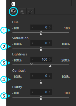

  • c. “Color / Contrast” tab
    • (1) Hue
      You can adjust from “-180” to “180” with the slider.
      This changes the relative hues within the designated area.
    • (2) Saturation
      You can adjust from “-100%” to “100%” with the slider.
      The higher the chroma, the more brilliant the colors appear, but if the colors are already brilliant, they may become saturated and you may lose details.
      When adjusting chroma, check the overall vividness of the colors. It is necessary to adjust so that the vividly colored parts are not saturated and details are not lost.
    • (3) Lightness
      You can adjust from “-100%” to “200%” with the slider.
      The default value of lightness is 100%. Lightness decreases as this value lowers.
    • (4) Contrast
      Contrast means the difference between bright area and dark area.
      When increasing the contrast, the bright area becomes brighter and the dark area becomes darker, i.e. high contrast.
      On the contrary, when decreasing the contrast, difference between the bright area and dark area becomes smaller, i.e. low contrast.
    • (5) Clarity
      You can adjust from “-100” to “100” with the slider.
      Clarity adjusts the fine texture of the subject.
      If you increase clarity, you can refine the details of the subject more clearly, so if you want to revive the texture of a sleepy landscape photograph as a whole, this will have that effect.
      In addition, if you lower clarity, you can finish with a soft focus and atmosphere such as with portraits of women and children or macro image.
  • d. “White Balance Fine Adjustment” tab
    • (6) White balance fine adjustment
      You can also adjust white balance in detail by numerical value.
      * “White balance target” control is based on the accurate color space.
    • (7) Initialize white balance target
      Click to set white balance target to the default value.
  • e. Effects tab
    • (8) Blur
      You can adjust from “0” to “100” with the slider.
      Applies a blur effect to the specified area.
      The higher the value, the stronger the blur effect.
    • (9) Sharpening
      Applies a sharpness effect to the specified area.
      The larger the value, the stronger the sharpening effect will be.

4.19.2.3. Brush area
  1. Activate the “Partial Correction Tool” sub-control and click .
    A double circle cursor will be displayed on the preview.
    The inner circle indicates the area where the effect is strongest and the outer circle indicates the area where the effect becomes weaker.
  2. Set the “Brush size” and “Feather” in advance according to the area to be corrected, and drag on the preview to draw the brush.
    The drawn area will be displayed in red.
  3. When you release the mouse, the item of that area will be added as the “Brush area 1” to the “Filter area.”
  4. After setting the area, operate each item in the “Partial correction tool” sub-control to make your corrections.
  5. If you want to make adjustments to another area, follow steps (1)~(4) making a new area for a gradual correction filter.
    By repeating steps (1)~(4), a new area will be added to the “Filter area” as follows: “Brush area 2,” “Brush area 3,” etc.
    * If you want to add a brush drawing or delete a part of the red region, use “d. Add brush to the selected filter area” or “e. Brush eraser.”
    * You can control areas one by one on the image.
    Therefore, when you have multiple designated areas, you can perform operations by switching areas of operation in the “Filter area.”
    * You cannot change the size of the Brush area.

After adding the filter area, apply the corrections by manipulating the items in the “Partial correction tool” sub-control.
If you want to add more than one area, select an item from the context menu.

4.19.4. How to use adjustment using “Select color to be corrected”
By using the “Select color to be corrected” function on a filter area, you can specify an area in an image and change the color of only that area, or retain only certain colors and turn the other areas into monochrome.
Here, we will introduce an example of how to make adjustments using the “Select color to be corrected” function on a filter area.
How to make adjustments using 'Select color to be corrected'
Adjustment steps
  1. Add a filter area by encircling the area to be corrected.
    In this example, a flower drawn with a brush is set as an area to be corrected.
    If you add a filter area, the entire specified area will be set to be lighter at first.
  2. Switch to the “Select color to be corrected” tab and set the color to be corrected.
    The color to be corrected can be specified using any of the following three methods.
    • Select an approximate color from the “Select color” dropdown list
    • Select a color in an image using the “Color selection tool”
    • Set a value directly using the “Hue” slider in the “Select color to be corrected” tab
    By directly selecting a color in an image using the “Color selection tool”, you can make adjustments intuitively.
    Here, we will select the petal area using the “Color selection tool”.
    “Select color to be corrected” will be enabled, and the color selected as the color to be corrected will be set.
  3. By clicking “Preview of selected color”, you can check the selected color on the preview image(*).
    The area shown in color is the selected color.
    In this example, the tip of the petal is not completely inside the selected color area, so the “Range” slider value will be increased so that the petal will be shown entirely in color.
    The selected color has now been set.
    * Note that the “Preview of selected color” function is a function for displaying areas other than the selected area in monochrome, and is not an adjustment parameter.
  4. Clear “Preview of selected color” and adjust parameters.
    The example on the right shows the flower area in a different color by adjusting the “Hue” and “Saturation”.
    The example on the right shows the image with the selected color inverted by placing a check in “Invert”, after completely removing the saturation of the flower area by setting “Saturation” to -100.
    Color is retained only in the flower area, with all other areas in monochrome.

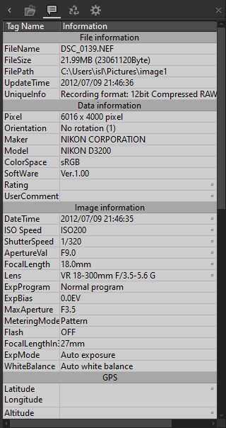

4.21.1. File information
File information for the selected image file is displayed.
Editing is not available for items in this category.
Information related to the file format is displayed in “UniqueInfo”.
Refer to this information when a selected image is not shown in the preview display, because information may be displayed if it is a format not supported by SILKYPIX or if the file is corrupted.
“Editing date and time” displays the date and time of the latest edit by SILKYPIX.
This is the edit date and time development parameter that SILKYPIX automatically records. It is not displayed for images that have not had development parameters edited or for initial development parameters.
4.21.2. Data information
This is mainly information recorded in Exif information for RAW data and JPEG / TIFF / HEIF images. Information related to the image and secondary information on the image is displayed here.
“UserComment” and “Rating” are items that can be edited.
4.21.3. Image information
This is mainly information recorded in Exif information for RAW data and JPEG / TIFF / HEIF images. Photographic information such as camera settings at the time the photograph was taken is displayed here.
“DateTime”, “ISO Speed”, “ShutterSpeed,” “ApertureVal”, “FocalLength” and “Lens” can be edited.
You can freely edit items such as corrections to incorrect dates and times set on the camera or when photographic information is not correctly recorded such as when you use a manual lens.
When recording to a developed JPEG / TIFF image, the “Name of Lens Used” is recorded in a standard format to XMP, while other information is recorded as Exif information.
4.21.4. GPS
Positional information such as from GPS is chiefly found in information recorded in RAW data and Exif information in JPEG/TIFF/HEIF images.
It is possible to edit each item.

Moreover, when the lens profile of lens distortion bias is enabled and an appropriate lens profile could be identified, the manufacturer and lens of the lens profile will be automatically selected as default parameters.
By employing this function, SILKYPIX gives recommendations based on information at the time of shooting for the initial settings of each parameter listed above from the status at the time the photograph (RAW data) was read and first opened. Therefore, even when performing finishing work on adjusting parameters as a post-process, you can start from the status of making adjustments that meet each of the shooting conditions so that you can proceed smoothly.
