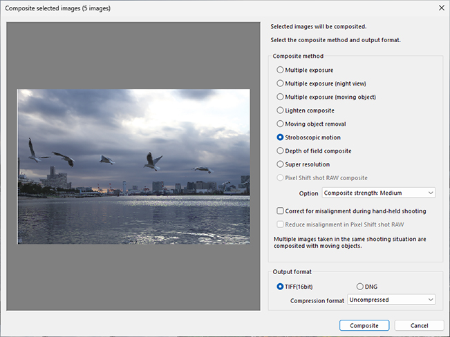

In addition, there is a “Composite selected images” function that composite images of multiple selections and saves them as a single DNG or TIFF images file.

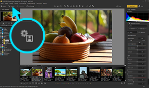

To perform “Develop,” select a single image and click the icon on the top toolbar to choose “Develop (S).” Alternatively, you can select “Develop (S)” from the [File (F)] menu or [Develop (D)] menu, or click the icon on the “Development settings” sub-control.

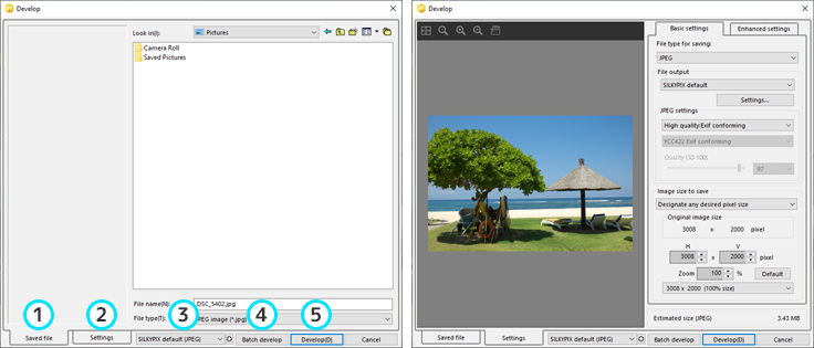

You can switch between “Saved file” and “Settings” pages in the “Develop” dialog.
When the “Saved file” tab is selected, you can designate the file folder, file name and file type for saving the development results.
When the “Settings” tab is selected, you can make settings for develop while looking at the preview display of the development results.
After confirming instructions for saving files and development settings, click on the “Develop” or “Batch develop” button and begin processing.
  1. Saved file
    This switches to the page for designating details of saved files.
    You can designate the file folder, file name and type of file for saving the development results.
  2. Settings
    Switch to the page for making settings for develop.
    You can make settings for develop while looking at the preview display of the development results.
  3. Develop tastes
    The status of “Develop” tastes will be displayed.
    Registered tastes will be displayed when you open the list.
    You can switch to develop settings from these tastes.
  4. Batch develop
    Confirm set development instructions and register development processing to batch development as a job.
    Registered jobs are processed as batch development. When job registration is complete, develop is closed, whether or not development processing has been completed and you can go to the next operation.
  5. Develop
    Confirm set development instructions and begin real time development processing.
    The status of processing is displayed on a progress bar until development processing is complete.

5.3. Settings for development and saving
Setting items common in both “Develop” and “Batch develop” are explained here.
5.3.1. Basic Settings
Basic settings differ slightly between “Develop” and “Batch develop”, but items that can be set in the same way will be explained.
5.3.1.1. File type for saving
From the drop down list, you can select JPEG or TIFF file. When you want to set this in detail, use the “File output settings” dialog as described below.
5.3.1.2. File output settings
By registering a setting status from “File output settings” that you often use as a taste, you can easily switch settings by selecting that taste.
You can also set JPEG and TIFF saving formats here.
There are many detailed setting items in “File output settings”.
Click on the “Setting details” button and open the “File output settings” dialog to make settings for all items.
Please see “9.1. File output settings” for details.
You can make detailed settings for both “JPEG” and “TIFF” by selecting “Type of saved file” here.
Items that can be set here are the same as the items that can be set with “Setting details”. Please see “9.1.2. Setting of File Type” for details.

5.4. Composite selected images
“Composite selected images” is a function to composite selected images and save them as TIFF or DNG-format files.
The “Composite selected images” dialog appears by clicking the icon on the top toolbar or by right-clicking the selected image on the thumbnail and selecting “Composite selected images” from the context menu that appears.
* This function is available only when multiple images are selected.
However, if a pixel-shift shooting RAW data is selected, it will be enabled even when only one image is selected, and only “Pixel Shift shot RAW composite” can be performed.
By selecting Composite method and Output format and clicking [Composite], you can composite the selected images.

  6. Stroboscopic motion
    Multiple images taken in the same shooting situation are composited with moving objects.
    You can create a sequence photograph that expresses motion by continuously emitting strobes in the dark.
    You can control the strength of the composite with “Composite strength” options.
    The stronger the intensity, the more clearly the moving object is composite, but dust will be more likely to appear.
    • Option
      • Composite strength: Weak
      • Composite strength: Medium (default)

Whether or not development parameters set for the selected images are reflected during compositing depends on output format.
The categories of Development parameters reflected during compositing are as follows:
Parameter category TIFF(16bit) DNG
Exposure / Luminance * *
White balance * —
White balance fine adjustment * —
Tone * —
Tone curve * —
Color * —
Sharpening/Noise reduction * —
Highlight controller * *
Lens aberration controller * *
Rotation/Shift lens effect * *
Fine color controller * —
Effects * *
Development settings * *
Monochrome controller * —
Underwater photo controller * —
Crop tool * *
Spotting tools * *
Retouch brush tool * *
Partial correction tool * *
* Due to the nature of “Pixel Shift shot RAW composite,” none of the development parameters will be applied during composition, regardless of the selected output format.
Please make adjustments to the composite image afterward as needed.
