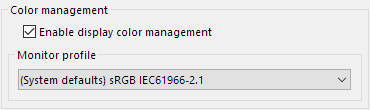

9.2.1. Color management
The preview image cannot display accurate colors if it is a JPEG / TIFF /HEIF image recorded in an input color space other than sRGB and if the output color space is set to something other than sRGB when color management is disabled.
Please refer to “10.4.5. Color management” for details.

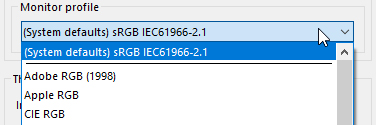

9.2.1.1. Monitor profile
Please refer to “10.4.5.4. Color management on monitor displays” for details.

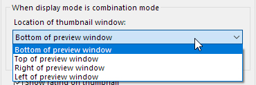

  1. Stay in preview mode
  2. Change to thumbnail mode
  3. Change to combination mode

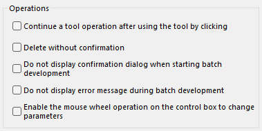

9.3.2. Operations
    If this setting is checked, values will be changed when the mouse wheel is operated on controls.
    * By holding down the [Ctrl] key while operating the mouse wheel, this setting will temporarily be reversed.
    Use this feature when you want to simultaneously perform scrolling operations on the control box and slider adjustments with the mouse wheel.

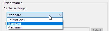

9.3.3. Performance
9.3.3.1. Cache settings
  • Restrictions
  • Standard (default)
    It’s a standard setting.
  • Maximum
    Maximize the use of Cache
  • Normal (default)

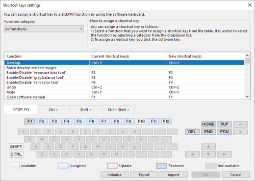

9.4. Shortcut keys settings
9.4.1. GUI Operation methods
  1. Function category
  2. List
  3. Software keyboard
  4. Initialize
  5. Export
  6. Import
9.4.3.1. Reserved keys

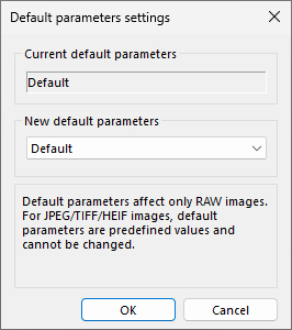

* “Default parameters” affect only RAW images. For JPEG/TIFF/HEIF images, “Default parameters” are predefined values and cannot be changed.

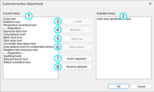

9.6. Customize toolbar
The customizable toolbar in this setting refers to the icons located in the center of the top toolbar when the “Adjustment” section is selected.
You can also select [Customize toolbar] from the context menu displayed by right-clicking on the top toolbar.
  1. Current items
  2. Available items
  3. Add
  4. Remove
  5. Move up
  6. Move down
  7. Insert separator
  8. Reset to defaults
* This setting is saved for each size of the skin that can be selected in “9.7. Select skin”.

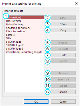

9.8. Imprint data settings
  1. Imprint data list
    • Maker data
    • User data
  2. Edit
    Edit selected data.
  3. Create new
    Create new data.
  4. Copy
  5. To upper
  6. To lower
  7. Hide / Show
  8. Delete
    Delete selected data.
  9. Rename
  10. Export all
  11. Export
  12. Import

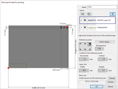

9.8.1.1. Layer settings
  1. Add layer
  2. Copy layer
    Copy selected layer.
  3. Delete layer
    Delete selected layer.
  4. List of layers

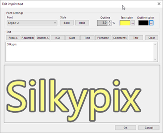

9.8.1.2. Character settings
  1. Standard point
  3. Size
    Set character size.
    When composition mode “Automatic size adjustment”, if the standard size of imprint data is changed to match the size of the image, the height will change at the same ratio.
    If “Composite by the fixed-size” or “Composite relative to paper” is being used in the composition mode, imprinting will be performed at the set size.
  4. Setting details

9.8.1.3. Image settings
  1. Standard point
  3. Size
  4. Selecting image
    Read an image.
9.8.1.4. Base size
  1. Base size
    Set this standard size.
    The composition mode for imprint data when printing and developing can be designated, but if “Composite by the fixed-size” or “Composite relative to paper” is being used in the composition mode, imprinting will be performed at the set size.
    When composition mode “Automatic size adjustment”, the ratio of image and character size will remain the same as the base size and the size will change to fit the paper and output size.
  2. Preview

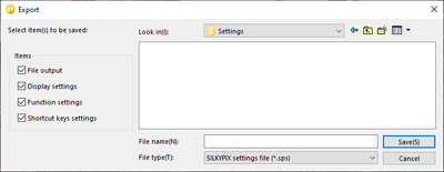

9.9.1. Export
  1. Save file
  2. Settings to be exported
* When you import a setting file exported from SILKYPIX Developer Studio Pro12 in a previous version, some settings are lost in a previous version.

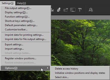

9.10. Options
9.10.1. Delete access history
9.10.2. Initialize window positions and display states

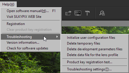

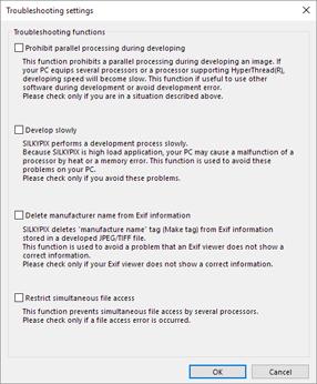

9.11. Troubleshooting settings
9.11.1. Initialize user configuration files

9.11.3. Product key registration test
If it is determined that you cannot perform online registration of your product key, enter your “Serial number” and “Product key” in the “Product key registration” dialog and click the link “If your PC is not connected to the Internet, click here after entering” to register offline.
9.11.4. Troubleshooting settings
9.11.4.1. Prohibit parallel processing during developing
Furthermore, if you want to specify more enhanced setting for limiting temperature rise, refer to ‘9.11.4.2. Develop slowly’.
      SILKYPIX Developer Studio Pro12 runs a CPU with high efficiency. Because of this, we say that a temperature of CPU gets higher than a case of running other software.
9.11.4.3. Delete manufacturer name from Exif information
9.11.4.4. Restrict simultaneous file access
