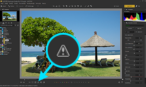

6.1. Display warning
This software has warning functions to support parameter adjustment.
When you click the
button on the bottom toolbar, you can enable each warning.
In addition, if there is a check at [View (V)]-[Display warning]-[Flash warning] in the menu, warning displays will flash on the image in the preview display.
If there is no check the warning display is always displayed.
(Soft proofing is always displayed.)
Highlight warning
The portion where highlight or color is saturated blinks.
The portion where highlight is saturated blinks in black, and the portion where color is saturated blinks in negative color.
This function is convenient for adjusting “exposure bias” and for adjusting “saturation” of color.
Shadow warning
Highlight/Shadow warning
You can customize these warning levels. Please refer to ‘9.3.1.4. Threshold of highlight warning’ and ‘9.3.1.5. Threshold of shadow warning’.Out of color gamut warning
This feature gives a warning for the portion where the color is outside of the color gamut. It means that the saturation in this portion is to high.
Please refer to ‘10.1.6. Color Gamut and Adjustment Outside of Color Gamut’.
Soft proofing
In this display mode you can check the colors processed and changed for color conversion with the color profile.
When printing on a printer, this considers the characteristics of the print paper and ink and performs color management processing for reproducing colors as faithfully as possible. However, there are limitations to the range of colors that can be faithfully reproduced and colors outside that range and on borders cannot be correctly reproduced.
In addition, there seems to be slight changes in the range of colors that can be reproduced depending on the applicable color profile.
Please use this to check the influence on color management processing on your monitor.
In this display mode, the display effects change depending on the corresponding print color space and matching methods.
However, you cannot check the influence of paper color because this is a simulation of color conversion processing by color profile.
When this warning is selected, the color management sub-control is displayed.
In the color management sub-control, you can set the color management for printing with possible settings in “Color management” in the “Print” section.
Please see “8.5.4. Color management” for details.
Focus peaking
Focus peaking detects portions that meet the focus from adjacent pixels, and displays attached inverted colors (negatives) to that part.
Depending on the photograph, such if it is difficult to distinguish between subject and background, or with single colored subjects, this may not be correctly detected.
Use this function as a standard to confirm if the focus of the photograph matches what you shot.
Please see “9.3.1.6. Set Focus Peaking” concerning changes to areas being detected.

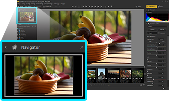

6.3. Navigator
The “Navigator” is a guide display for places displayed on the preview screen for the dedicated thumbnail.
You can change the position of the display by dragging the guide on the “Navigator” in tool modes other than Fitted display, such as Zoom tool, Loupe tool or Palm tool.
In addition, you can expand or shrink the preview with mouse wheel operations on the “Navigator”.
The Navigator is not displayed when in thumbnail mode because this is effective only when in the preview window is displayed.
