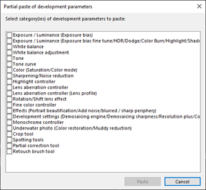

7.1.2. Partial paste of development parameters
Use when pasting partial development parameters and parameters that are not development parameters (crop tool, spotting tools, Retouch brush tool, Partial correction tool, and the Auto area specification tool of the White balance, as well as the Lens profile of Lens aberration controller) that are recorded in the paste buffer.
The menu command [Parameters (P)]-[Partial paste of development parameters] displays the “Partial paste of development parameters” dialog. Clicking [Paste] button pastes the selected part of the parameters to the target images.

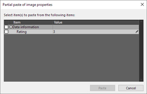

7.1.3. Partial paste of image properties
Use this when copying the editing contents of “Image properties” to other images.
Information from an image with no edited “Image properties” cannot be copied to other images.
The “Partial paste of image properties” function is turned off when “Image properties” edited contents are not recorded in the paste buffer.
First, copy development parameters and image properties into the paste buffer from “7.1. Copy development parameters”.
Next, display the “Partial paste of image properties” dialog with [Parameters (P)]-[Partial paste of image properties] from the menu.
Edit items in “Image properties” will be displayed in the “Partial paste of image properties” dialog.
Check the items from “Image properties” for pasting and click the “Start” button.
* Please note that if you paste “DateTime” of photograph taken, the edited contents for “DateTime” will be a different date and time.
Please refer to “4.21.6.2. DateTime” for details.

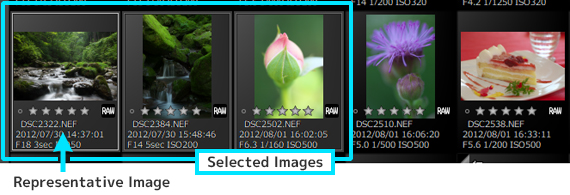

7.7. Operations for Multiple Selected Images
When multiple images are selected, the parameters of all images can be edited as a batch.
There is an image called the “Representative Image” when multiple images are selected.
The image of the “Representative Image” is displayed in preview and the selection display in the thumbnail window is brighter than other images.
As for “Copy development parameters”, “Save development parameters”, “Copy development parameters to Storerooms” and “Add taste”, development parameters for the “Representative Image” are applied.
